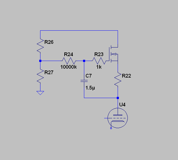

A schematic would be helpful.
Try this plate load out!
Use R26 & R27 to set the plate voltage; select R22 so that it drops about 10V. MOSFET can be for example IRF820. Take the output from the MOSFET source.
Use a LED on the cathode. Make sure the LED has a healthy current thru it, or else bass will suffer. 15mA should do, 20mA at least.
This gyrator plate load with LED bias will give very clear and powerful bass performance.

About Gyrator what's opinion do you have, CCS or Gyrator, I had problems with CCS because the DN2540 need to replace two or three times.

I prefer the gyrator. For one, it doesn't drift, and it allows to adjust the plate voltage very easily. As per sound quality; you'll have to try for yourself. I prefer the gyrator.

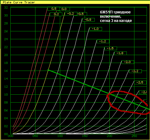

If you have a resistor plate load, make absolutely sure that the load line never goes under 10mA.
If the LED doesn't have AT LEAST 10mA of current thru it, it will not have a constant voltage. This will affect sound, esp. bass.

I drew up your loadline (6j51p curves from Klausmobile, great site).
If you have a non-horizontal load line, it doesn't matter if at the quiescent point you have 10mA or more current, it matters that the whole of the load line is above 10mA, or at least most, or the useable portion.
As you can see, your load line has pretty much the entirety of the right side from the quiescent point very much below 10mA.
If a LED has insufficient bias current, it will not have a constant voltage across it.
Either
1) operate the tube with a (near) horizontal load line, using a gyrator or a CCS,
2) supply the LED bias current via a separate resistor from B+, so that the LED is biased at all points of the load line independently from the tube
I would suggest using a gyrator, and setting the plate voltage such that the tube operates at around 12, maybe 15 mA current.
