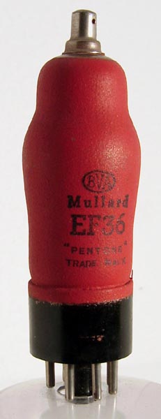

What about EF36/EF37/EF37A?
Octal predecessor to the minature EF86.
IMO, the red paint coated coke bottle shaped version is sexy.
Need a top cap and is a octal valve.
Raymond
Raymond
