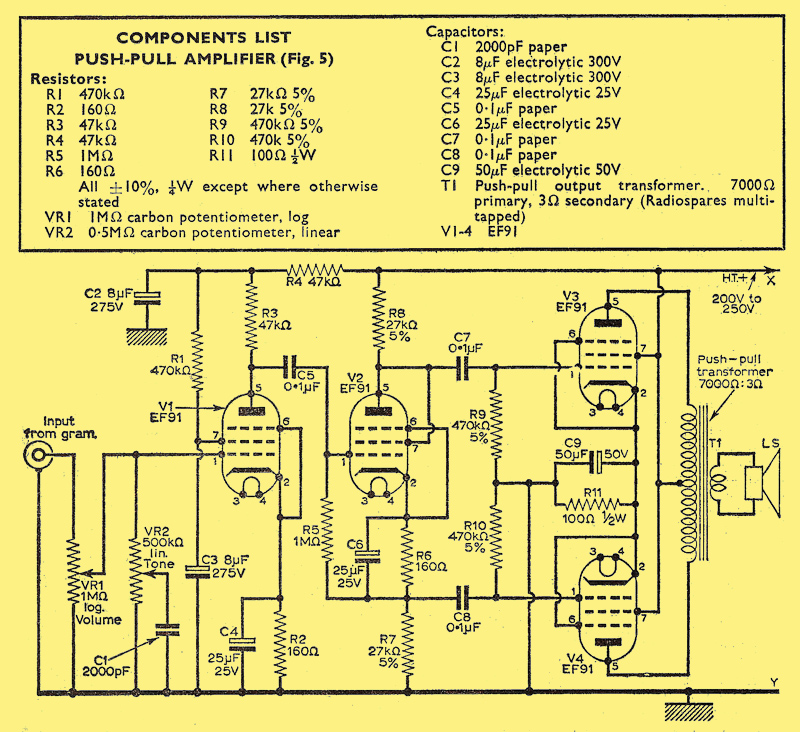

Hi, I know I'm replying to a very old post but I came here from the search of "EF91 Audio" and ... I have a good lot of EF91 (and equivalents) looking for a good project. On other search, I've found this: An EF91 Audio Amplifier
Please, make some comments, suggestions, critics...
I think it is pretty linear triode wired and high mu but I wouldn't use it to drive the grids of output valves without a follower in between. Probably ok for first stage of phono amp or a single stage mic amp with a follower output. Trying to use it as an output valve would be a waste of a transformer, in my opinion. Look at Morgan Jones's book for CCS use.

I found that power amp schematic you posted puzzling. I thought letting g2 get positive of the plate is a complete no-no, leading to runaway IIRC, but in that schematic g2 would be slightly positive of the plate a fraction of the time since g2 gets full B+, but the plate gets B+ minus OPT losses.
Only on True Tetrodes. Nobody has used them since 1926.
Note that ALL pentode power output stages have Vp swung WAY low of Vg2 half the time. Is not a problem. This is why we have G3. (Or the equivalent side-rods in "beam" tubes.)
