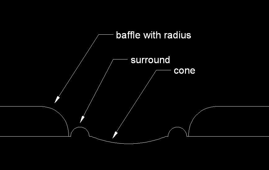

I'm wondering how the sound will be affected by mounting driver on the inside of a baffle with a radiused corner? I imagine it will get a slight waveguide effect but how much? Would there be enough change to have to redesign a existing crossover? Just speculating here.

I wonder if there is a noticeable difference between a chamfer and a radius?
Dunno but the chamfer removes more obstacle. I did a chamfer on my last take on rear-mounting, and it did need some additional smoothing of the edges to not interfere with imaging (at least, not as much as it was before I softened the edges of the chamfer by sanding).

I am going to redo my designs using the exact same approach - with a radius. There won't be much of a waveguide effect and with the radius there won't be much diffraction difference either. BUT, the driver is moving back - 3/4" in my case - and there will be a phase change in the far field, so I am anticipating a small crossover change to the woofer to compensate for this.
There will be a slight added acoustic mass at resonance, but for a closed box this is pretty benign. Ported, maybe not so.

An over-radius chamfering/rounding will have the best effect. By trial and error I've found a roughly 20% over-radius to yield the best result to limit diffraction effects.
However, the largest benefit of back-mounting a woofer is that you can have a "floating" outer cabinet that isn't mechanically coupled to the "inner" cabinet at any point, and thereby reducing vibrations in the front baffle and cabinet in general dramatically.

The waveguide results are pasted exactly 15db above the flush mount results. To compare them, look at the results of the flush mounted HDS at any given point in frequency and on any given axis location and add 15db (each line is 5db) and you can see how much boost the shallow waveguide provides. You can also see the direcivity changes the shallow waveguide provides. Also, in post 2, there is a link to experiments I posted over at HTGuide that used shallower waveguides, different roundovers and also some chamfers. The important thing to note, is that you can't simply mount the tweeter from behind and predict the results. I believe you really need to have measurement gear to be able to effectively use a rear mounted driver.
In addition, I mounted the woofer and midrange (open baffle dipole) in the design these wee done for from the rear, with 3/4" roundovers. On the woofer the rear mount made little difference in its passband (XO at 450z). In the open baffle midrange, however, the response was smoother in beneral than the flush mount measurement. Also, the flush mount had an off axis peaking above the dipole dip that was much more substantial than with the rear mount. Below is the speakers these were employed in:
