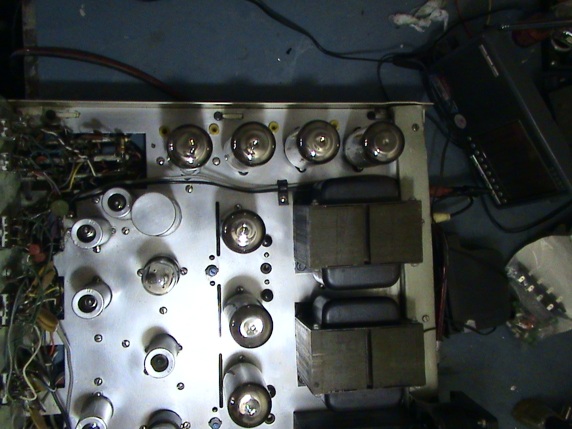

Hi guys. Sorry for my bad English I am Venezuelan ..... Here present my latest project, I call it "supermod Eico st-70." A brief review: I bought the Eico ST70 on eBay, after the restore, the sound I thought it was great! Then he performed "tronola mods", the sound improved considerably, but I wanted more power and then I was thinking "as having more power" and I got the crazy idea of putting 4 tubes per channel (PPP).

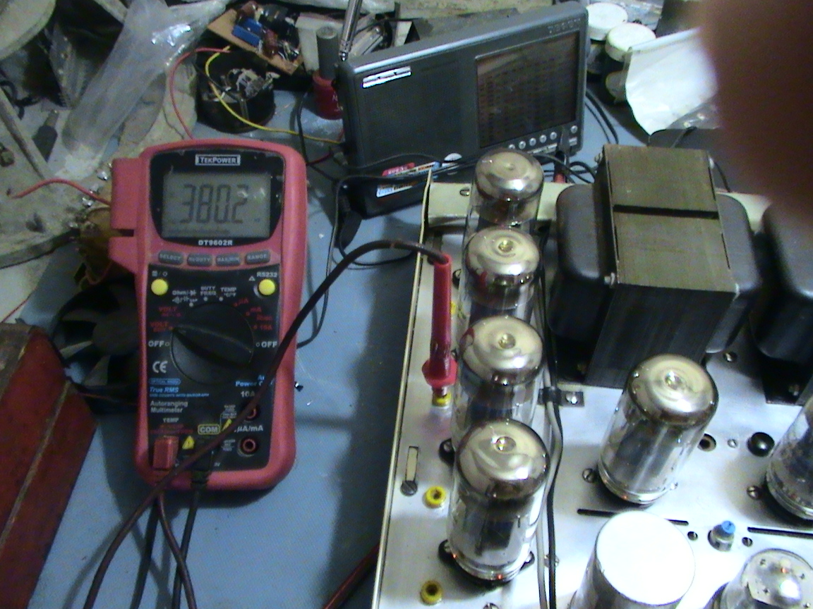

after making the "design on paper" and working on the amp, here are the results of the "supermodificacion" : Output power Apply 1kHz, to a FM1 input and set the Selector to it. Measure the output across the load 8Ω. 22.6Vrms ± 64WPC GREAT SOUND!!!!!!! THE BASS AND TREBLE SOUNDS INCREDIBLE! Eico ST-70? I put two GZ34 and a transformer for the filament of the four new 7195 I'm planning to use solid state rectifiers to increase the B + because it is now 400V

Well, you must remember that these are nominal values, these transformers supply much more than that. believe me that initially I connect the four 7195 to PT and work well " you can calculate the current filament with four additional 7195 ....." (everyone said it was impossible that I could not break the laws of physics), after I put an additional transformer for the filament, to avoid overheating of PT. also placed at the beginning a single GZ32 (see video) but had 390V B +, putting two GZ34 voltage is raised to 400, but yesterday probe using SS rectifier and voltage increases to 440V (surely the power output must be increased too) of course I have to use a delay circuit for the SS, I'm thinking about it

well, you must remember that these are nominal values these transformers supply much more than that. believe me that initially connect the four 7195 to PT and work well you can calculate the current filament with four additional 7195 .... . (everyone said it was impossible that I could not break the laws of physics ), after I put an additional transformer for the filament, to avoid overheating of PT. also at first I put a single GZ32 (see video) but B + had 390V with two GZ34 voltage is raised to 400, but yesterday probe using SS rectifiers and the voltage increases to 440V, {surely the power output must be increased too ) of course I have to use a delay circuit for SS, I'm thinking about it![]()

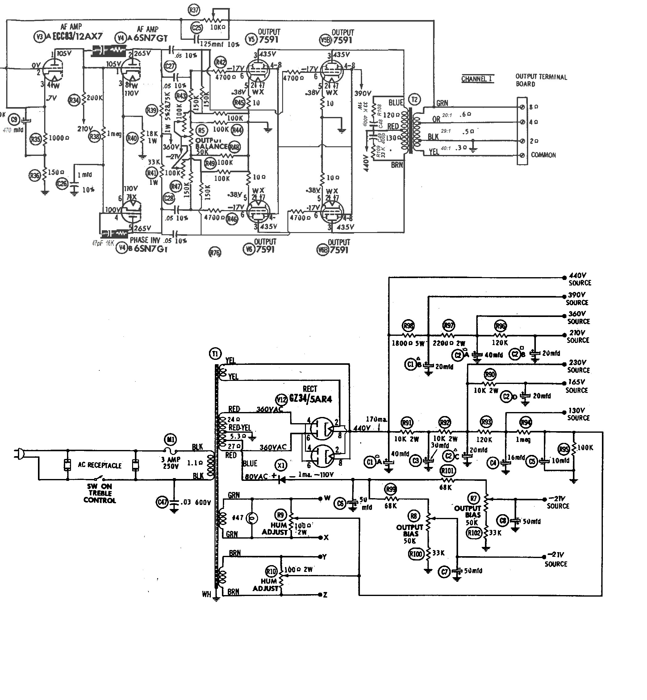

Attached is the Sam's sheet. From here, you can see the specs of the PT. The HT is only rated at 170ma, and 8 x 7951 at 38ma bias = 304ma which is almost 80% above the specs!!

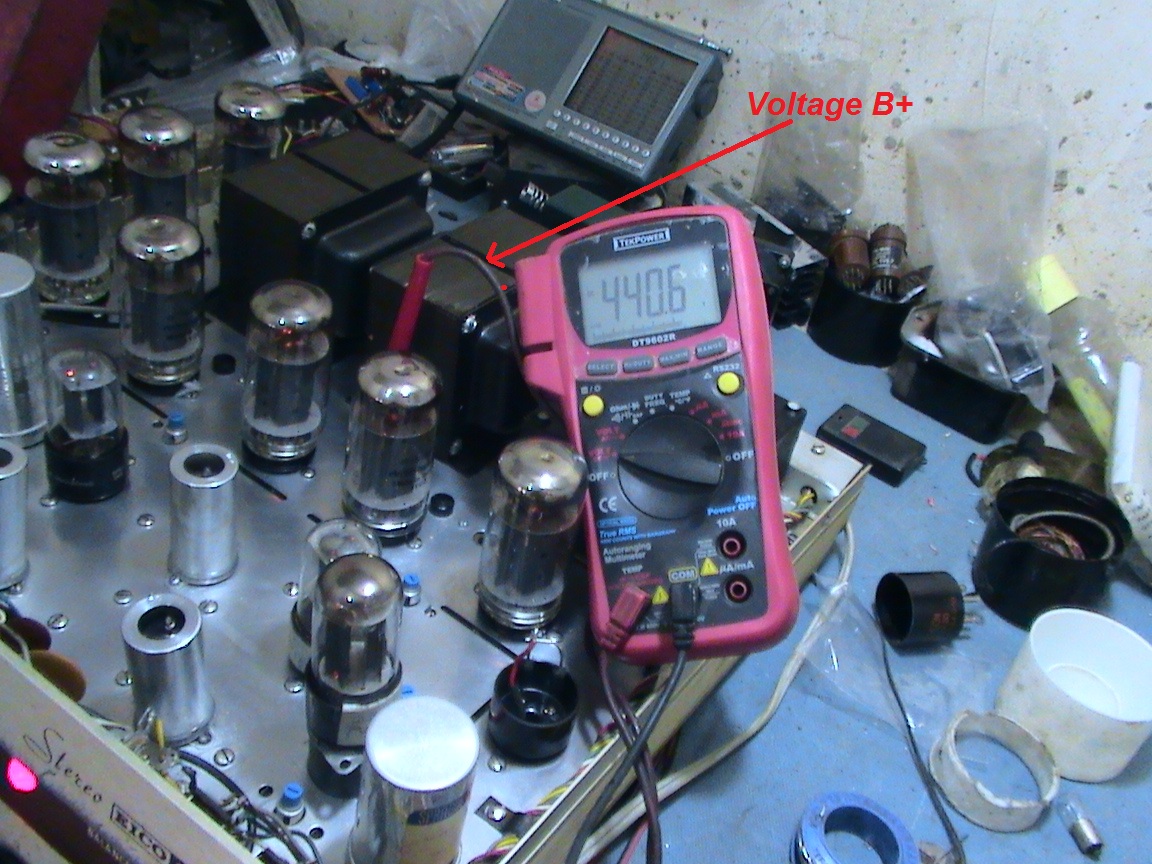

I do not know how they(Sam) obtained the data from PT, I just want you to see the picture with the value of B +.Do you think that this value of B + can be had with 80 % about the specs?
Andres
There seems to be some disconnection here. I said 80% above the specs, not about the specs. I did assume each 7591 was drawing 38ma per Eico instructions. 38ma x 8 = 304ma total when idling. The PT specs is 170ma. Therefore, you are drawing 134ma (304 - 170) above the PT's specs which is approximately 80% of 170ma. This may present potential hazard as the magnetic wire might not be spec for such level of current either.
If you read the Sams from my attachment (you can download all 6 pages via the Eico group files section) on the specs of the OT, you will see the primary impedance is 6500 which is somewhat high for PPP of 4x7591 as well.

Sorry my english is bad, i want say "above" not "about". well I checked the amp for several days using it for several hours and so far has not had any problems. I am clear that the PT is over the limit, however now I have a bigger PT, I have not put because until now has not failed the original. On the other hand before of the mod I calculate the ratio of OPT, please if you see the attached schematic you will notice the taps of impedance values in the secondary of the OPT is different.........
