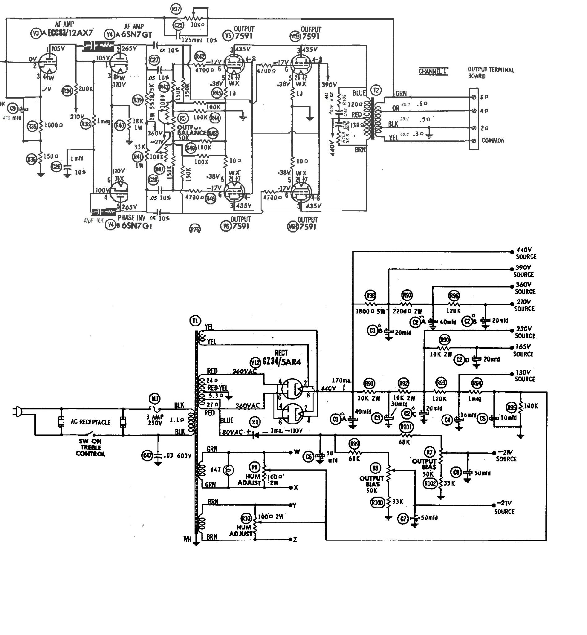

If I count right, you should have 4 wires left.
red - HV to rectifier socket
red-yellow - center tap to ground
blue - bias tap to diode cathode
If you have a short at the diode tap, that could be damaging to the HV winding.
Check the diode for normal pn junction behavior on your DVM if it is a silicon type.
If the diode is shorted, replace the diode and all 3 capacitors in the bias circuit.
If this is a selenium rectifier, the two lugs could short together and short out the diode.
If this is the problem, replace all 3 bias capacitors.
Note the schematic, at least the one that I have, has the +/- diode marking reversed.
You want a negative DC voltage from the diode output.

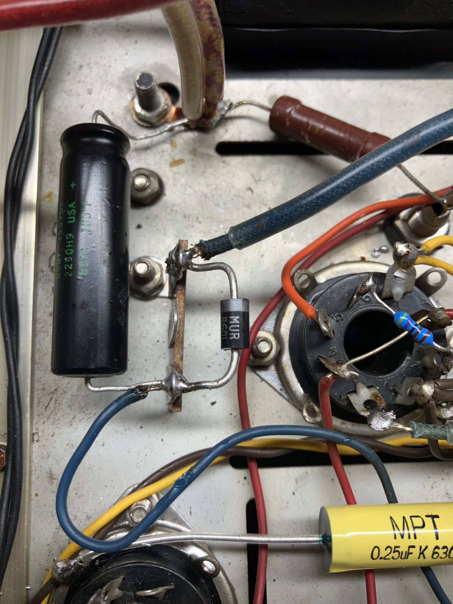

Schematic shows the cathode to the blue wire so i think I have it wired correctly, this was a new diode by the way. Also, the cap there, schematic shows + to the gnd where the red-yellow from transformer go, wired that correctly.
Let me disconnect that blue wire, see where it runs, maybe that is something?
Okay blue wire disconnected, still a short, must be bad cap (it was new too) or that diode, right I mean what else can it be, we pretty much narrowed it down.

WOW okay, you won't believe this....well I do not mind making myself look like an idiot, here is what I did, look close at that picture!!!! I am grounding the tap that the blue wire goes to!!!! Ugh, so sorry, let me reconnect and we can see!
I won't soon live this one down, sorry! But hey what a great lesson in chasing and troubleshooting!
