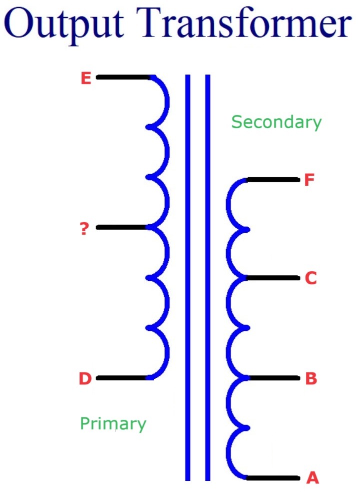

I have 2 output transformers from an ARTEC 225 amplifier (EL34 PP). The indication is 5000/30W and the EI-iron measures 92x78x64.
3 individual outputs (I call them A,B,C), a FB? (F) and a CT primary (D-E). I measured the impedance @ 1kHz:
An 8 ohm @ A gives 7 ohm @ B, 13.5 ohm @ C, 32k2 ohm @ D-E and 2k32 ohm @ F
An 8 @ B 4.2 ohm @ A, 12 ohm @ C, 24k5 ohm @ D-E 1k98 ohm @ F
An 8 @ C 2.65. @ A, 3.65 ohm @ B, 13k45 ohm @ D-E 1k24 ohm @ F
An 8 @ A-B in series , 7k64 ohm @ D-E 775ohm @ F
An 8. @ B-C , 4k79 ohm @ D-E 488 ohm @ F
An 8 @ A-C , 2k7 ohm @ D-E 280 ohm @ F
I would like to build an amp with ECC82 as phase shift and EF86 as input stage. I also have 2 power transformers each 100VA/ 700VCT 5V 6V3 an 2 GZ34's (=5AR4).

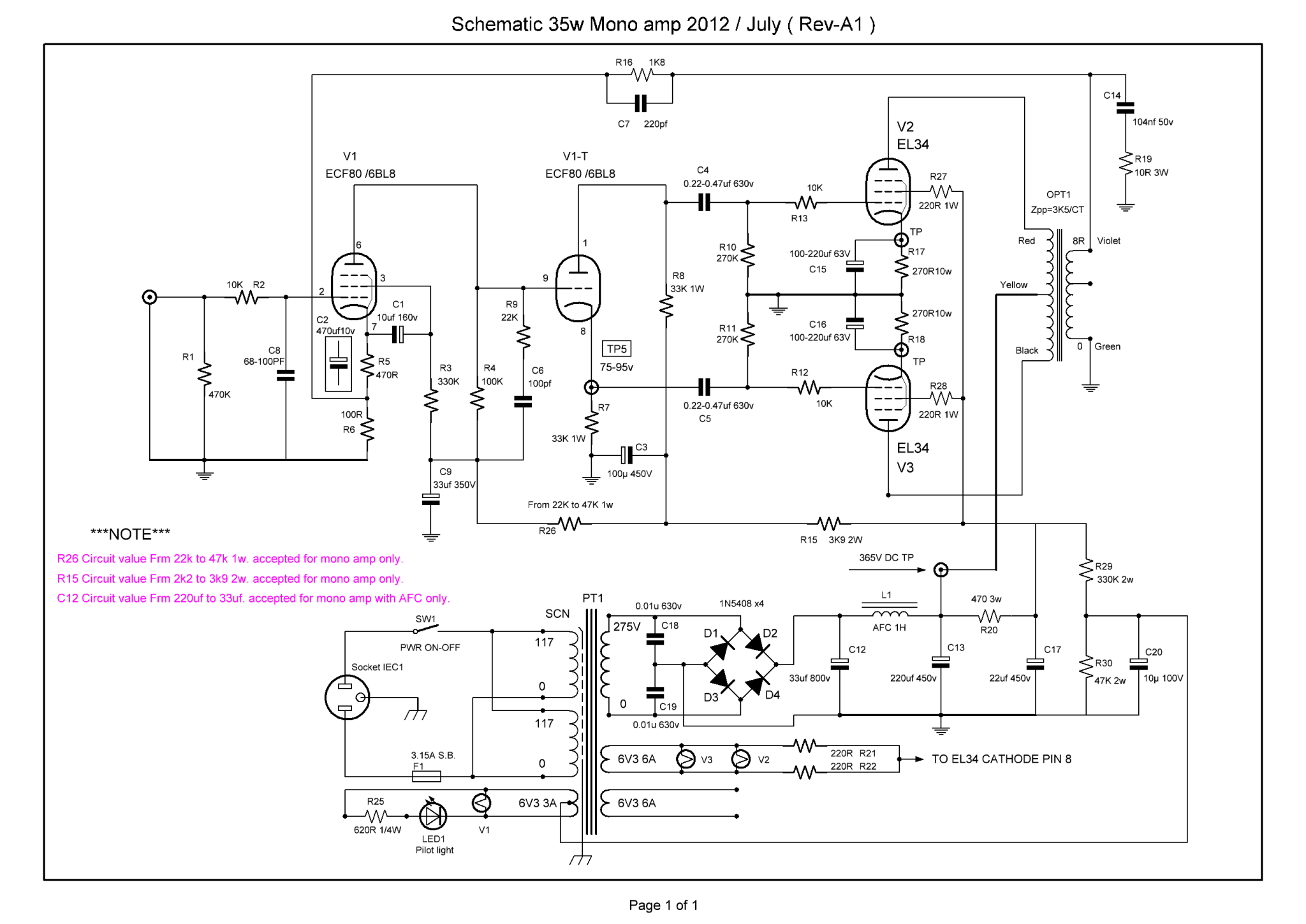

Have a look at this Audionote schematic. It might give you a place to start or some ideas. It uses a pentode/triode for gain and phase splitting. Search around on the forum, there are threads about this amp and some have wired the pentode as a triode. It's a SS B+ supply but you could convert it to tube rectification. A 100VA power transformer might not be powerful enough for a mono EL34 amp and 700 volt winding might not have enough B+ with a tube rectifier.
Cheers, S.

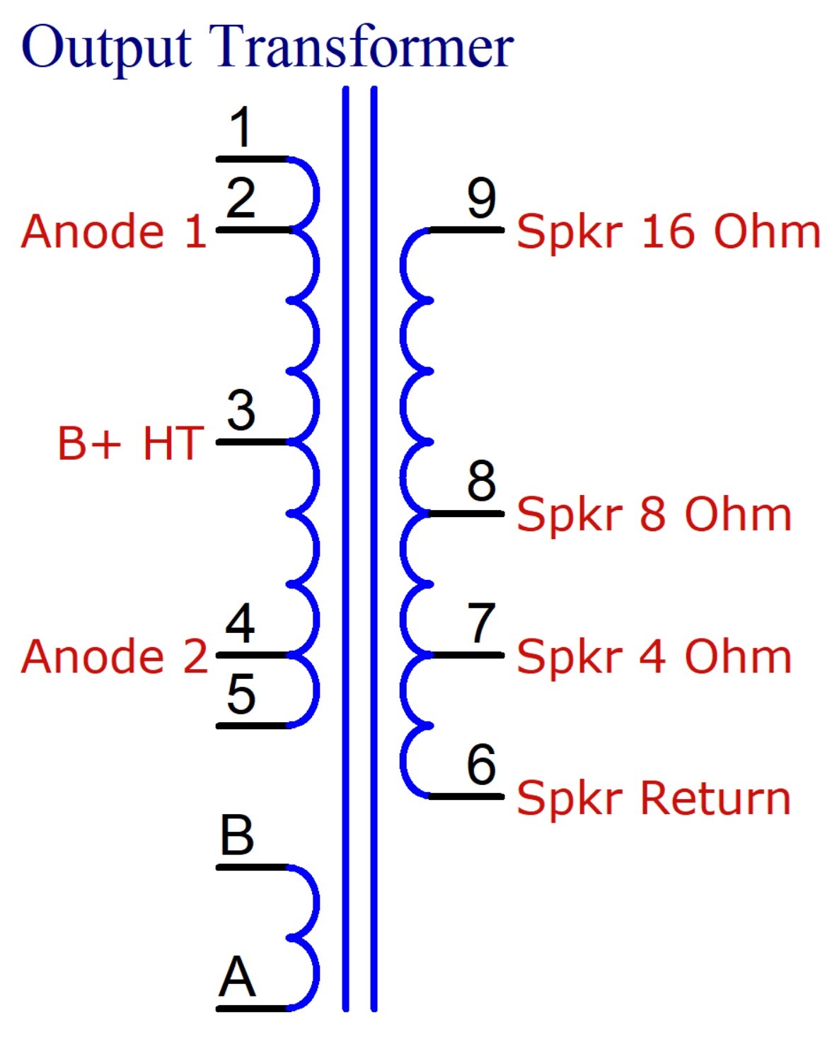

@6A3sUMMER
OK but I'm not criticising output transformers far from it, I understand that they are needed to step the high tube impedance down to the low speaker impedance and as I said the decoupling they give between the tube amplifier and the speakers/speaker wiring is great (safety, RF interference removal, fault tolerance etc).
But transformers are never 100% linear, try designing an output transformer that is linear from 20Hz to 20kHz. The phase shift, I mentioned it not because of its effect on the sound coming from the speaker but because of its effect in the feedback loop (as most tube amp circuits I see feed the output transformer secondary signal back to the input tube). Phase shift in feedback loops is unwanted and hard to quantify.
I would go as far as to say that the output transformer primary to secondary isolation/decoupling does a lot to explain why so many people find the sound from a tube amp better than the sound from a solid state amp.
If I was designing an output transformer "all over again" I would build in some of the following features:
So as you see we are on the same page.
- Make it a toroidal transformer with carefully chosen core material
- Keep the primary (centre tapped) winding and secondary winding simple, no extra primary taps or secondary taps (for different speaker impedances)
- Wind an extra winding (closely coupled to the primary) to give the needed feedback signal
- Keep the isolation between primary and secondary very good (as toroidal cores can do) for safety reasons

1) I like the AN schematic Steve M. mentioned. (Rev3.03 july 2019 has 2 tube rectifiers and 630VCT)
2) 6A3sUMMER and richgwilliams discussed the FB winding.
So the question is still : can I use the 775 ohm winding (or is it better) an output winding ( see #1) for FB. If so what value change will you recommend.
Thank you all for the brainstorm
To answer your question - I don't understand your measurements, your description does not define what the transformer is. I suggest you do the following tests/measurements to your transformer:
- With a DVM measure continuity between pins, a simple bleeper will do.
- Draw up a diagram of what you think the transformer is.

I did not see the connections of the transformer in question, until Post # 13.
I did not interpret and draw out the data that was given in post # 1.
It appears that Pins 1 and 5 normally connect to the plates (this is the highest primary impedance).
It also appears that Pins 2 and 4 are Ultra Linear taps (or else the transformer primary is sold as a Dual Primary impedance model).
But if those are 40% UL taps, then the impedance is 0.4 x 0.4 x the plate - plate impedance.
(example: I will use a 6k plate to plate rated primary. 6k p-p primary, would give 0.16 x 6k = 0.96k Ohms from UL - UL taps.
You want to know if the 775 Ohm winding can be used to give the negative feedback signal.
With a 7.64k primary, we have . . .
7,640 / 775 = 9.86 impedance ratio. The voltage ratio is Root (9.86) = 3.14. The 775 winding has 1/3.14, or about 1/3 of the plate to plate voltage.
First question: Can you use a negative feedback signal amplitude that is 1/3 of the plate to plate signal voltage, or will you have to attenuate it?
Second question: How good is the 775 winding coupled to Both the Push primary, and the Pull primary (is the leakage inductance low, and how equal is that leakage inductance to both the push and the pull primary halves)?
Third question, How equal is the 775 Ohm leakage reactance effect, versus the 4, 8, 16 Ohm leakage reactance effects . . . to the push and the pull primary halves?
Fourth question: do you really want to use global negative feedback?
From the 775 Ohm winding?

Yes pins 1 and 5 should be the Anode 1 and Anode 2 and pins 2 and 4 should be your UL1 and UL2.
Comparing measured winding resistance at 1kHz does not tell the turns ratio, in fact winding resistance can be very low in an over designed transformer.
My transformer drawing is fictional and in no way represents info from post #1. The transformer details have to be discovered in ways I have described (also Googling the type numbers might help).
The impedance is measured @ 1kHz with a very close to 8 ohm resistor as explained in #1.
The transformer has a primary as drawn so D-CT-E. 3 single separated output windings that you can combine to have the LS impedance you want.
The output winding combination to have around 7k5 (7k65) was the 8 ohm load at the second and third winding in series.
Then there is 1 single winding of around 775 ohm, so i bet it can only be used as FB (or a 600 ohm output ?).
Those high values such as 7K65 are probably just capacitive coupling between isolated windings, if you measured at DC they would probably be open circuit. If that single winding at 775 Ohm was intended as a feedback winding then the high impedance is probably because they wound it will very thin wire (no current to carry for feedback). Also yes it could be intended as a high impedance, public address horn speakers historically and currently can use a 100 Volt line system (maybe not 600 Ohm but high impedance) idea was to allow long cable runs between horn speakers.
The impedances you measured don't tell you definitively about the turns ratios because different thicknesses of wire are used for different windings.
As an easy test - try feeding your 1kHz sine wave across D to E and see what 1KHz voltages you get at the speaker windings and the line/feedback winding.
Seems that you know much more about what the transformer is.
