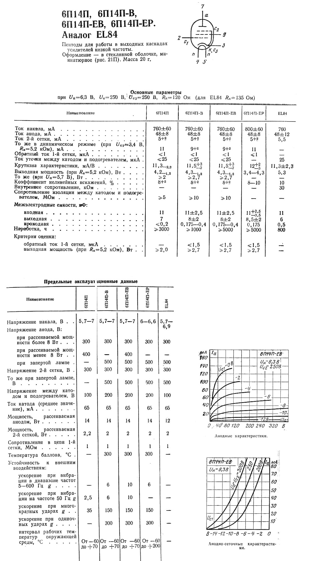

Someone have or know where i can find the datasheet
of the sovtek 84M, haven`t had any luck in my search.
The only words i can find, is this:

EL84M = Russian 6P14P-EV (6n14n-EB) so search for these
http://www.tubes.ru/techinfo/HiFiAudio/6p14pev.html

Gday.
TnX. argo.
Do you happen to know of a .pdf file.?

Not that I'm aware of. But I have found this gif file for 6P14P.http://klausmobile.narod.ru/td/data/_6p14p.GIF

One of the main differences between an EL84 & EL85M is that an EL84 has a maximum plate voltage of 300V, and the EL84M is 500V. Other differences include longer life and robustness to withstand military use.
That's incorrect.EL84 has a maximum plate voltage of 300V, and the EL84M is 500V.
6P14P and 6P14P-EV have the same maximum operating plate voltages (300V at 8W and above, 400V below 8W). For the 6P14P-EV/EL84M the maximum plate voltage of 500V is also specified for the "closed" tube (no plate current due to cold heaters or extreme negative bias voltage) to meet the -E requirement (lifespan of 5000+ hours). For the "plain" 6P14P it is not specified, but that doesn't mean it cannot withstand 500V - it's actually exactly the opposite: apply as much as you wish, just don't expect 5000 hours.
Soviet "long life" tubes always have more conservative ratings to meet the lifespan criteria.
