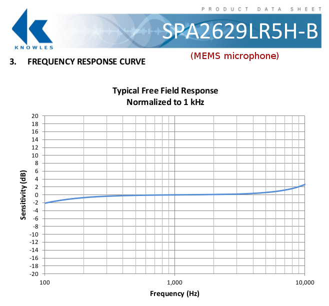

Thanks for the link! I checked out the first one in the list, and, sure enough, you can see both the problems I just described.Check out the Knowles products- Knowles :: Microphones
At the high frequency end of the graph (which is only 10 kHz), you can see the beginnings of a poorly controlled mechanical resonance (peak in the frequency response). The provided frequency response graph (attached) cuts off at 10 kHz, but the frequency response is already rising towards a peak somewhere beyond the right edge of the graph.
Note also that, at the bass end, this mic is already 2 dB down at 100 Hz. Deeper bass will be rolled off even more.
Of course 100 Hz to 10 kHz is more than adequate for transmitting reasonably good quality speech, so this MEMS mic is certainly good enough for a 'phone. But it isn't as good as the better electret microphones used to be.

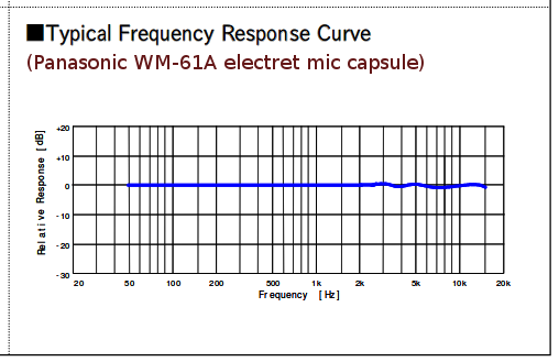

For reference, I'm also attaching a screenshot of the frequency response curve Panasonic provided in their old WM-61A electret microphone datasheet.
The old-technology WM-61A electret mic frequency response extends out beyond 15 kHz at the high frequency end, with extremely minor wiggles. At the bass end, it's ruler-flat down to 50 Hz, where the graph ends; clearly, the actual microphone frequency response goes well below 50 Hz, because there is no bass roll-off at all at 50 Hz.
For recording passable-quality speech, either microphone would be adequate. But the old Panasonic electret is actually good enough for high-quality music recording, and for use as a poor-mans measurement microphone. Amazing, for a $2 device!
