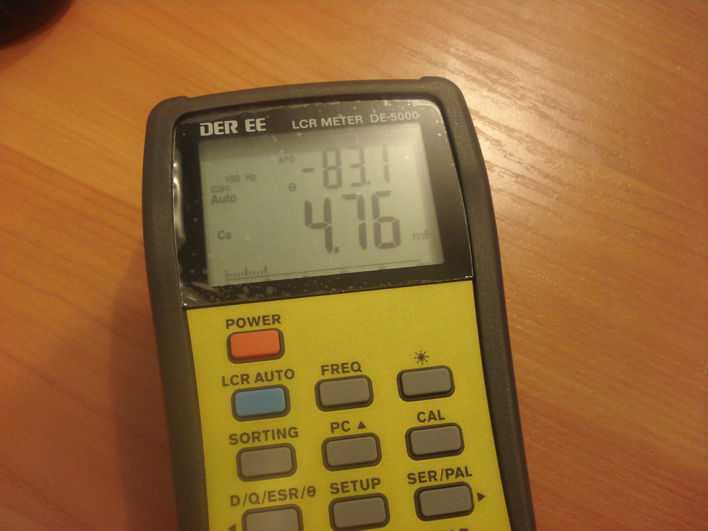

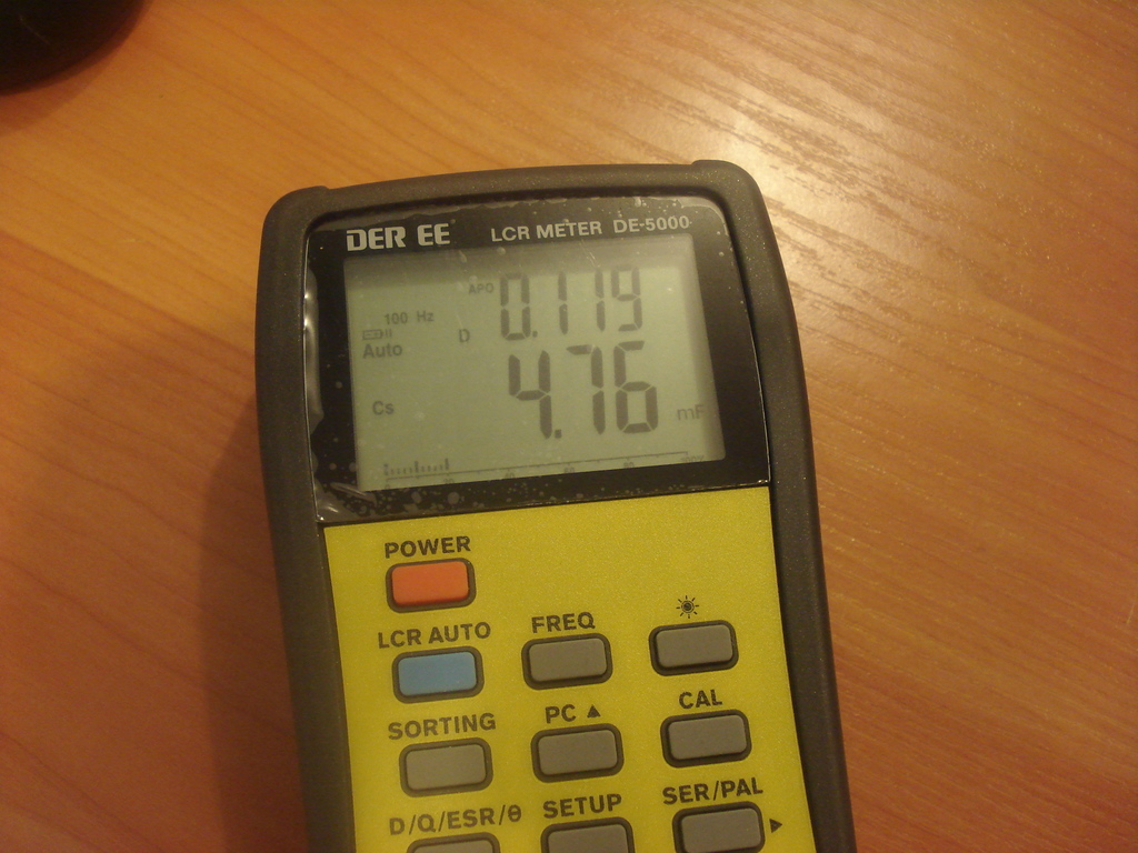

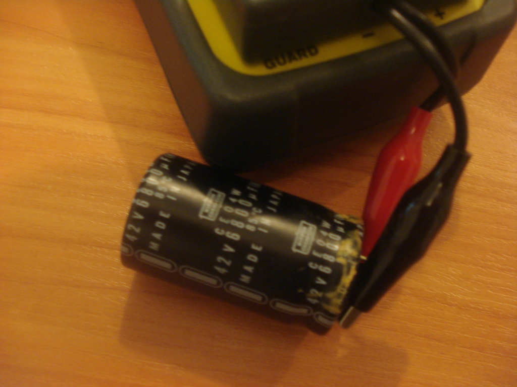

My vote for DER EE-5000 too. I think it's a bargain for its price. I bought it after reading the Pedro's review in eevblog. I'm attaching here some pictures of measurement the old electrolytic cap (6800 uF/42V).

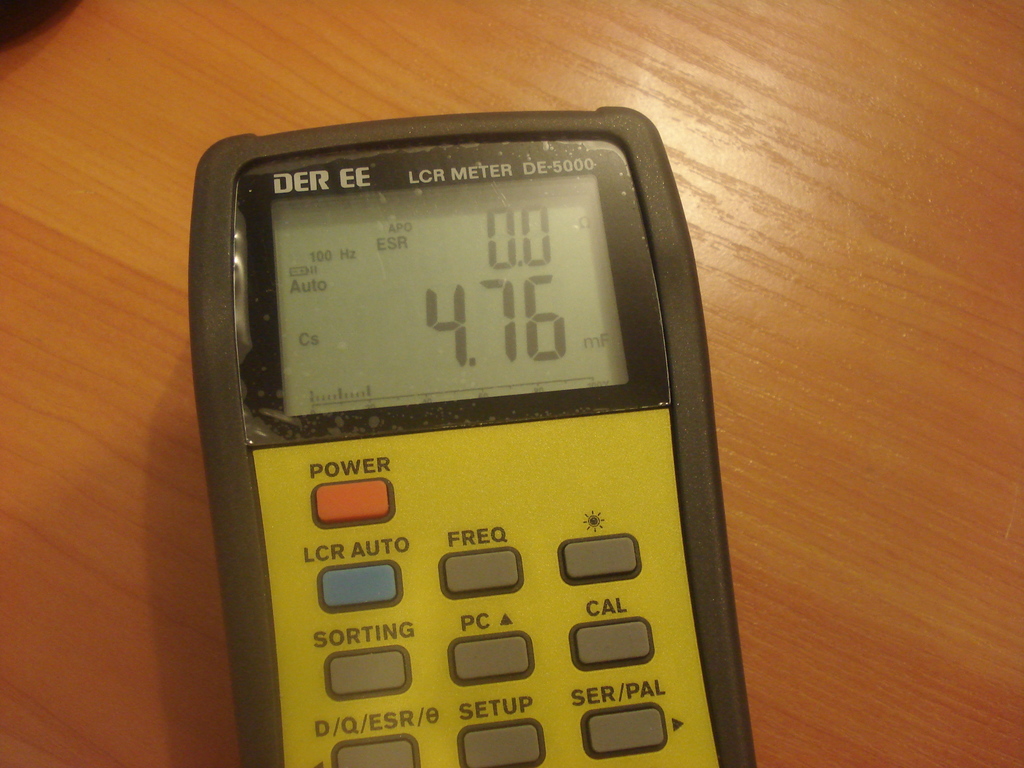

And here you can see all possible capacitor's parameters measured by the meter.
Well, you can see that in Cs mode and 100 Hz measuring frequency the measured ESR has meaningless value 0.0 probably due to the limited depth on 100 Hz.

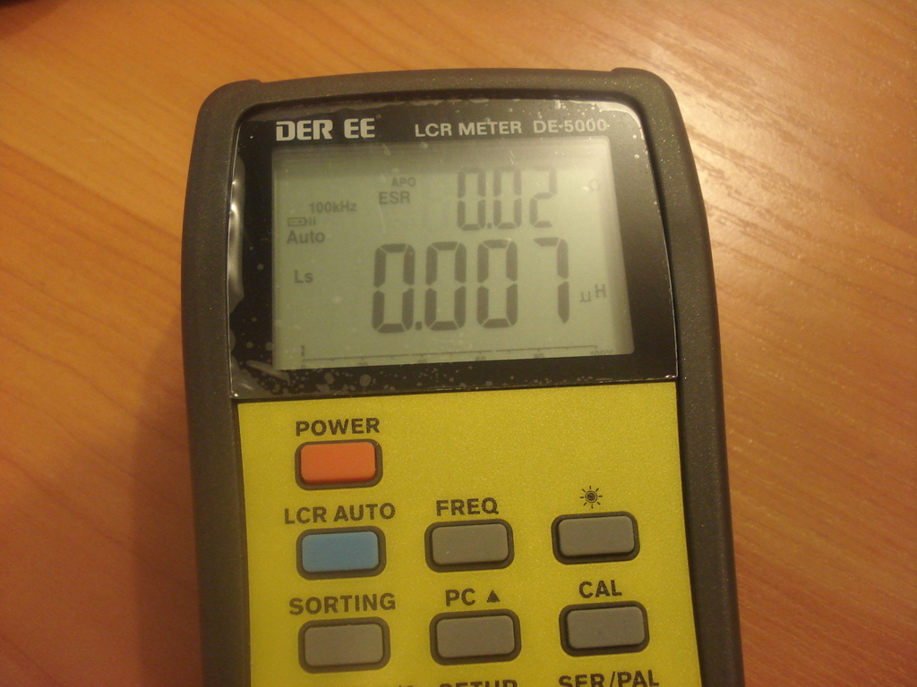

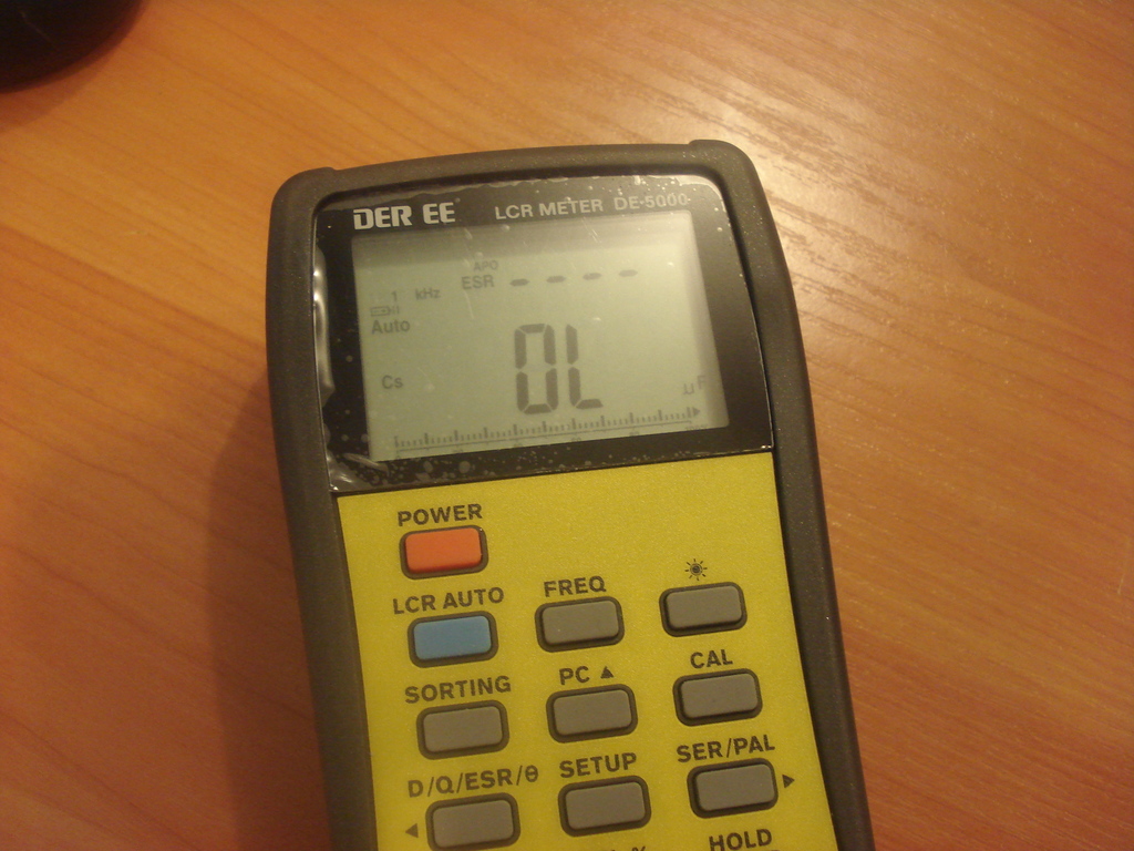

If you try to increase the frequency and hence to raise the accuracy result is:
Initially I was disappointed by that but soon I think I found a solution to measure the ESR of big elcos - one possible solution is to change the mode to Ls:
I'm not very sure if this is the proper mode for capacitors measurement but the results for ESR are consistent with the other mode one can use to measure ESR - Rs mode:
I'm interested if my observations are right.
And once again - I think it's the best unit for its price!

Thank you, that's exactly the sort of information I wanted, and pictures suit my bandwidth better than YouTube video.
The results all look quite reasonable except one that I am not sure.
I need to think about that low frequency measurement of the inductance of the capacitor, to understand why it is inconsistent.

Now that I think about it, that ESR is an anomaly.
If the unit can measure the impedance of the capacitor and the Q then it should be able to calculate the ESR.
Capacitance 4.76 uF at 100 Hz = .3 ohms
Divide by Q of 8.37 = ESR of 0.036 (approximately)
Which seems about correct, based on the other results.
(There's a small inconsistency between Q and D, presumably round-off)
So it has sufficient resolution of the Q or D or Theta to show milliohm variations in ESR, but doesn't. Hmm.
