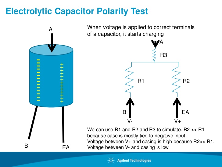

Therefore I want an easy measurement methody for checking the really right polarity.

Apply a little current. Monitor the voltage. If it rises smoothly past a few volts then the polarity is correct. If it gets stuck at a low voltage then polarity is wrong, so reverse it and try again but then be aware that you may need to re-form the cap as the test may have slightly damaged the oxide layer.

If they really are unmarked polarised (extremely unlikely) then a possibly destructive method of testing for polarity is to gradually apply a current limited voltage (e.g slowly up to ~25% of rated voltage, limited to ~10mA) in both directions across the cap whilst measuring current - if polarised and the wrong way round you should start to see a steadily rising current flow. Can be done with a bench power supply, and put a shield of some sort over the cap just in case it decides to detonate ;-)
I tested with the bench supply, above ~7V across reverse polarity with a 100uF/35V aluminium electrolytic, the leakage current rises above 1mA (measured using bench display) and quickly starts to accelerate upwards.
I also just tested this with a multimeter in series with the bench supply (more sensitive than the bench supply measure) measuring current across the same capacitor:
Using 5V with correct polarity produced ~1uA leakage.
With 5V and reverse polarity the leakage started at around 25uA and gradually got higher, after around 30 seconds it was at 50uA.
Even at 3V it was reasonably obvious which way round it was - the reverse leakage was at least twice that of the correct polarity.
