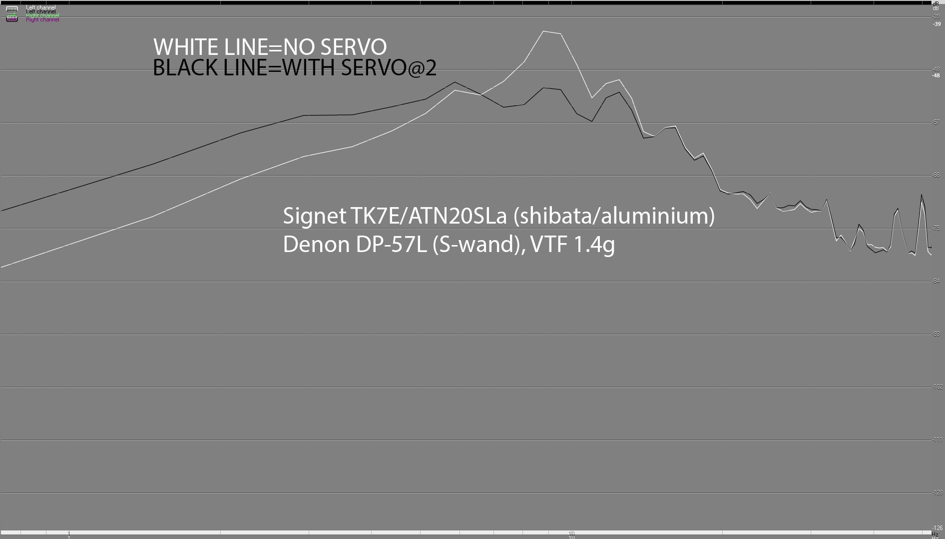

Well, Denon had their Dynamic Servo Tracer which works as intended, looking at measurements. Audibly I haven't tried comparing directly yet, so I don't know. This tt sound great without DST, so there's nothing obvious jumping at you when turning it on. I will study it further, for sure. Here's a measurement 🙂. As you can see, it knocks down the ca 9hz peak considerably.
Signal source is 250hz-30khz pink noise, Denon Dp-57L S-wand with Signet TK7E and AT20SLa shibata stylus, via heavily modified Simaudio Moon 110LP mk2 phono stage.

And where/who provided that graph?Here's a measurement 🙂. As you can see, it knocks down the ca 9hz peak considerably.

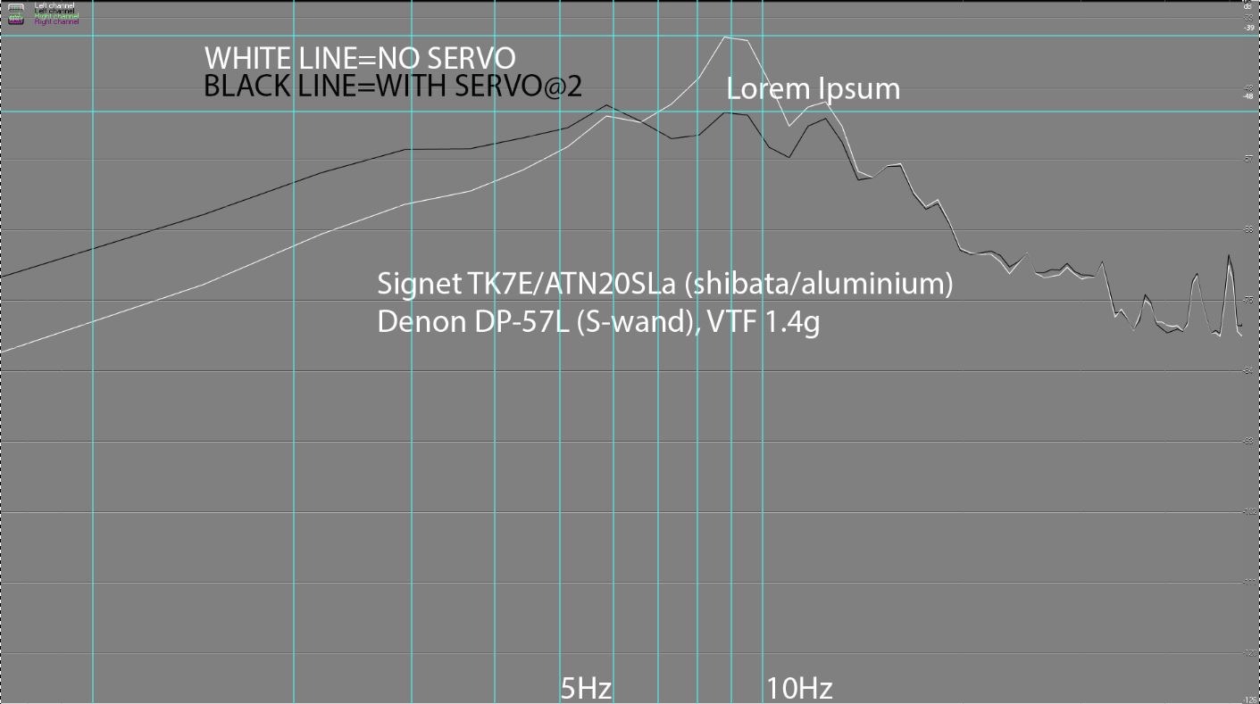

Sorry, I'm too lazy Photoshopping. FFTs were made using RightMark Audio Analyzer @0,73Hz resolution.Nice chart - what is the scale on the horizontal axis?
I have a few other turntables from the era; Technics, Kenwood, Thorens, Dual, Heybrook and the Denon is maybe the best 🙂. The DP-57L (same as 62L) is my current "SME-headshell connection" tt, and replaced a very nice Technics SL-150 with SME 3009 S2I/FD200 tonearm.
Thanks - a tonearm that does exactly what it says on the tin, complementing a powerful motor with excellent speed control. I agree with rockies914 - the tonearm is very good at playing warped LPs, taking a couple of revolutions to settle into excellent tracking, providing the warp is not so big as to bottom the body of the cart on the vinyl!!

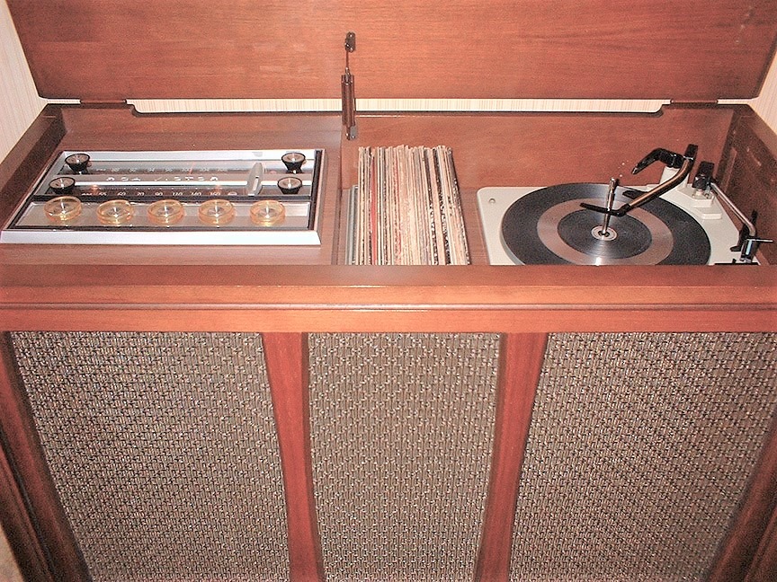

One of my turntables, obviously shunned upon by the "purist audiophiles", is installed into a stereo console, whuch I've completely overhauled and modified to my liking.
Oversized 12 inch woofers, a relatively powerful PP 7189A tube amp chassis, internal bracing of the cabinet panels, etc..
Initially, whenever turned up to a loud volume, I got nasty feedback from playing records.
Even isolating the turntable's underside from speaker vibrations, and modifying the turntable's suspension, I got that "howl" if cranked up.
The turntable, is a shunned by many model 3000 Garrard - record changer, with its Pickering magnetic cartridge, completely overhauled.
My final resolution to ceasing and ending the howling feedback problem? - using a relatively simple design of a Sallen-Key filter, offered by Rob Elliott on his website (project #99).
The turntable now performs as if it's seperate from the console - absolutely no issues, not even any detracting sonic effects. - and no rumble, either!
And that same filter system can be used in any amplifier/preamp to quell issues the same way.
I've implimented in several systems with no ill effects, just the absolute absence of feedback/tracking issues.
And.... no loss of that all-important deep bass sound that attracts people like a drug.
In fact, if I turn the bass control fully up and crank the volume, I get perfect playback.
Only the glass doors of the nearby china cabinet start to rattle, and those will be tended to in the future.

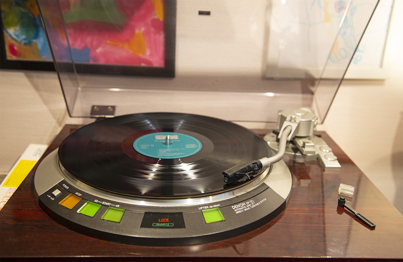

To add something about the Denon DP-57L since the tonearm is stuck on a plinth and drive. It has a very high torque motor, spinning up very fast and even maintaining speed while cleaning! The spindle bearing is extremely good, a spindown from 45rpm while sampling pink noise took more than 2 minutes, exceptional. Two different armwands and multiple counterweight sizes makes it very flexible regarding compliance and cartridge weights. It allows for some height adjustment of the tonearm, also a nice feature for flexibility.
The UFO drive and buttons is maybe an aquired taste, but I like it 😀. Here with Audio Technica AT25 from 1978, just arrived from Japan via USA.
