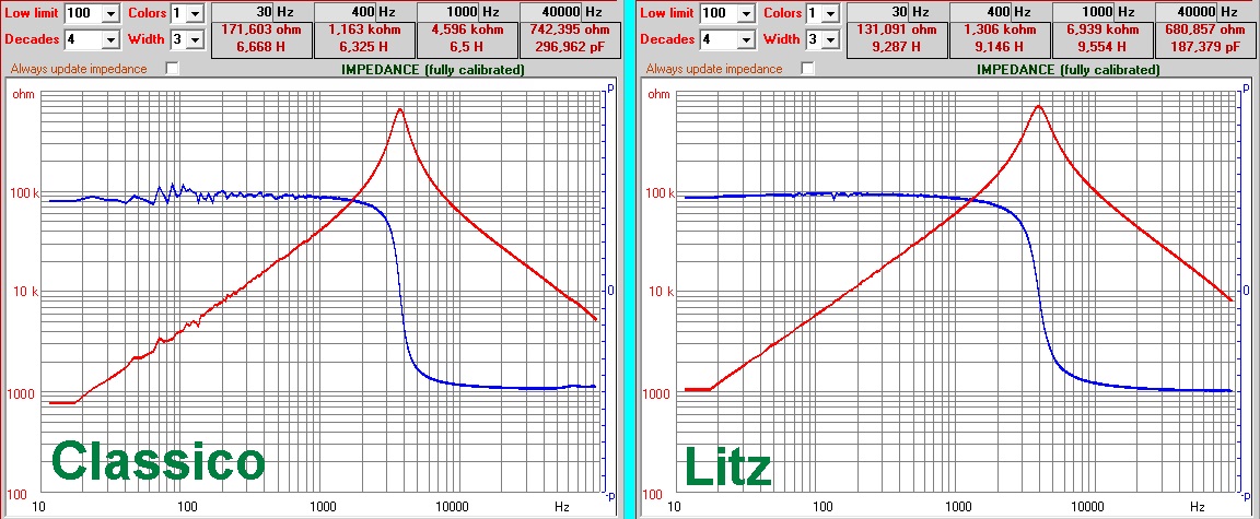

In attach the figure already sent in another thread where is show the characteristic of the primary of two trafo when the load is not connected.
After the resonace the andament is capacitive but it doesn't means that the L disappaer!!!!!
Then there is a picture from Radiotron with a scheme of the equivalent trafo at high frequency; I hope this is clear for everyone

I am testing another two proto and I am waiting two bigger ones, same Z.
The second picture is a simplified scheme of the trafo at high frequency but it show clearly the two major issue on this stuff
