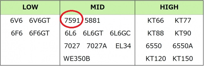

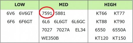

IT SHOULD BE 7581 (NOT 7591)

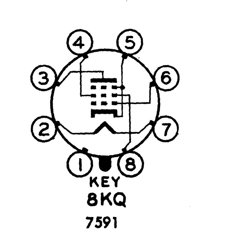

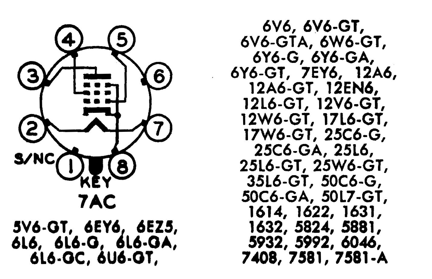

With all due respect
to you and especially Mr. Fujita, the 7591 has a different pin-out than almost all other power tubes. Plugging a 7591 into an amp that's stet up for 6V6, 6L6, EL34 etc. could do damage. See the attached basing diagrams.

Hi Victor,
I believe Steve is correct about the pin compatibility. According to [1], pin 5 on 7591 is k,g3 and according to [2], pin 5 on KT-88 is g1. I don't know if 7581 [3] was intended, but does seem to be pin compatible.
