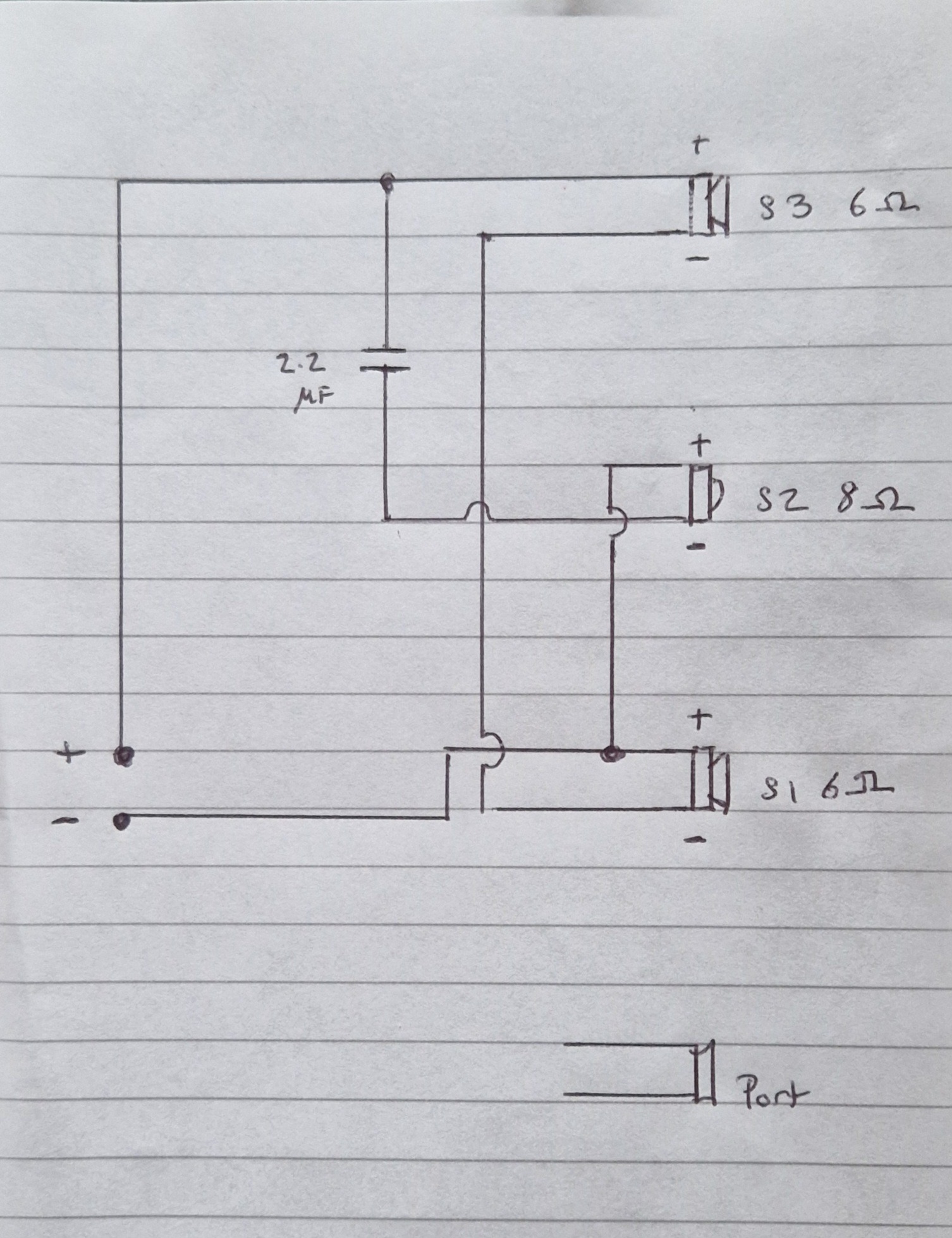

3. Having pulled the drivers out to inspect, the exiting blown tweeters don't have + or - on the terminals - does it matter which way they are connected (other than potential phase issues - although led to believe this would be nominal for tweeters)
Below is a wiring diagram I've put together (apologies for my poor drawing skills - hope it makes some kind of sense!) - hopefully that will help make some sense of the config / wiring.
S1 & S3 = Woofers
S2 =Tweeter
If any other info would be useful then please let me know - newb to speaker electronics / wiring here 🙂

The woofers are in series. Try moving the cones with your hand to feel for resistance. Measure the coil resistance of each.
Either way will function. One way will likely sound better.does it matter which way they are connected (other than potential phase issues - although led to believe this would be nominal for tweeters)

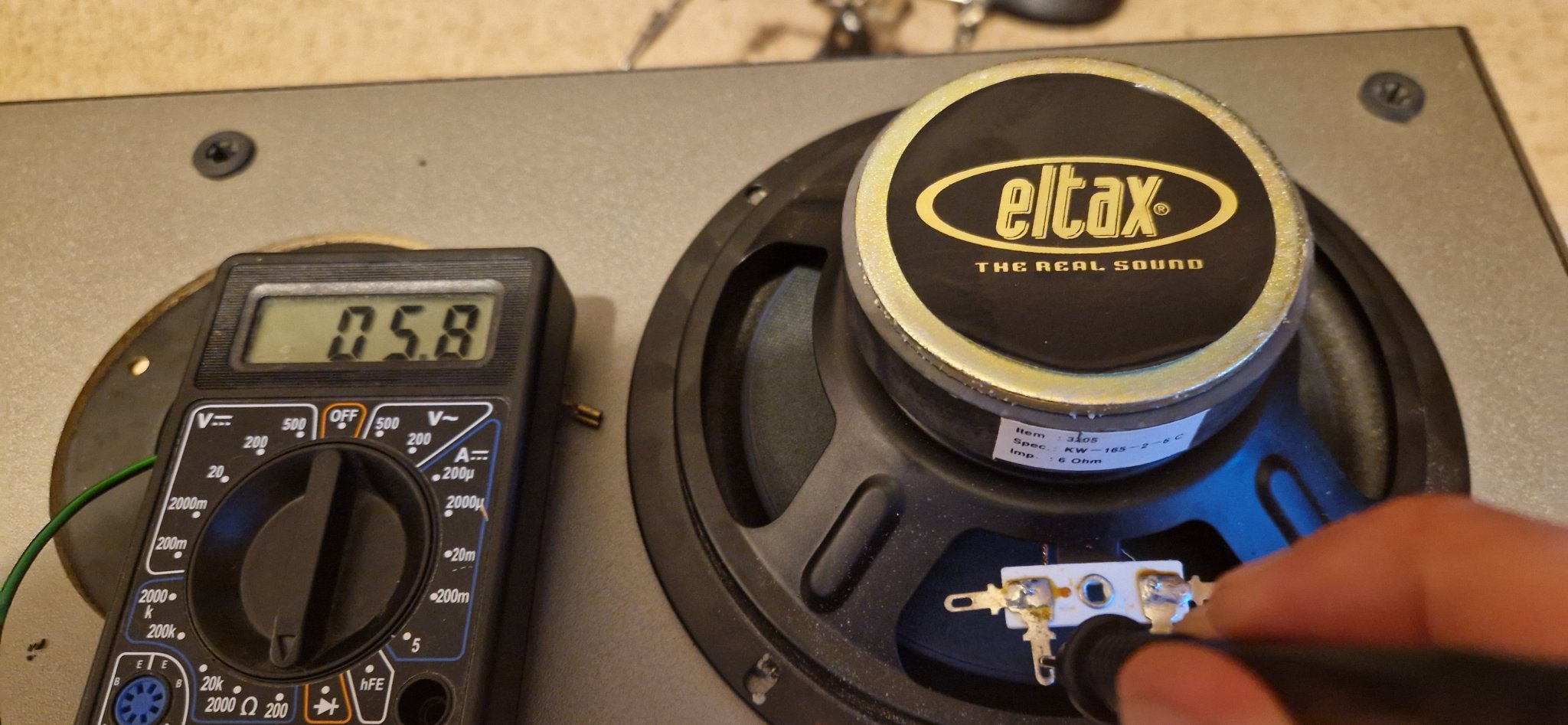

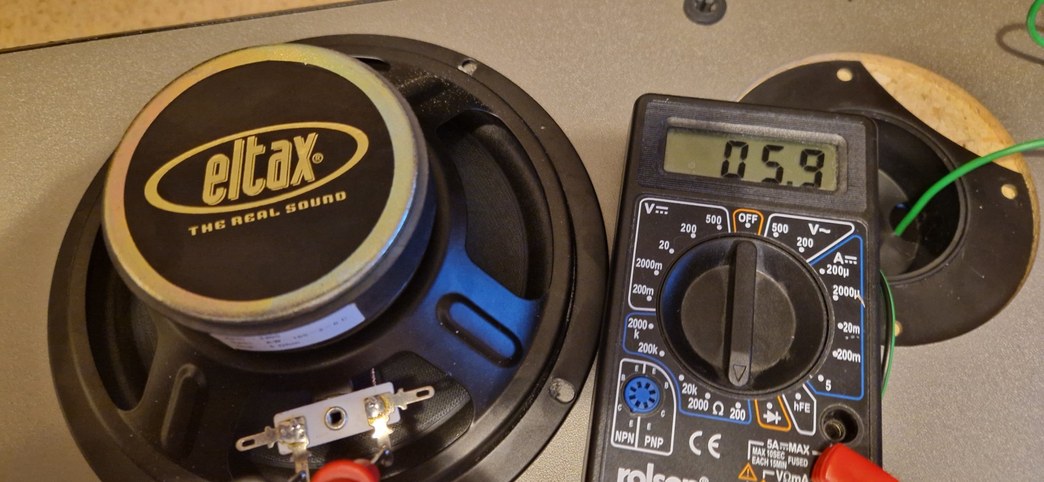

Cones of the woofers feel fine and the same across all 4, not loose, not crunchy/scratchy in any way
Measured the resistance and got the following results - see pics - does that seem about right?
Gonna be a case of using my ears on the tweeters - although if I can't sort the bass mismatch between the two boxes it may not be economical to do so.

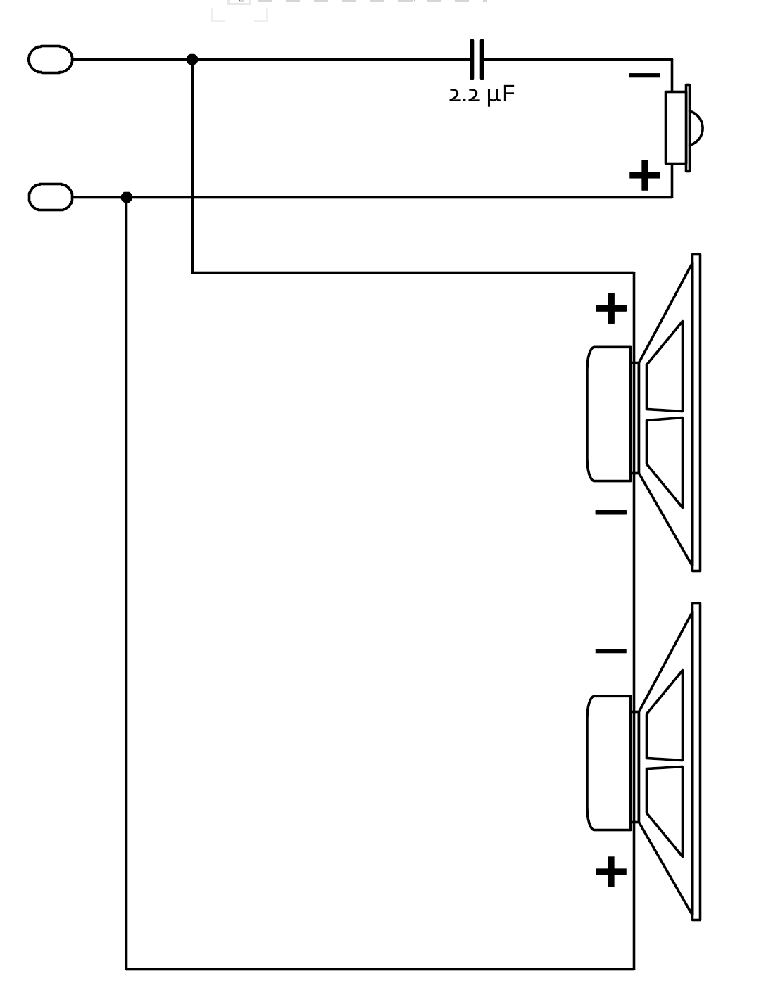

Those two woofers look fairly close, but it’s still possible to have a shorted coil turn with little difference in resistance.
Eltax Century 200 floor standing speakers. 3-way ported config
IK havbe redrawn the XO in a more conventional manner. Woofers are wired out-of-phase so no bass is expected. Tweeter XO is a nominal 9kHz.
It is a 2-way MTM. From what i see i’d guess these are "white van" speakers. XO is only a single cap, and at a strangely high frequency. I bet the enclosiure is unbraved thin chipboard?

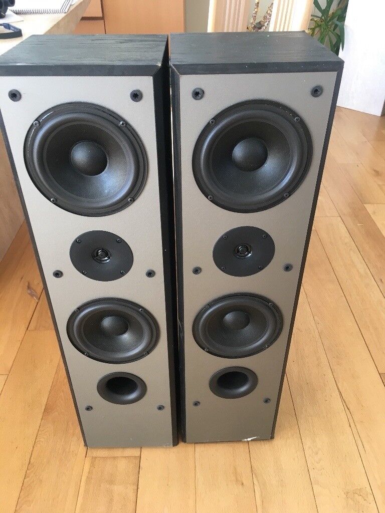

Those are the boxes in question.
Thanks for putting the wiring diagram together, way clearer than my scribble 🙂
Sorry for ignorance but what is "MTM" and "white van" speakers ? The enclosure is indeed unbraved thin chipboard 🙂
Is the lack of bass issue on that enclosure likely to be the out of phase woofers then? If so, do i solve by reversing the connections on the lower woofer?

Update: So swapped the connectors over on the lower woofer and i now have full bass response from both enclosures.
Thanks for the heads up on the phase issue @planet10, that's sorted it. 🙂

Given the first order XO all drivers should be wired in the same phase.
