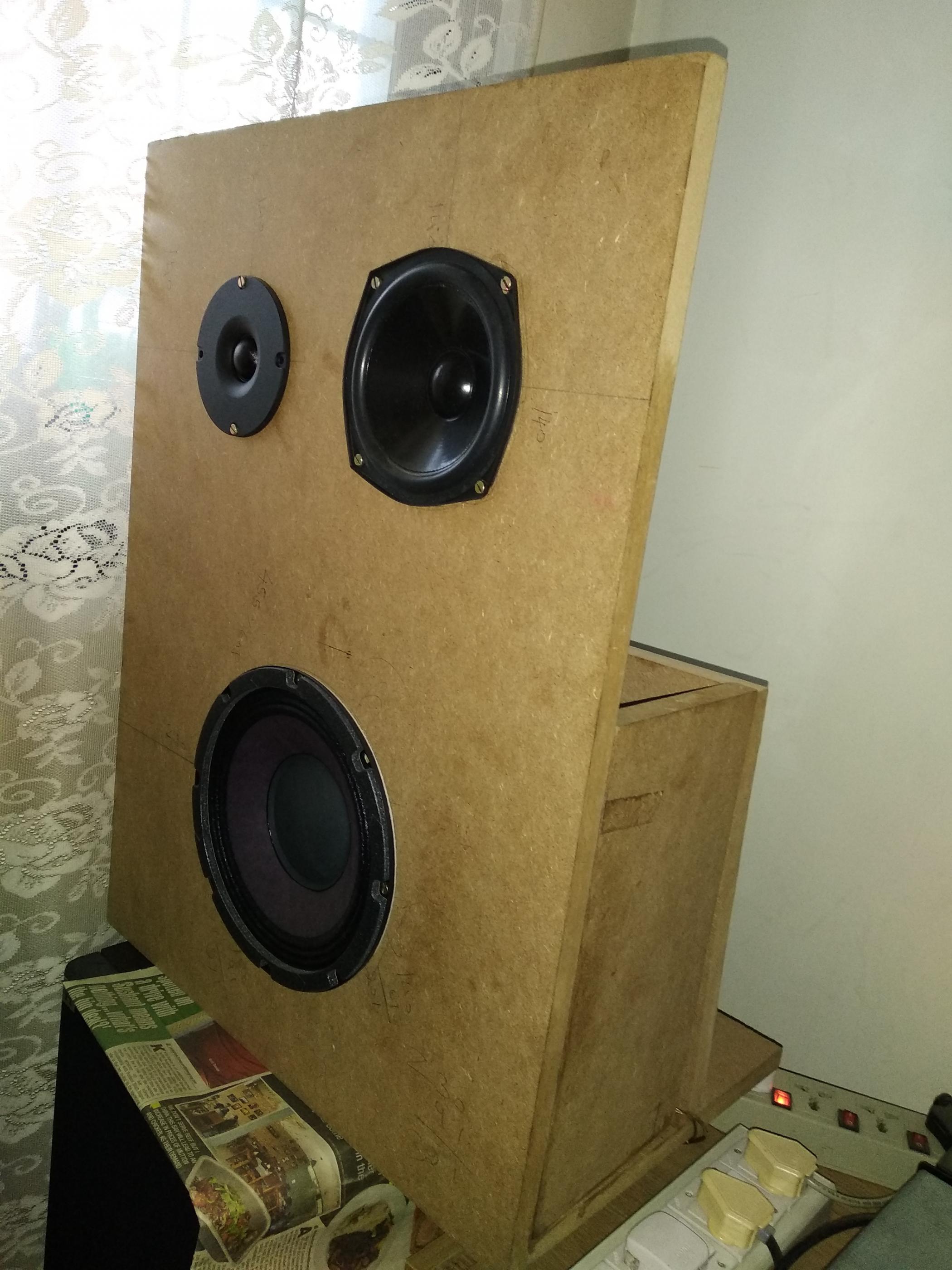

Hi phoenix87,
I have the Eminence Alpha-8a mid-woofer and the Peerless India TL26SG tweeter on a open baffle, driven in an active setup. The Alpha is high passed at 100 HZ,and the xover to the tweeter is at 1600 Hz.
There's a subwoofer that handles upto 100 Hz.
This setup is the best I have experienced for now in my small room.

Thanks , any pics of your setup??
