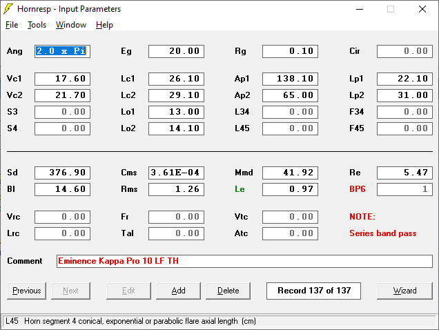

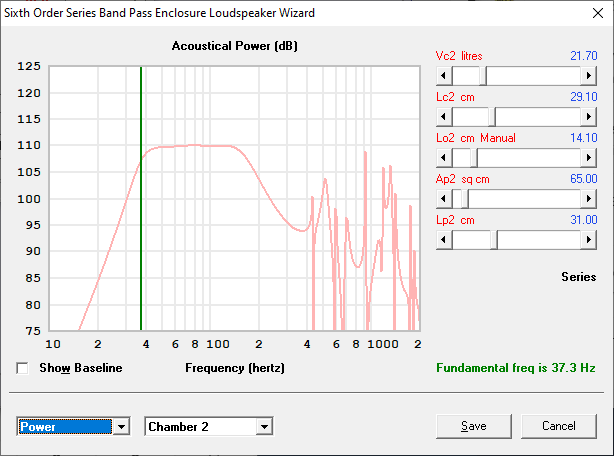

Try a series-tuned 6th order BP. I was looking pretty hard at this driver when I was considering an upgrade for my Enigma build. Here's one interesting model that might be worth looking at (see attached images).
It can also do 30 Hz at 100+ dB at 30 Hz, in a fairly large TH, but that can be designed to fit in a corner and look like a column, LOL.

That's a series-tuned 6th order bandpass. I'd guess that 110dB is at Xmax, so I'd hesitate to use that design in a PA situation, unless there will be quite a few cabinets to make up the SPL.
FWIW, a good 15" in a ~100L ported box will manage >120dB at 40Hz and up.

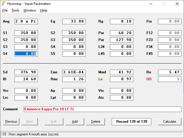

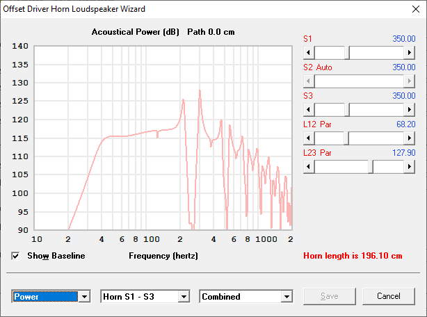

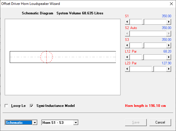

For example this is another option - a ~ 2 cu.ft. net straight offset-driver TL that should provide up to 5dB more peak output. Should actually be an easier build as well. But, it's bigger 🙂

I didn't want to mention brands but the cabs are turbosound TSB 110. This all came about as finding the replacements down here is impossible. Now if I was building new: yep 15" in vented box. The venue has two subs and with one still working there is actually enough bass... Capacity 100 people. Great ideas Brian, id say you've convinced me to go with it.
