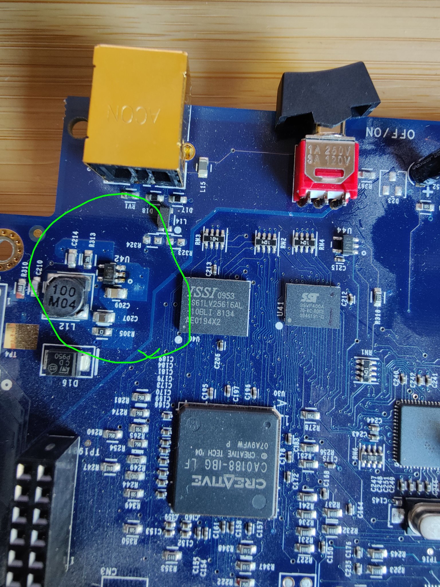

I took a closer look at the board and might have made some progress since I found a component labeled U42 that has discoloration on the solder pads and maybe some fry marks on the component as well. On this thread someone else also had this component fry on their unit:

Could you possibly help me out how to test if the component is fried? Or could it be just a cold solder?

It looks like that 5-pin part is TPS62200DBV, as the PHKI marking is consistent with datasheet. If you can probe +5V at pin 1 (across pins 1 and 2/gnd, and likely across C209), but get no 3.3V output (perhaps on other side of choke to gnd - which should also be across one of the smd caps). Use the datasheet from TI to identify pins and likely parts.
The concern would be that the 5V incoming is somehow switched upstream, and that switch is not working or not enabled, and so you can't energise U42 for starters to do any testing.

TP4 and the free pad area near U42 (to the right of the 3 terminal side of U42) may be good spots to solder wires to extend out for metering, once you confirm what circuit node they are.
If you can confirm that part is not working, then I guess you're half way to jumping the first hurdle.

I just measured U42 as per your instructions. Pin 1 -> gnd gives +5V but pin 4 -> gnd gives 0V. Does this conclude that the part is fried?
The 'choke' is the inductor part marked with '100' and 'M04', and has two terminals at its corners that can be probed to check that the internal winding still measures a low resistance, and hasn't open-circuited due to an over-current - this would be a very unlikely fault, but is at least easy to measure.
Finally able to update this thread. My 0404 is alive again! A new PHKI chip from Aliexpress took ages to arrive but today I swapped U42 with a new one. Soldering was a bit of a pain (first time SMD soldering) but I managed it. I'm testing the card right now and it seems everything is working just perfect.
