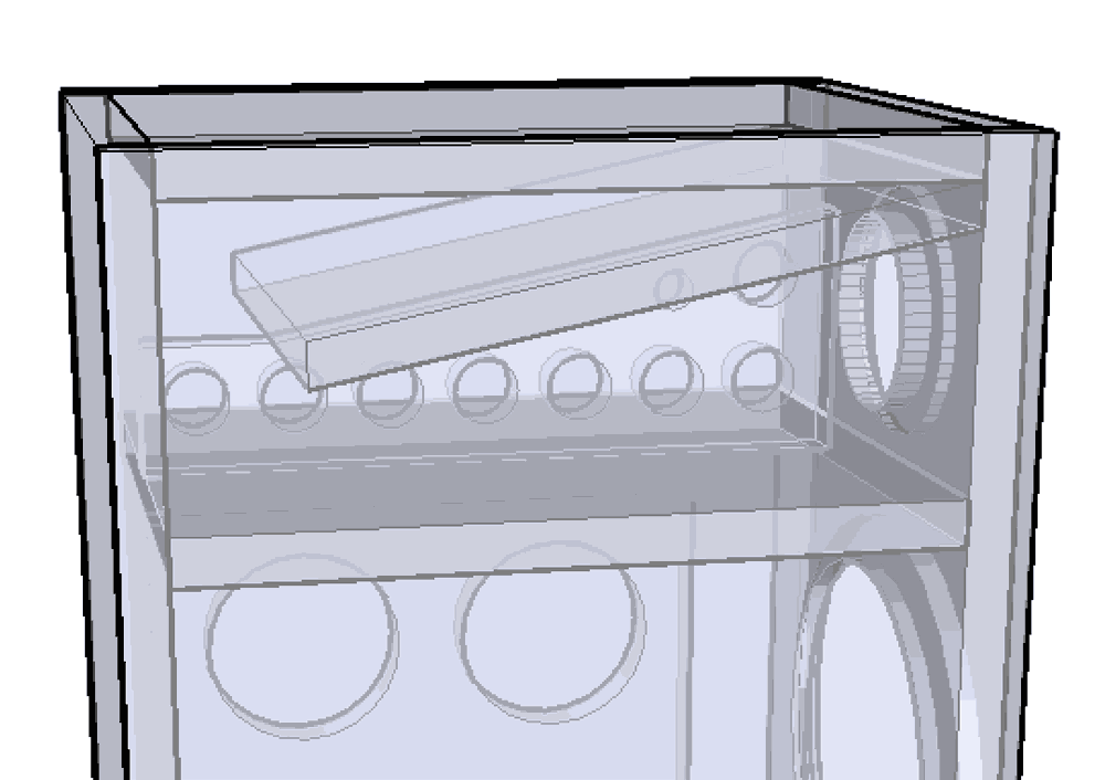

I'm interested in the idea of 3d printing an enclosure, if I can get someone to allow me to use the 3d printer at work that would be ideal but otherwise I might try see if I can use one at the local university. The interesting thing about 3d printing is you can produce almost any shape with huge complexities with very little added cost. So what you could do is create a lattice structure to increase stiffness while keep mass down (resonant frequency is proportional to stiffness/mass - you want high stiffness, low mass).
The other interesting thing about being able to create any shape is I could recreate this tapered cone of the B&W nautilus at low cost. While the 3d printer at work could actually create something as large as the bass section I dont think I could get away with using it for such a long time or afford the materials produced in that manner so unfortunately I'd have to go with something more similar to the diamond series with a normal cabinet for the bass section and a tapered tube for the mid and high frequency units. but its certainly possible!
I've seem a similar setup to what you have above but in push pull to create an isobaric chamber. Not seen them rigidly coupled like that, do you know what the name of the design is so I can read up on it? Also do you know the name of the design which creates the isobaric chamber actually?
If you wish to combine a line with additive manufacturing then a well engineered cabinet shape might look something like this. The overall speaker has made one or two questionable design decisions but it suggests how to improve cabinet design when less constrained by flat sheets.
something others often disagree with me, is to get the Q of any resonances as high as possible. This means that a lot of energy in a very small bandwidth would have to be injected into the panel to get it to move, something that you will very rarely see at higher frequencies in music.
My (very limited) understanding is that this is only half the ideal solution - it is great to have one layer as you described to provide overall stiffness but ideally it should be coupled to another layer with a resonance at a very different frequency, or no resonance at all or sandwich a damping layer in between two stiff layers, i.e. constrained layer damping.

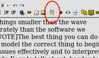

Could someone tell me if there is a quick way to quote again?

I don't think your question has been answered.Could someone tell me if there is a quick way to quote again?
Click on the 'Multi-Quote' button which is immediately to the right of the 'Quote' button.
Do this for each of the posts from which you want to quote, except for the final one when you should click on the quote button.
The best thing you can do for accuracy is to model the correct thing to begin with, isolate the issues effectively and to interpret the results properly. Easy to talk about, harder to do.to model sounds interaction with things smaller than the wave length more accurately than the software we currently use
This will give you fresh quote tags.a quick way to quote again?
