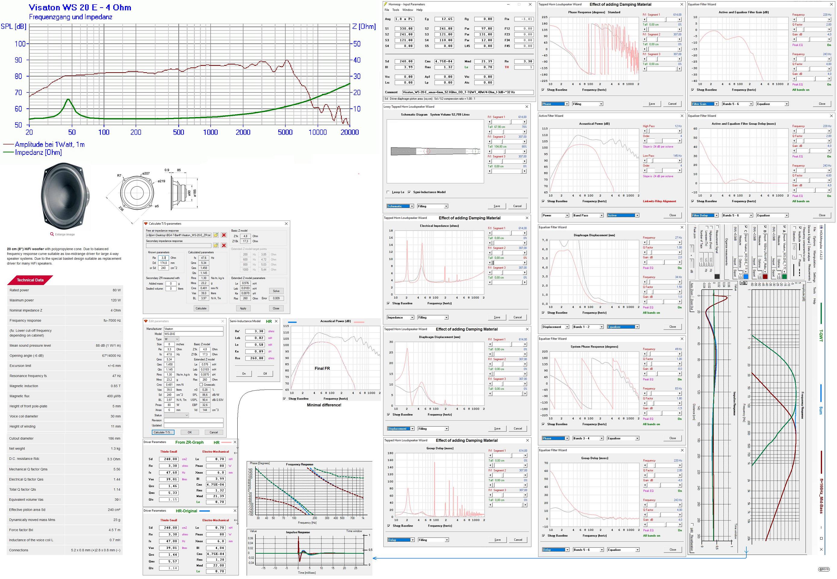

Hello,
I'm wondering if this driver would be more suitable for a vented box or a sealed enclosure. The EBP is 32.64 so according to that it would be more suited for a sealed box but I just want to hear some more suggestions.
The volume of the woofer box will be slightly under 39l.
So any suggestions?
Driver: WS 20 E - 4 Ohm | Visaton

Visaton has a design with a closed box for its smaller brother, the WS 17 E CLOU | Visaton

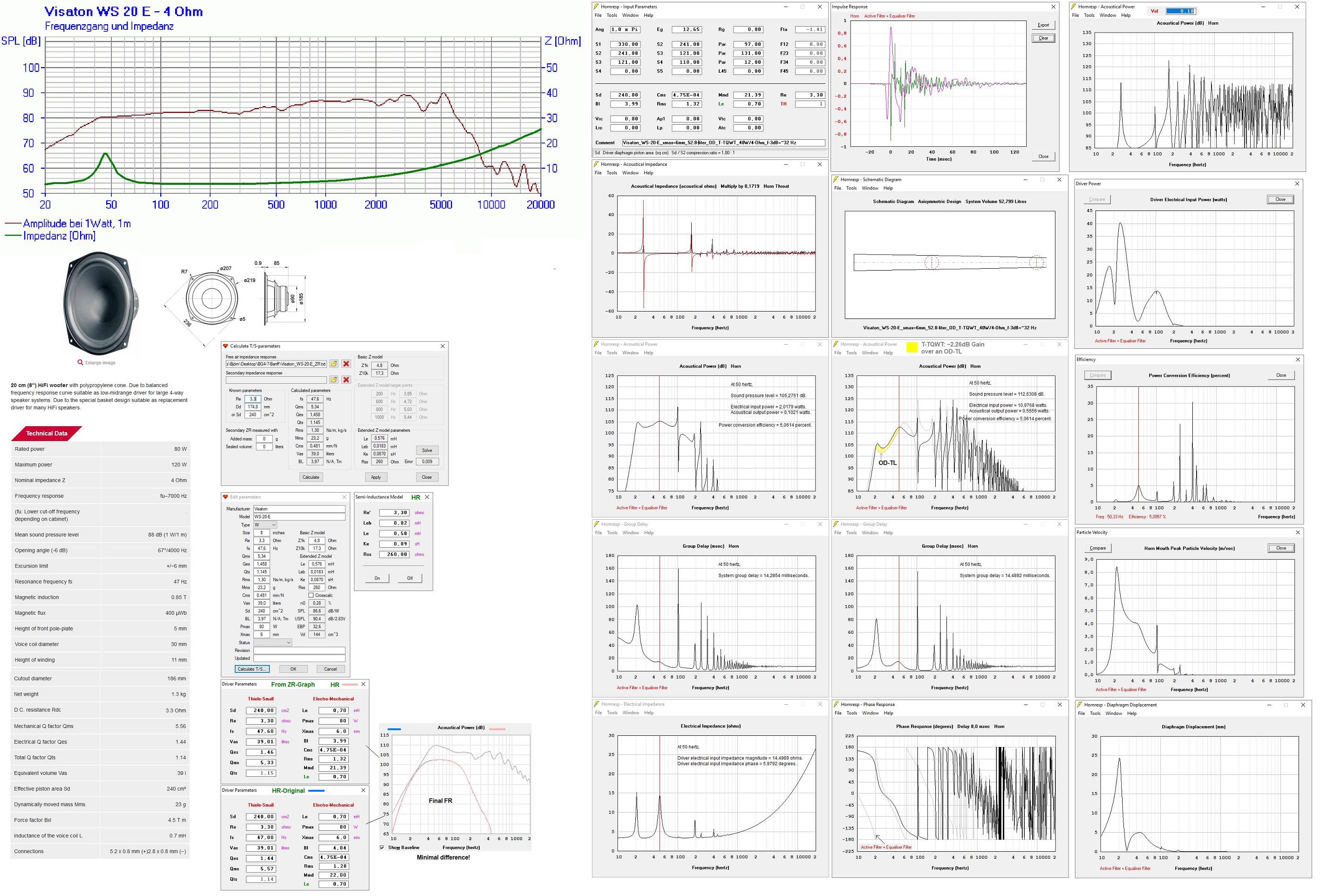

Hi All,
GM is right, A TL or a T-TQWT will do well,See the Pictures where a Mid-Bass can be added to a T-TQWT making a System showing very good System performance.
b![]()
