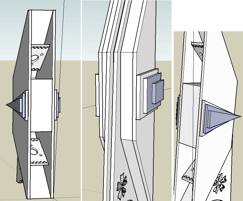

Project Idea - comments please
My proposal combines the same ideas as the OP’s I think -
Thoughts please.
- Make a floor standing enclosure (bass reflex, TMWW, 40l, twin Es180tia woofers with 30hz port) with a semi elliptical curved enclosure to reduce horizontal standing waves,
- Make the box from the following highly bonded sandwich - 2.5mm aluminium skin (mainly aesthetic), 5mm flexiply, 5mm rubber, 5mm flexiply, 5mm rubber, 5mm flexiply = 26.5mm shell. Baffle will be 28mm butchers block worktop in beech.
- Three window pane braces unequally spaced above, inbetween and below the woofers
- Dampen using the Troels schematic (denim lined plus Behind woofers, top and bottom acoustistuff)
- Mid will be in separate enclosure approx 2.5l made from drainage pipe, moderately stuffed and bitumen lined in and out.
Thoughts please.

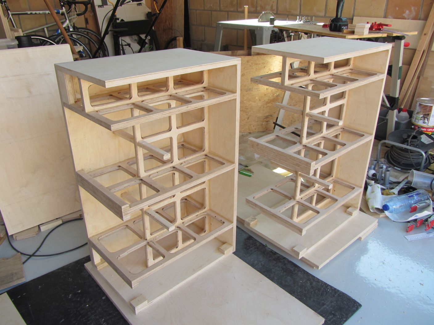

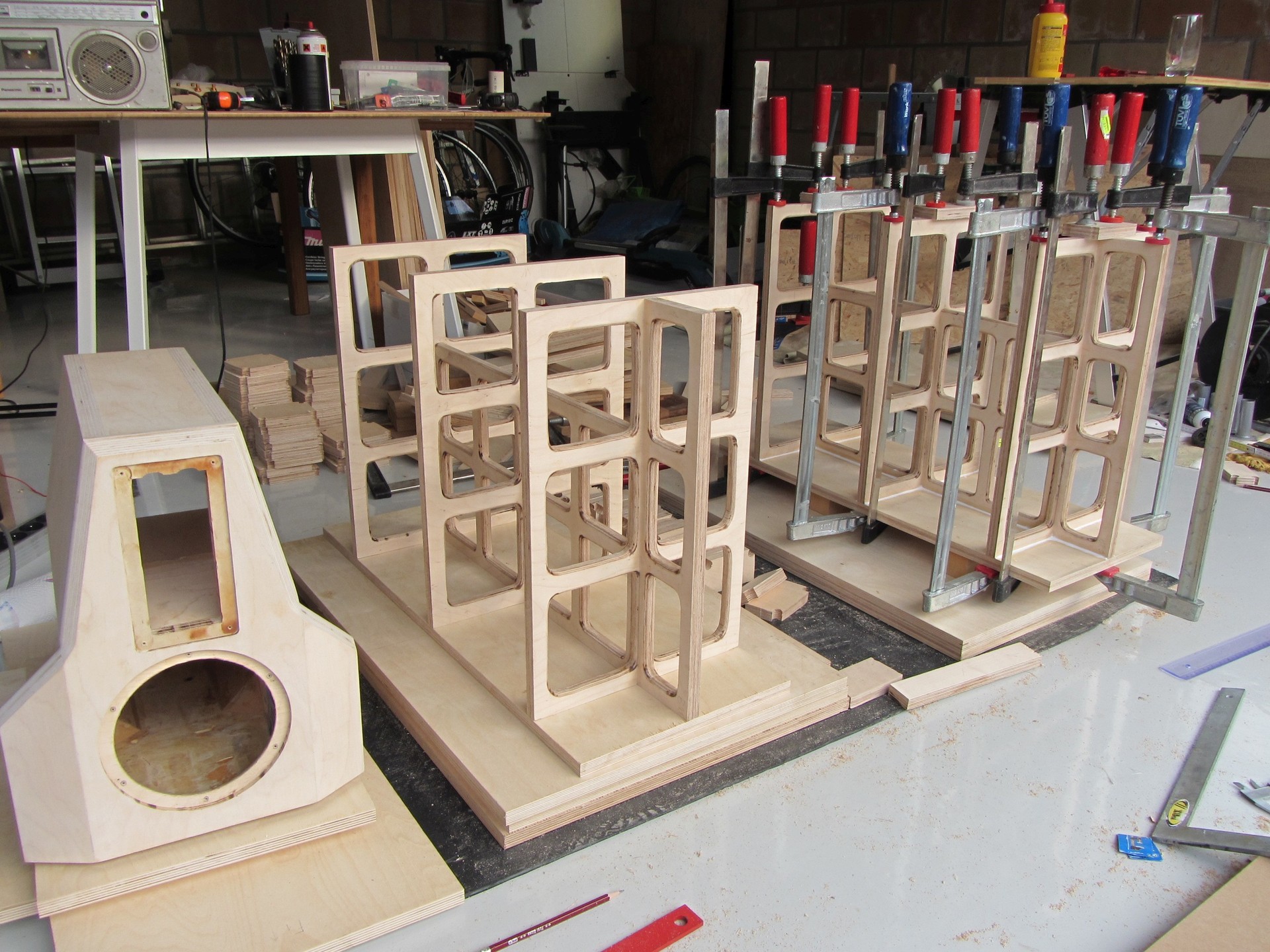

But here i saw symetrical bracings, which end up with a lot of pieces of panels (same size!) with same tuning frequency
.....hopefully out of woofers frequency range
No, they are not symmetric, the bracing/holes differ some centimeters from each other.

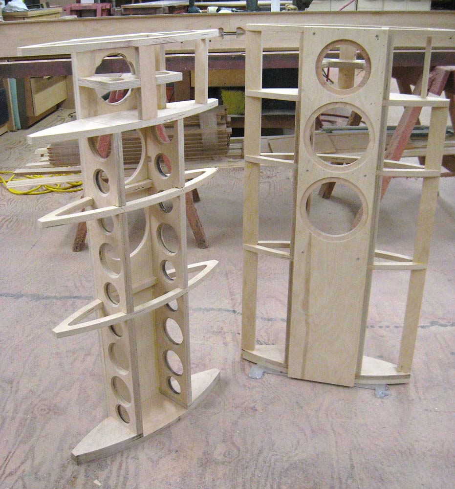

My gut instinct tells me the flexiply is going to resonate like mad between braces. When I have used it in boatbuilding it was like like juggling eels.
My aim would be to use something like roofing adhesive (stays semi flexible and used to bond dissimilar materials) to glu the ally, ply and rubber layers together to make a monolithic composite (sorry I think that is an oxymoron!). I have ideas about building a former to build it in to hep keep the shape and making it over large and then routing to size.
Inspiration was here, but with two of the layers replaced with rubber and an ally skin added to the outside.

[*]Three window pane braces unequally spaced above, inbetween and below the woofers
Ideally a brace should be placed such that the subpanels have unequal but higher aspect ratio than the original panel… a horizontal window pane brace in a floorstander as described can actually exacerbate the resonances — at least yours are not equally spaced.
My gut felling as well, but the one build we did do using this material does not exhibit any issues.

Tim, short answer, yes - specifically yellow cabinet makers glue (Titebond II or Dural equivalent). Standard practice in our particular commercial mill work fabrication of curved reception wall, overhead bulkhead, etc. Three layers of rubber ply, thick coat of yellow glue to each of the 4 internal faces - the very open grain and rough faces of the meranti veneer used in this particular brand is very absorbent- and approx 4 hrs in vacuum bag on a purpose made form not the skeletal frame in the photos. A single layer of the ply is very flexy, but 3 layers ( which closely matches the thickness of nominal 3/4” ply used for the flat front panel on which the drivers were installed) fabricated this way makes for a quite rigid assembly. There are a variety of pre kerfed panel materials that could also be used, but I’d never had luck with them not telegraphing the “seam” of each kerf through the finish layers.
P.S. yes, also a single layer of 1/8” contact cemented on the rubber ply panels for smooth substrate for the final veneer. Embarrassed to say I can’t remember now if that was MDF or BB ply.
Nominal thickness of the rubber ply is 1/4” - just under 6mm.
