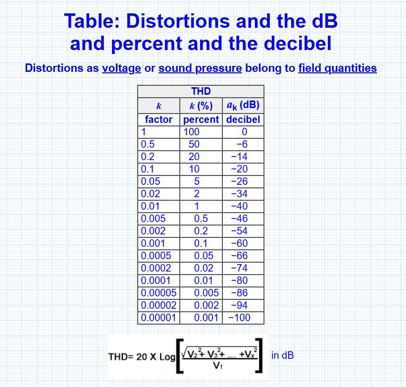

but the distortion is quoted in dBc which I suspect is a way of covering up how bad it is (in relative terms). I found an online calculator to convert db to percent. dBc I assume is C weighting and I'll bet that is done to make results look even better than they otherwise are. This is not a bad example, its typical.

Over the audio range that generator is -55dBc which for -55dB is 0.18%

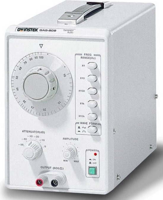

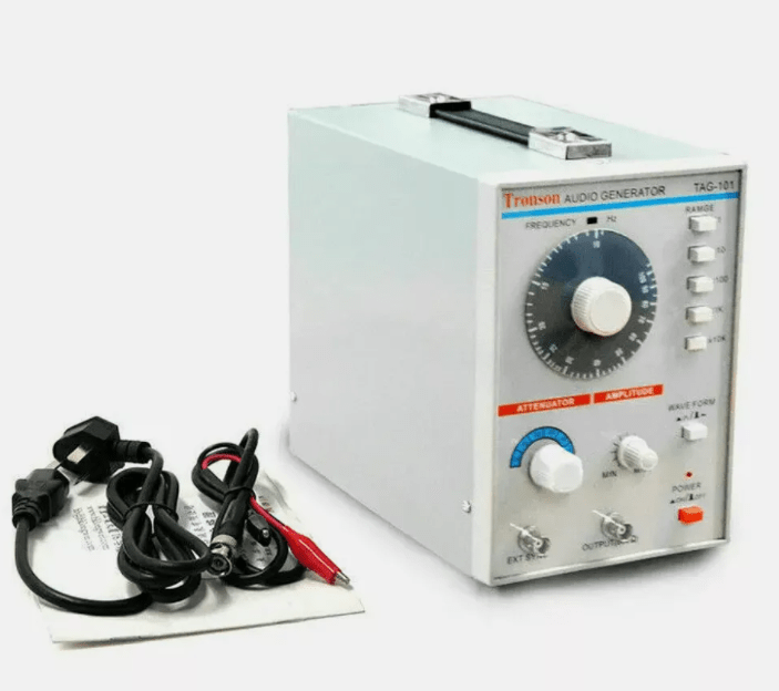

This type of thing is much better distortion wise (not that I'm recommending this although it may be fine)
https://www.ebay.co.uk/itm/17640832...Qu6t8ivfo0wLznDExtv642SSGzzP|tkp:BFBM0LDAtoxk

Good morning Sir ! thank you very much indeed for your always kind and precious advice
I will buy one immediately I like a lot also the rotary knob Very very nice

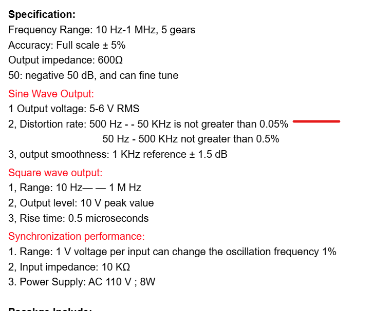

I am quite sure the THD from the generator will surpass the one from the circuit under test
But i need one signal generator standalone The price is very very good
Thanks again

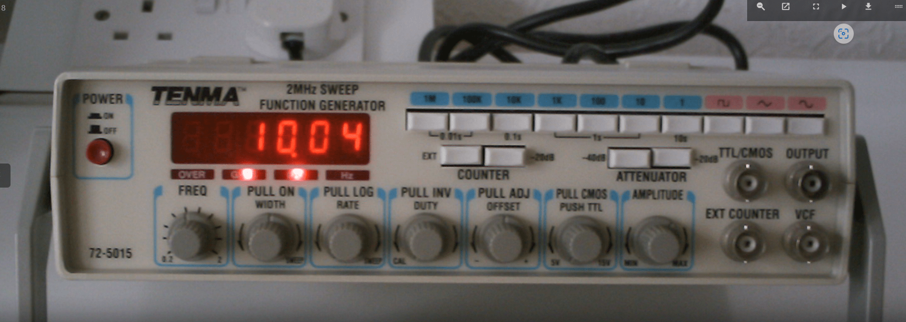

And one of these:
The sine produced on the function generator is not totally pure as it is synthesised from the basic triangular waveform the generator produces by using diode shaping. Although it looks OK on a scope you can actually hear that its not quite pure when compared to a true sine, and if you look really carefully on a scope you can see a very tiny glitch 'like a join' at the top and bottom of the sine. Its microscopic but its there and you can hear it.
