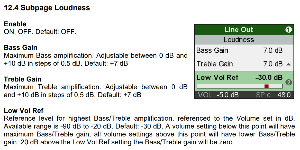

I've been using the loudness feature on my ADI-2 DAC FS and love it. I'm using this mainly with TV/movies (new house doesn't suit a surround setup, and I have young kids so volume needs to be kept low in the evening).
https://www.rme-audio.de/download/adi2dac_e.pdf
Basically you set a reference level and bass/treble gain at that point. At 20dB above reference the gain of bass/treble is zero. Bass/treble gain is automatically reduced as you increase volume between reference level and 20dB higher.
All settings are made by ear at this point but the impact on voice intelligibility and bass presence is profound (to me). I can switch the feature on and off via the remote, so it's easy to compare.
