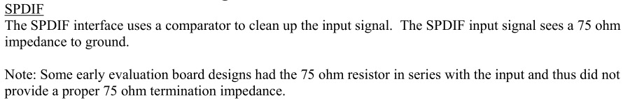

I took a look at the board again, and the schematic, and there's a bit of a snag. My board has a 4-pin SMD XO on it instead of a 2-pin through-hole. I can't find any capacitors that look equivalent to those marked C152/C153 on the schematic, either on the top or bottom of the board. It also looks like the output (Pin 3) goes straight to the XO input (Pin 24) on the Sabre, and nothing appears to be connected to Pin 23 ("XO"). So, a major break from the schematic. Weird.
In light of this, how should I try to perform the prior-mentioned diagnostic procedure? Sorry if this is a really newbie (i.e. tedious) question. I have a limited understanding of the mechanics at the moment, so am not sure about these things >_<

It does sound like you have a different (but how different I don't know) version of the DAC. It appears the 4 pin device you see is actually a complete oscillator in itself and not just a crystal as shown on the diagram. That means the simple tests outlined wont work because you can't get 'inside' the device to pull the frequency. As we can't measure the frequency and use a scope to look at the output, replacement would be the only way of proving it. I'm not sure either how standard the pin outs are for these oscillators... you would need to check before ordering one. And check the frequency is still 25Mhz as per the original crystal.

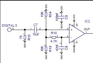

This is the (somewhat) official Coax input schematic for ES9018 that's known to work.
IC2 = LMV7219 (SOT-23)
VDD = 3.3V
R13 = 75 Ohm
You may replace the IC2 if you suspect that it may be defective. You may also increase the DPLL value if you can access the DAC chip's firmware registers.
