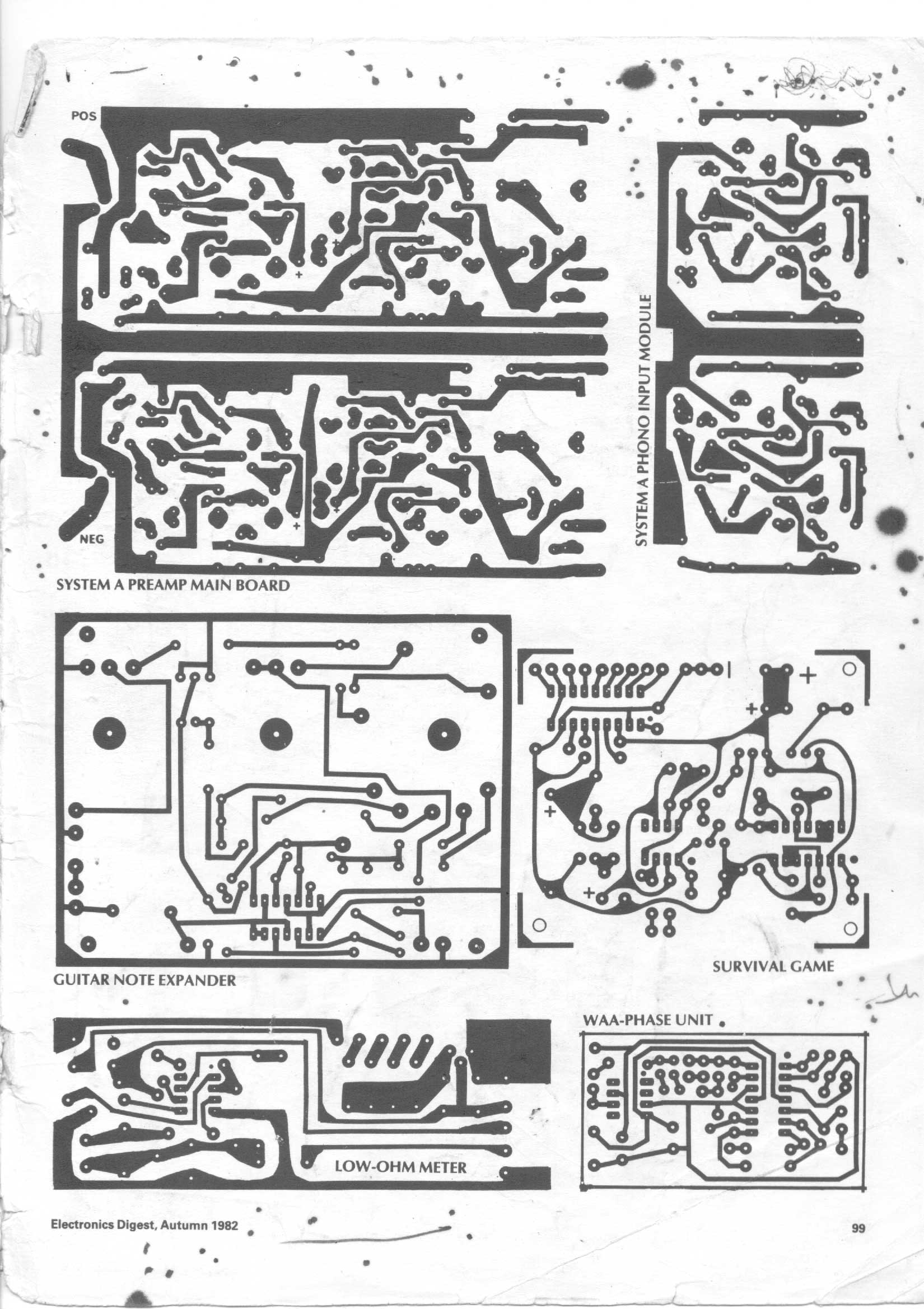

I know exactly what you mean Mooly! I had already been building stuff for years by the time I built this aged 17.....
All the little dots etc around the pcb layout are from me cleaning my Dalo pen nib whilst hand copying the layout to copper clad.
It does actually sound very good indeed. As a matter of interest I built a copy of the design a few years afterwards but using NE5534 op amps in place of the discrete ones. It sounded good but was very obviously inferior to the original..... there could be life left yet in the original design in spite of the fairly crude discrete op amps 😉

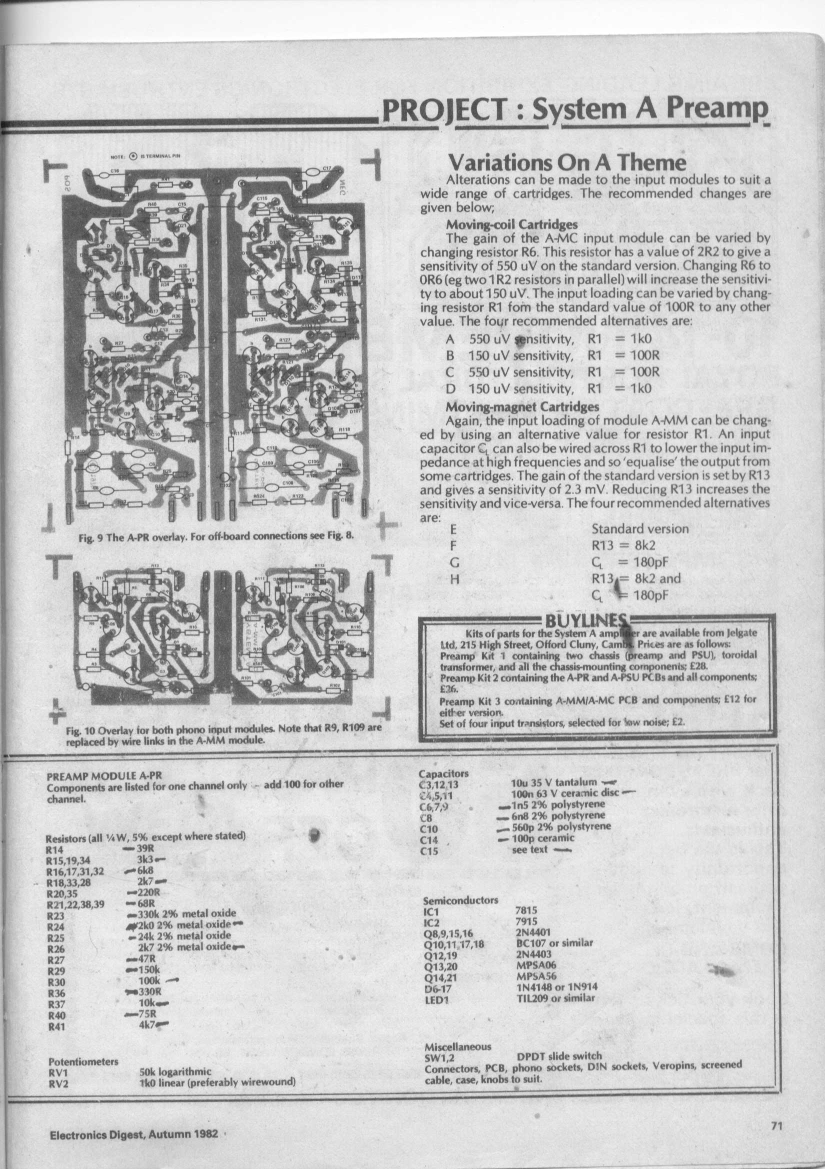

This project article had a different revision that includes a table with RC loading for various MM cartridges of the time.

My first home build too. If anyone is wanting to build from the PCB scans there was a mistake in the artwork. I remember building it and the dismay when I didn't work. There was a correction published a couple of months later. I still have the magazines in the cupboard if you need the correction. I also have the Stan Curtis System A power amp articles if anyone wants them.

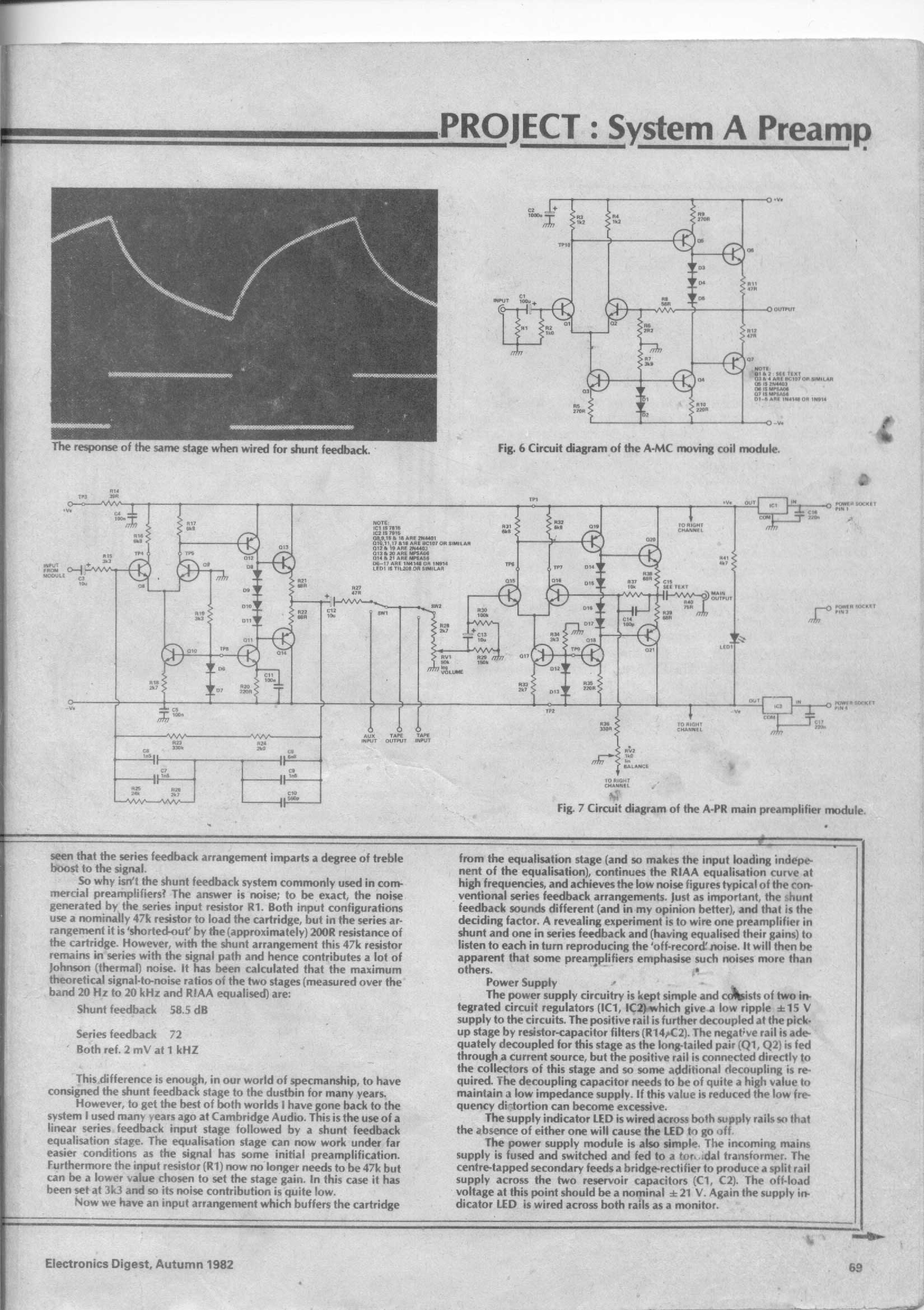

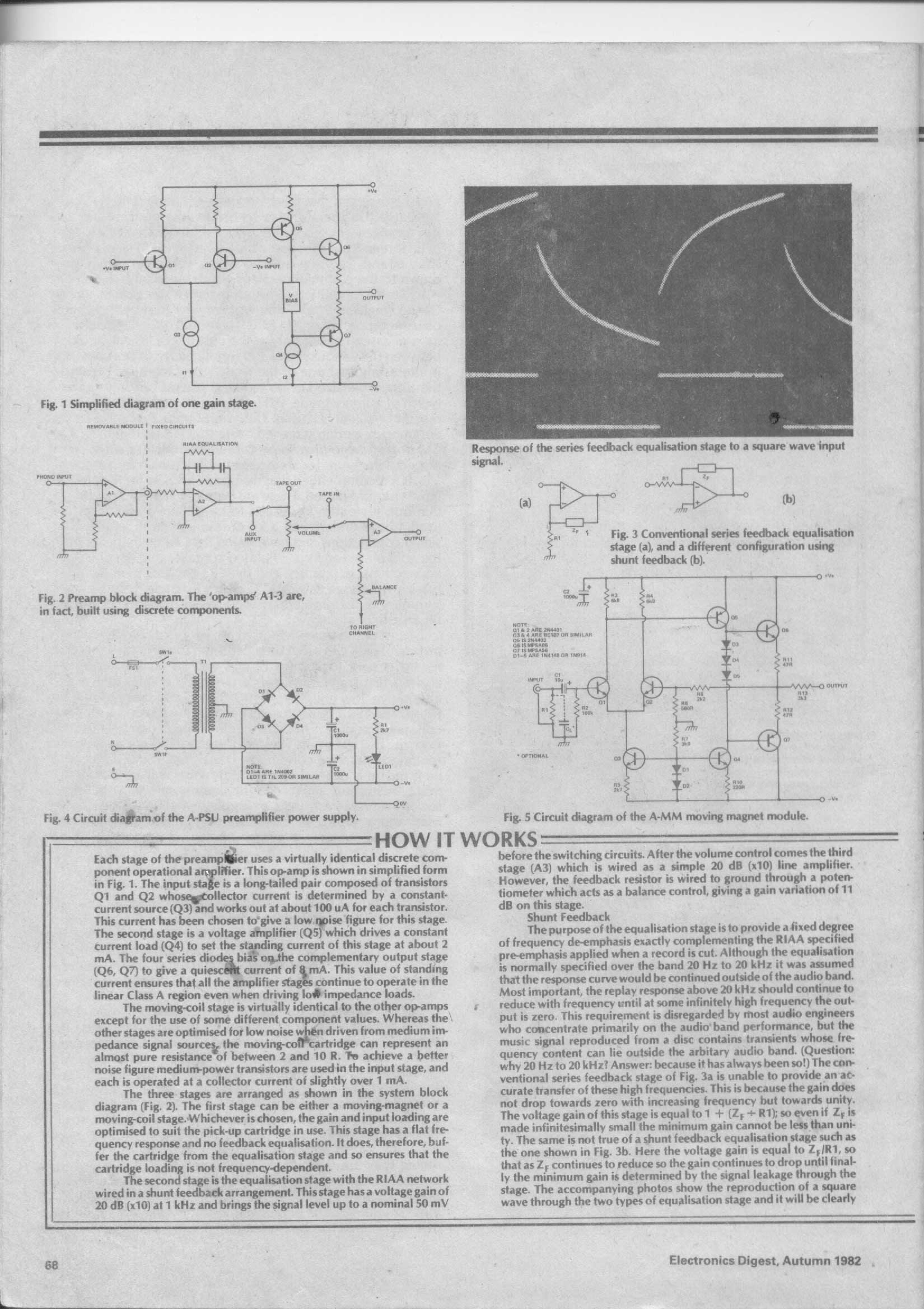

a great preamp. It was my second diy audio attempt in 1985. I was using a NAD 3080 integrated,then and I remember well,that his RIAA section send the Tomlinson Holman designed NAD RIAA,for a walk in the woods.It gave me 3 years of good service,repaying its existence nontheless, great guy.An iconoclastic design,using shunt feedback in the RIAA,instead of ,the politically correct series feedback.He wrote in the text,that although the shunt was vastly superior audibly,the series one was measuring better.(ever heard of that weird phenomenon?)It still exists in the attic,and there are times that I long for its sound.Some day...
