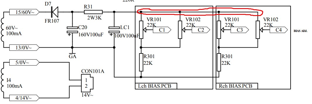

As to why, long story short: I always wanted that lush warm jazzy sound of old tube amps but simply couldn't afford one until my uncle gave me his Cayin A-55t which he already modded with better caps and other parts, so selling it for an other is out of the question.
This amp came in a EL34 version A-50t and the more expensive KT88 version A-55t.
Don't get me wrong it sounds fantastic, but it can still get a bit agressive in the upper mids.
Newer models come with a switch to let you choose between EL34 and KT88 so I figured it might not need much modding to try some EL34s in it? The loss of power is no issue since I never listen past the halfway point of the volume pot.
The schematic:

I see the schematic link doesn't work. How can I share a pdf file here?

the link for the schematic is missing a colon http://images.tubebbs.com/clone/c/Cayin-A55-int-sch.PDF

There are no "bias resistors" in there - that amp has fixed bias.
Running the EL34 at ~420..425V plate voltage and 40mA (as per schematics) requires about -36V bias. Running the KT88 at the same operating point requires about -55V bias.
The only way to achieve this is to modify the bias adjustment circuitry, but it looks like there may be not enough voltage. If you can measure the voltage at the top of the bias pots (marked red) relative to the ground when the amp is running, then we can tell for sure.

TG, I measure -62.6 at that point you requested.Swiching from KT88 to EL34 is definitely possible. Still my question about the "full" bias voltage remains.
Then you can change the R31 to 6.2..6.8K and R301 (both of them) to 15k
That provides the needed bias adjustment range for the EL34 while keeping the load for the bias tap and rectifier the same as before

The amp in question is fixed bias push-pull. Did you look an the schematic?

It's a push pull design running almost exclusively in triode mode.

So to conclude: if I connect pins 1 to 8 on the tube sockets and replace the resistors TG mentioned by said value I'm good to go?
Exchange the KT88 for EL34 and set bias accordingly.
