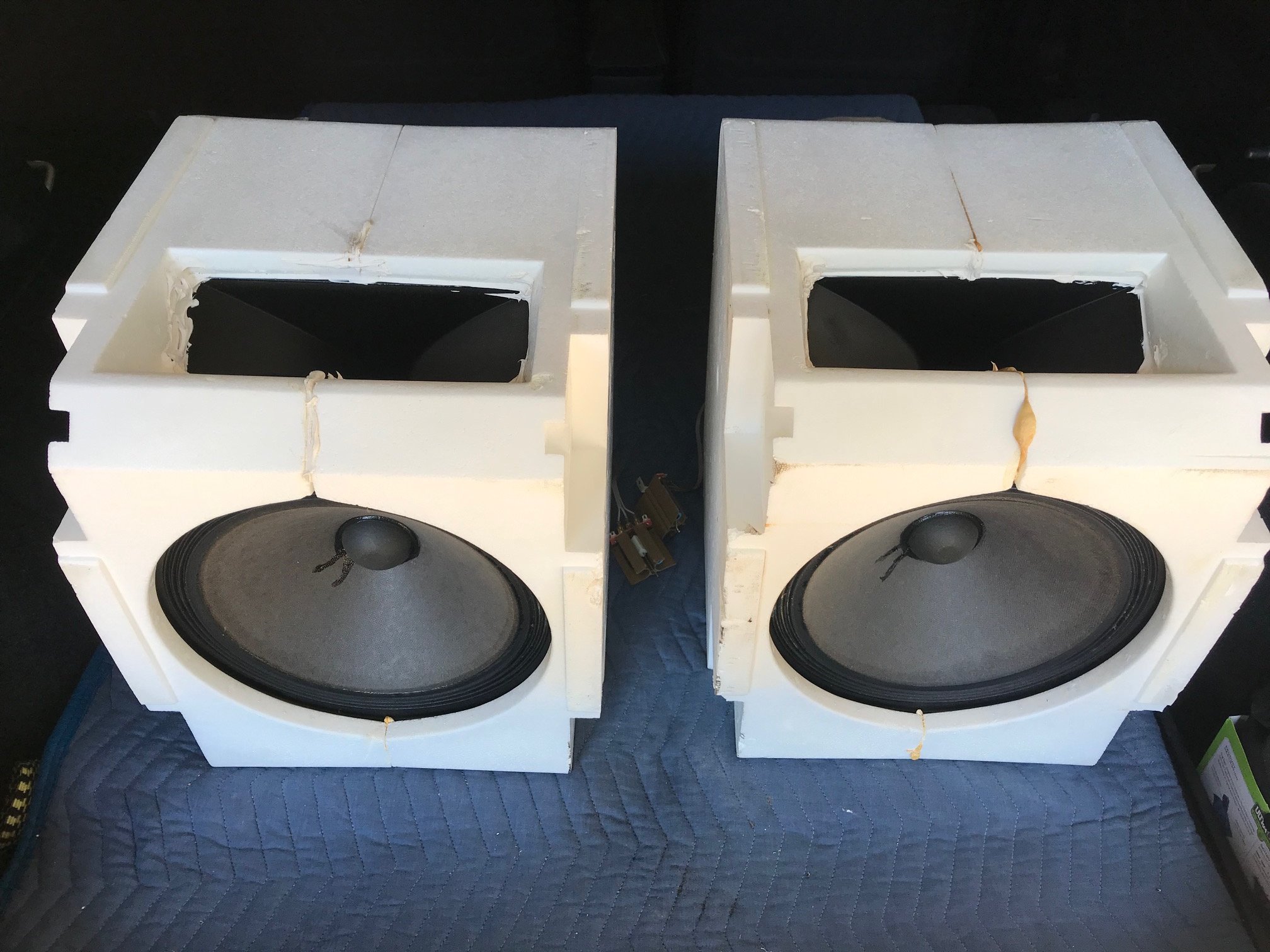

I rescued these from a cabinet at the curb in my neighborhood. 10"-11" woofer and horn tweeter in a sealed foam enclosure with an XO consisting of inductor, cap, and resistor. In great condition. Try drivers individually with real XO? Ported or sealed? Want to find out any info before I bust into the cab. Hoping Planet 10 Hifi will chime in. Thanks for any suggestions.
I had a set of these years ago. The little horn is a Foster. I think the woofers were CTS. Good fun stuff to play with. Full range they are not, of course. It's a two way with simple crossover. Planet 10 Dave has probably owned a dozen of those. 🙂

Must be from a much later console than the various brands/models I scavenged as historically [mostly pre late '50's] they came with just a 2.2 uF? cap regardless of driver/horn size.an XO consisting of inductor, cap, and resistor.

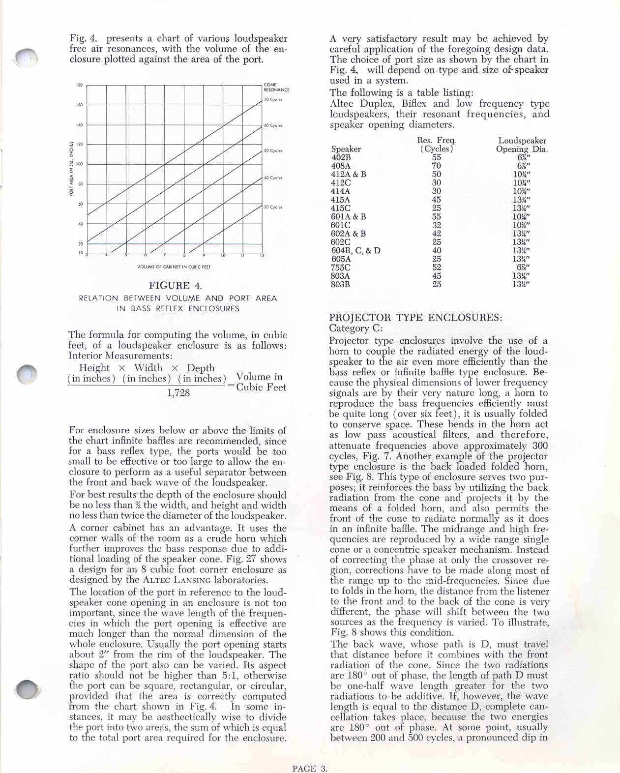

Regardless, the ~sealed foam box tells the tale, i.e. some form of ~aperiodic and short of measuring full T/S specs, personally would go 'old school' and find actual woofer Fs after some [re] break-in and choose the box size/tuning based on this chart and damp to 'taste' 😉 same as me and many DIYers did way back when: Altec '60s cab design

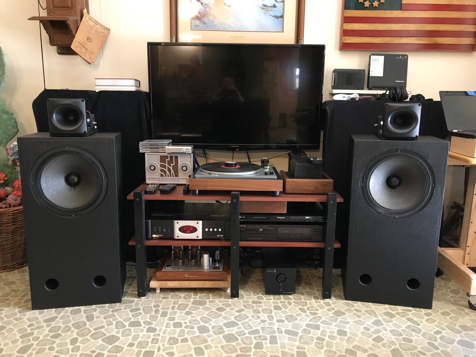

I was experimenting with 8" woofers (Dayton RS225-8 and Visaton w200S) in another thread but decided to use these vintage 12" Magnavox woofers with Michael Chua's recommended Pyle PDS442/Dayton H70E combo. Went with a 2.2 cf
ported box. (about as big as I could move around) Used an XO from an old Econowave thread on AudioKarma. Sound pretty good. Just got my Magnavox 9300 series 6BQ5 amp back from being modded with Dave Gillespie mods.

Looks good! You might want to try the Foster horns, they are better than you might expect. Somewhere I have FRD and ZMA files for them.

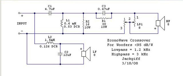

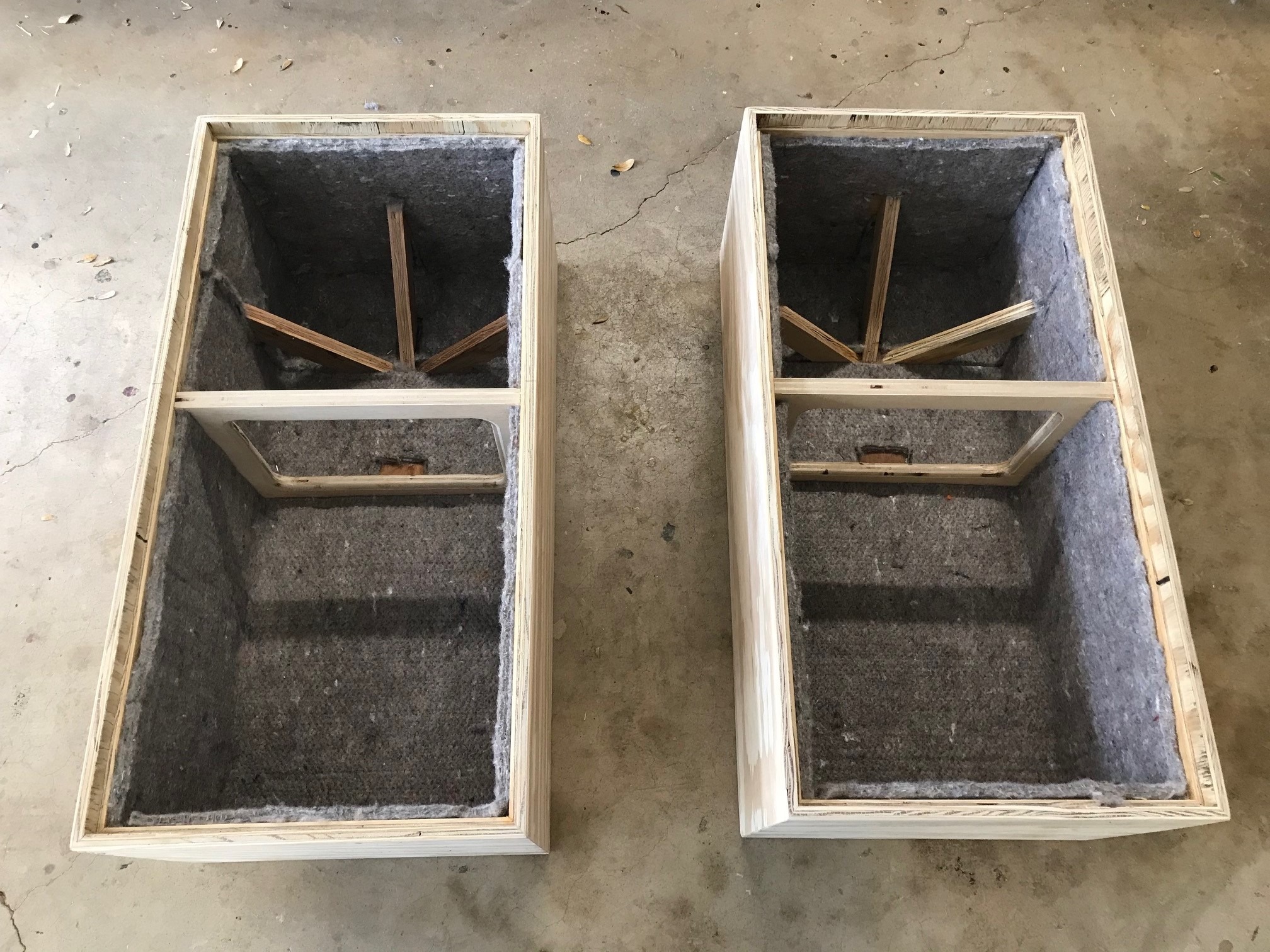

My cabinet dimensions are 30" h, 15" t, 11 1/2" d. Approximately 2.2 cf. My ports are 2" id by 4" long. Attached is a pic
of bracing and lining. I used cheap "found in the neighborhood" plywood and Duratexed it all. Everything is done by guesswork but cab dimensions are based on what I had available and (after triple hernia surgery) what I could move around. To quote Monty Python "I'm not dead yet" The woofers are alnico and have cloth surrounds unlike the earlier Magnavox that had the paper accordion surrounds built into the cone. I ran them in on FM C&W to loosen them up before installing them and also put two coats of thinned Modpodge on the woofers. I found the Foster horns to be bright and strident and was going to offer them to others. I don't like bright. Any suggestions would be greatly appreciated. Here's the Econowave XO I used. Thanks!

Thanks so much for the specs. Sadly, I'm not able to figure our measuring/simulating programs. Almost 70 and that
ship has already sailed. But, I am able to copy other's designs. I compared the Foster horns with the Pyles that Michael
Chua recommended and I think I'll stick with the Pyles. I'm enjoying these with the 12" Magnavox woofers. If you or anyone else would like the Fosters to play with, let me know. I'll box 'em up and ship. Thanks again for your thoughfulness.

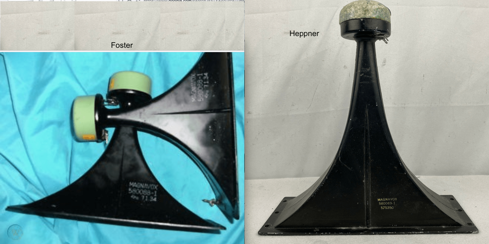

I also owned/burned up more than a dozen of the 4x10.5" Japanese made Foster horns distributed through Radio Shack in the 1970s, but older Magnavox horns were made in the USA by Heppner, the tooling later bought by Klipsch.I had a set of these years ago. The little horn is a Foster. I think the woofers were CTS. Good fun stuff to play with. Full range they are not, of course. It's a two way with simple crossover. Planet 10 Dave has probably owned a dozen of those. 🙂
This might be better in the multi-way forum.
The Heppner part number included a 575 in them, and may be considerably deeper, 11" compared to 7.75", so have a lower cutoff frequency than the later Foster.
