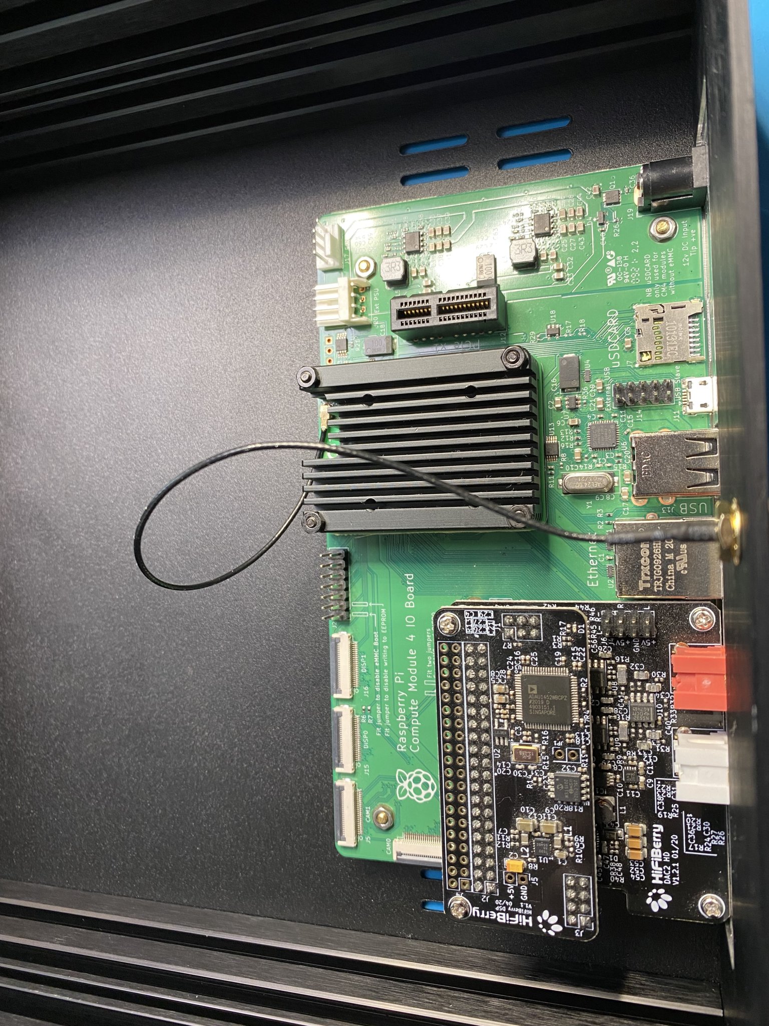

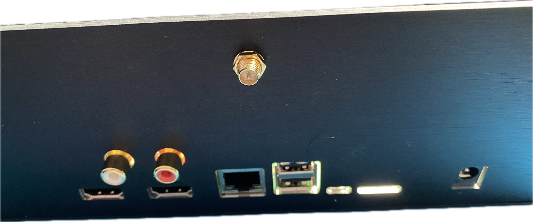

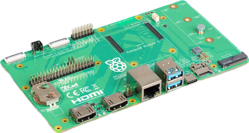

The new raspberry pi compute module 4/5 solves a lot of issues for me.
I have a few cm4 with audio hats and just ordered a cm5 with hopes I can find a compatible gen3 nvme that has 4tb of storage to serve files.
There are all sorts of CM4 IO boards with different features that you might check out.
The compute modules run cooler and the WiFi/Bluetooth is an option along with eMMC storage if you don’t want to use nvme.
