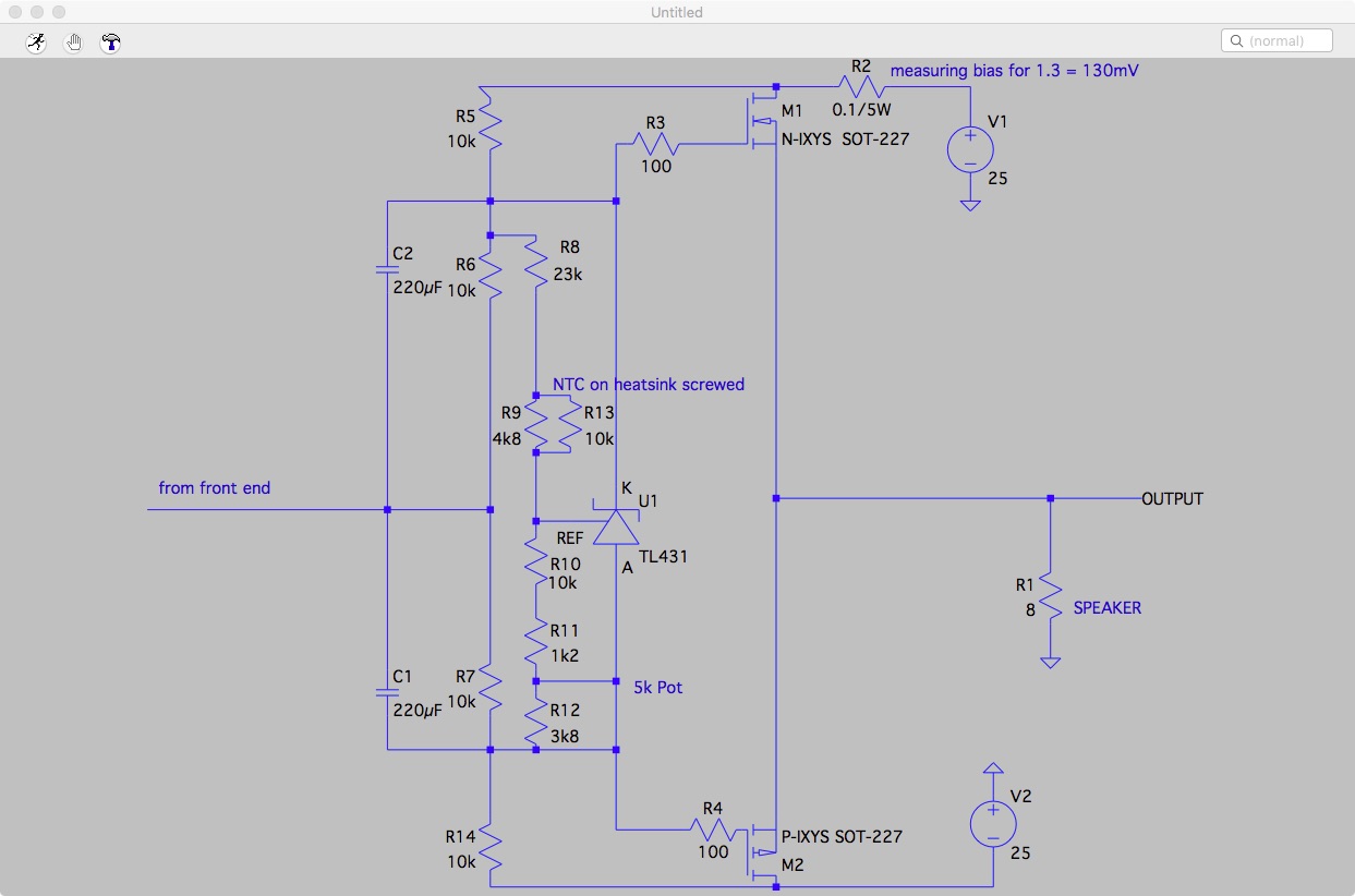

combined from
F4 and Sony II bias system, NTC added
and Sony II frontend
and F4 like output stage without source resistors....
Have fun!
Tell me if you see errors, I use to make them....

That is essentially what I have.All thanks to Nelson for unique box of bricks,
so here comes my Hockey Puck Puzzle.....
The only difference between your front end circuit and mine is slightly different resistance values in the feedback loop (but that may change again), zero source degeneration through out entire circuit, but I may change that to zero degeneration on jfets, then 5 to 10 Ohms on 2sk2013/2sj313.
Edit: I was also considering using Laterals (just to be a little different) with zero source degeneration instead of 2sk2013 and 2sj313, but I'll wait and see to decide.

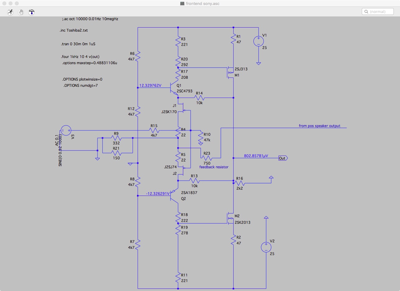

@2picodumbs
yes you can run J-Fets with 6-7mA Idss without source resistors, I just see I put in 22R in my frontend. This high value is due to the Spice model of my J-Fets having around 12mA Idss.
So if someone has 8-10mA Idss the normal 10R for source resistors is the better choice...!
and keep in mind that I use the "old" Sony frontend, there is newer version in the Sony II thread with slightly changed resistors and possibly better sound as Nelson was told when he got some feedback from people.

This is similar to what I have modeled, except for the following:
1. No degeneration resistors anywhere
2. Different "coupling" of the driver to the outputs like in the UGS/UP which avoids capacitors in the signal path, but might make bias touchy
3. No cascode on the JFETs
4. IRF610/9610 MOSFET drivers instead of the Toshiba parts (too afraid to test with my precious Toshibas)
The model, for what its worth, looks fantastic. With luck, I will be able to find time to cobble this together some time in the next month...

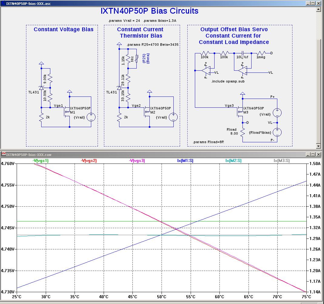

In post #130 http://www.diyaudio.com/forums/pass-labs/299383-pass-xa25-13.html#post4906864 I discussed bias circuits for the output fets. There is an LTSpice simulation comparing 3 bias circuits for an IXTN40P50P operating between 25C and 75C with 24V rail voltages, and 1.3A (approx) bias current.
The Thermistor Controlled Constant Current circuit tracks very well with the "ideal" Constant Current Servo.
The plots show Vgs and Id for the FET vs. Temperature. As expected the bias current increases with temperature for the Constant Voltage circuit.
- Constant Voltage Bias
- Thermistor Controlled Constant Current Bias
- Opamp Servo Constant Current Bias
