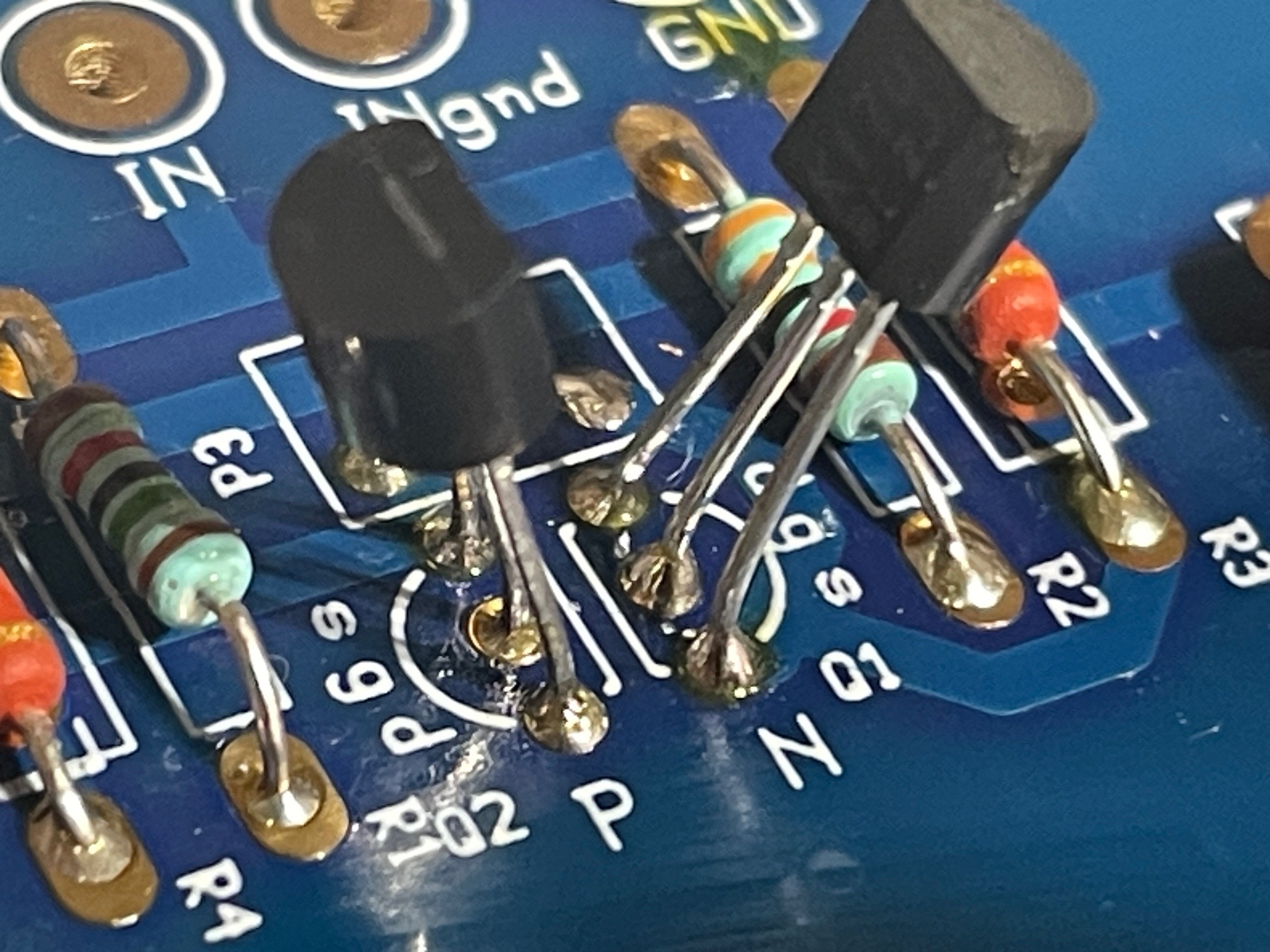

Hi all, and thanks in advance for taking the time to read my post. I am in the process of putting together an F5M using the F5 v3.0 boards sold in the diyaudio store. I used the schematic and info provide in post #70 in the F5M kit thread that provide detailed info on values and I checked and they are absolutely correct. I thought I implemented that exactly on the F5 v3.0 boards, but each channel is failing the dim bulb test (glowing very bright, r7 and r8 hot immediately), and I am at a loss as to why. Continuity testing is not showing me any issues, but I am certain if I apply full power, I'm going to see white smoke.

Observations:
- Power supply tests out fine with +/- 27 vdc. No issue with bulb test. I’m using the universal board from the store with an AS-4220 (had on hand)
- Jfets were purchased new from the diyaudio store
- Tested resistors before soldering and confirmed values
- Tested mosfets, and v+/-, inputs/outputs for short to ground , none found
- No solder bridges or cold joints I could find
- I am getting .57 vdc across R7 and R8 with both pots turned fully counterclockwise as soon as power applied. Exact same reading on both channels
- The LEDs on the power supply do not light when either channel is connected to power. I assume this is because of excessive current draw from channel board

Thank you for the quick replies. I will check both items. One comment on PS and rectifiers. Off the PS board outputs, I am getting +27 vdc between v++ and ground and -27 vdc between v-- and ground, so I assumed that was good, but will definitely check connections. Thank you again!
Thanks for the suggestions, but no luck on either. I took one channel, reversed both pots orientation, and same behavior .... Power supply LEDs out when channel connected and .55 vdc across R7 and R8. I also checked the power supply and rectifiers wiring. All checks out. With channel disconnected, LEDs on power supply board are both on and getting just about +28 vdc between v++ and grnd, and -28vdc between v-- and grnd. I disconnected the rectifiers and I'm getting 19v from trans on each pair of wires(blue/green), which is right for as4220. When I reconnect the channel and power supply, LEDs on powersupply go out, .55vdc on R7/R8, and things get hot fast. This is on the bulb tester. Full power would probably cook it in a millisecond. Pots are fully turned counterclockwise. I am stumped.

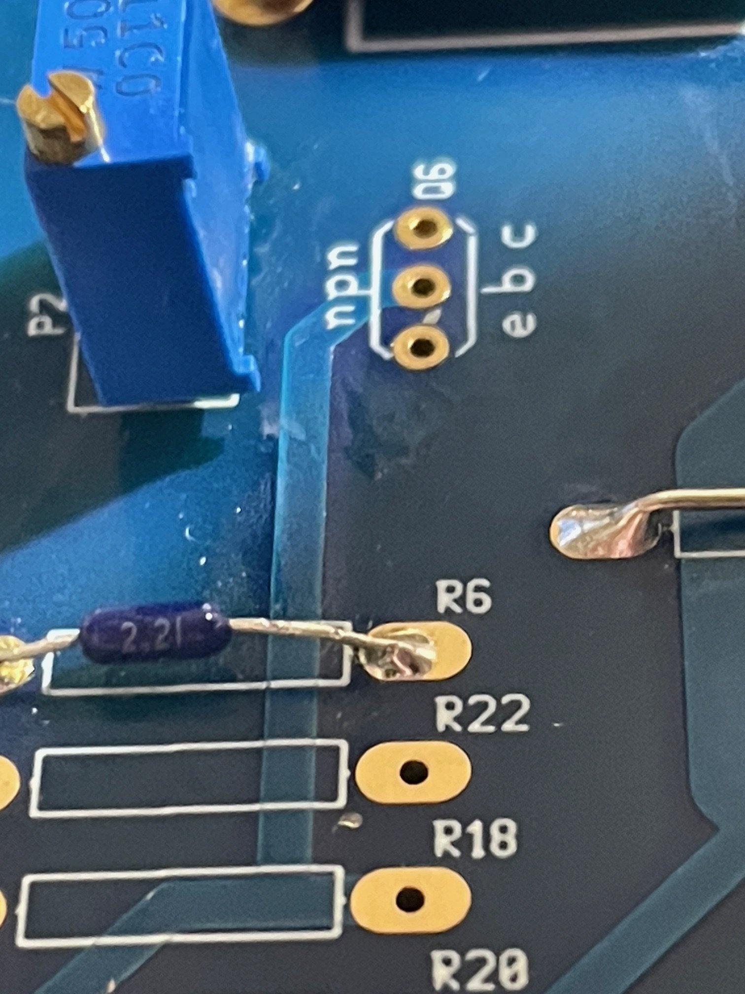

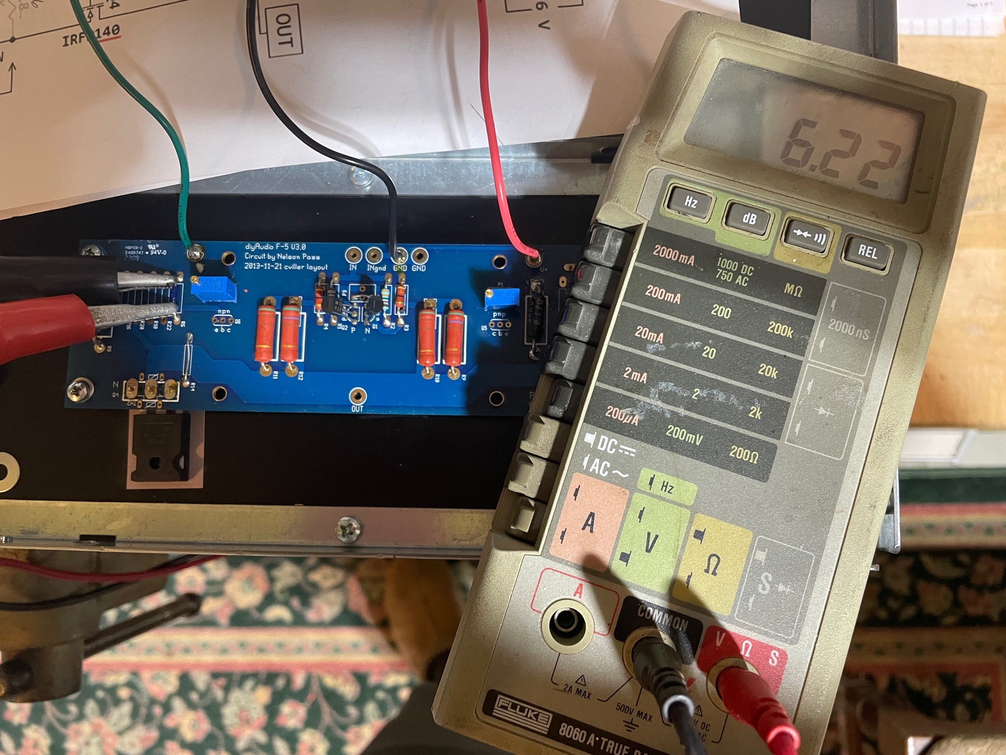

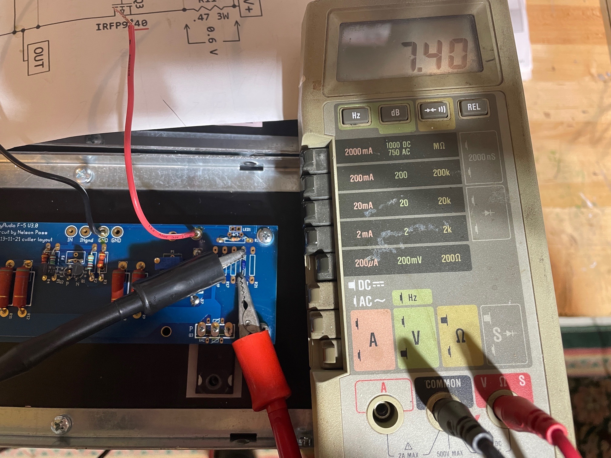

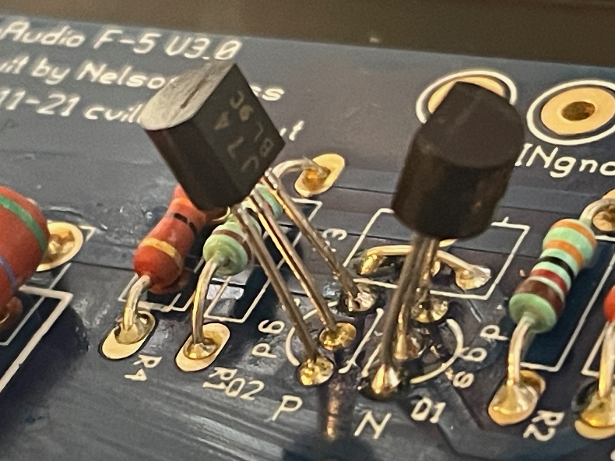

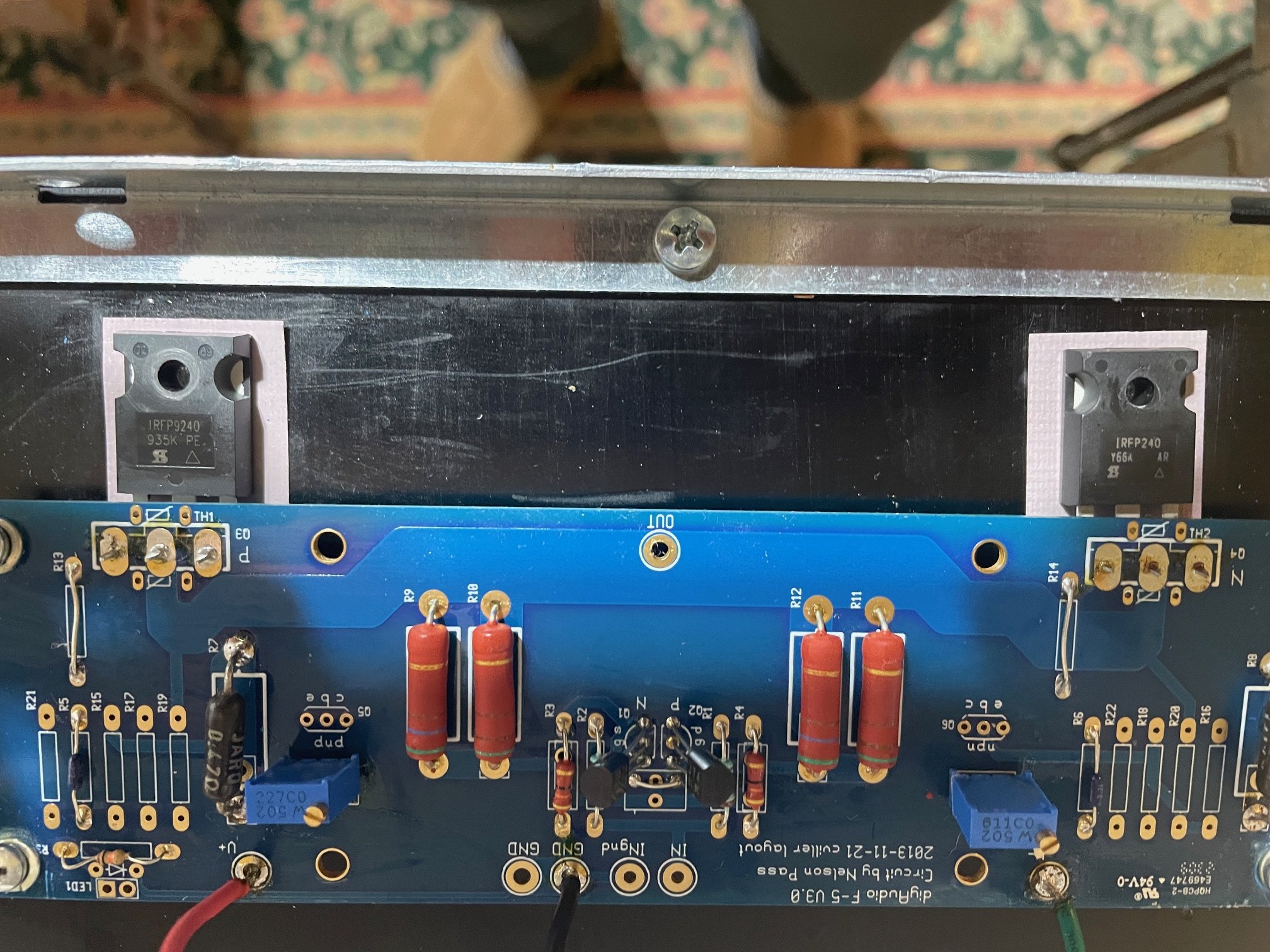

Hi, thanks again for the suggestions and feedback.
- Q1, Q2, Q3, Q4 were in correct positions and orientation. In my initial post, there was a typo with my list. I reversed Q3 and Q4 part name, but they are
in the correct positions since I stuffed boards
I also rechecked each component for short to heatsink, none found. Basic continuity testing shows placement of components matches the schematic from post 70 in the F5M kit thread. No solder bridges found and I reflowed anything that looks even remotely suspect.
One thing is certain, when I initially power up first test using dim bulb, the pots were set wrong. That has been corrected. Now when I power up for a quick test, bulb still glows bright, but I measure .22 vdc across R7/R8 vs .55 vdc previously. However, R3 and R4 get very hot fast (under 3 sec). I am sure they would last more than a few more second. The LEDs on power supply also still go dark when a channel is connected. I think I've made some very basic mistake yet cannot find it. I am now considering the possibility I damaged some parts with initial bulb test. I sure hope not the the jfets. I have some mosfets.
I added a few more pics.
Thanks again for all your help and feedback.
- with pots set right, 7r across R5 and R6 and both confirmed to be 2.21k
- no pins on Q3 or Q4 are shorted to heatsink or the machine screws on the board
- 7r Q3 gate to V+ and 7r Q4 gate to V-

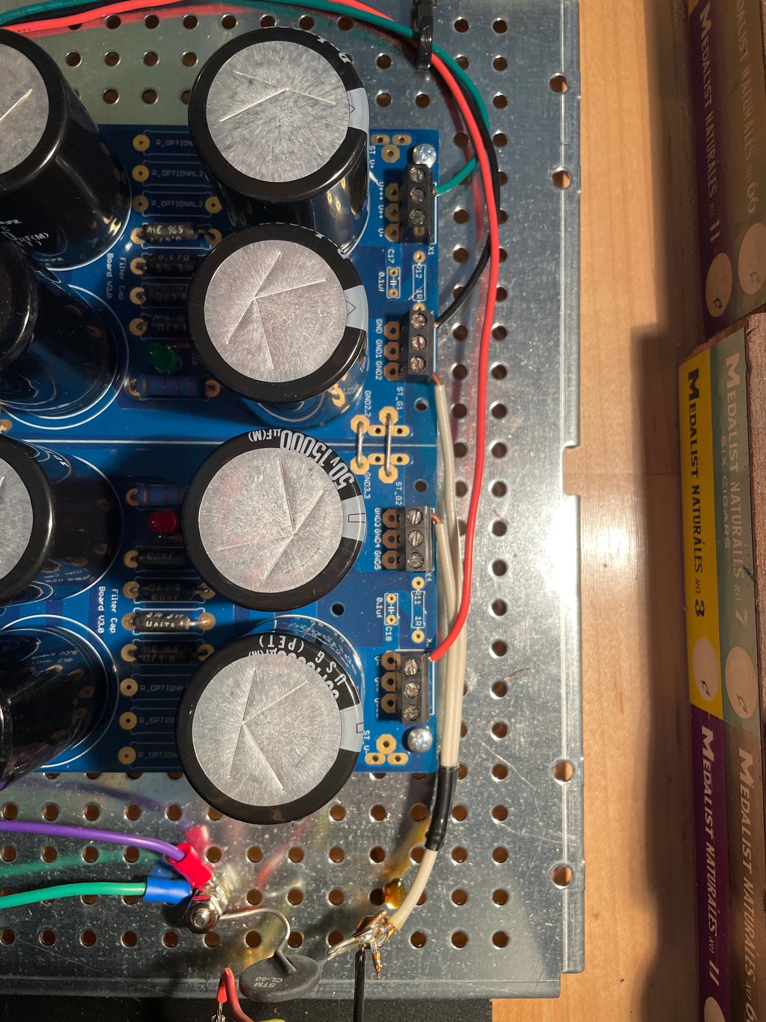

Red wire is to V- on PSU.
Green wire is to V+ on PSU
Red wire is to V+ on Amp PCB
Green wire is to V- on Amp PCB
Top photo and bottom photo.
He's saying the power supply leads are reversed to the amp boards.
See the V---- label, and the V+++ label, next to the terminals on the supply board?
They should go to the amp board V- and V+ respectively.
Maybe it's wrong to both amp boards, maybe just to one. Check both carefully.
I'm not saying anything of the sort... I wrote what I meant.
I can't see where the wires go... As an example, in the 2nd picture the wires are disconnected.
What I would do if I were the OP is double check my DC wiring from PSU to the board(s), but I was just stating an observation.
I think you are right, since the amp board photo in post #14 has the red wire connected as positive.
Good catch.
Good catch.
You are 100% correct! I prewired the boards for testing. I also prewired far side of case for later.... but unknowingly reversed wire color by accident from PS outputs. When I began to test, I was positioning heatsink/board next to power supply outputs in photo but was matching color to far side of case when hooking up. I totally missed it.
I just tested a channel, with correct wiring, and dim bulb is out. I'm more than a bit embarrassed, but grateful for everyone's help.
