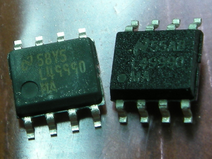

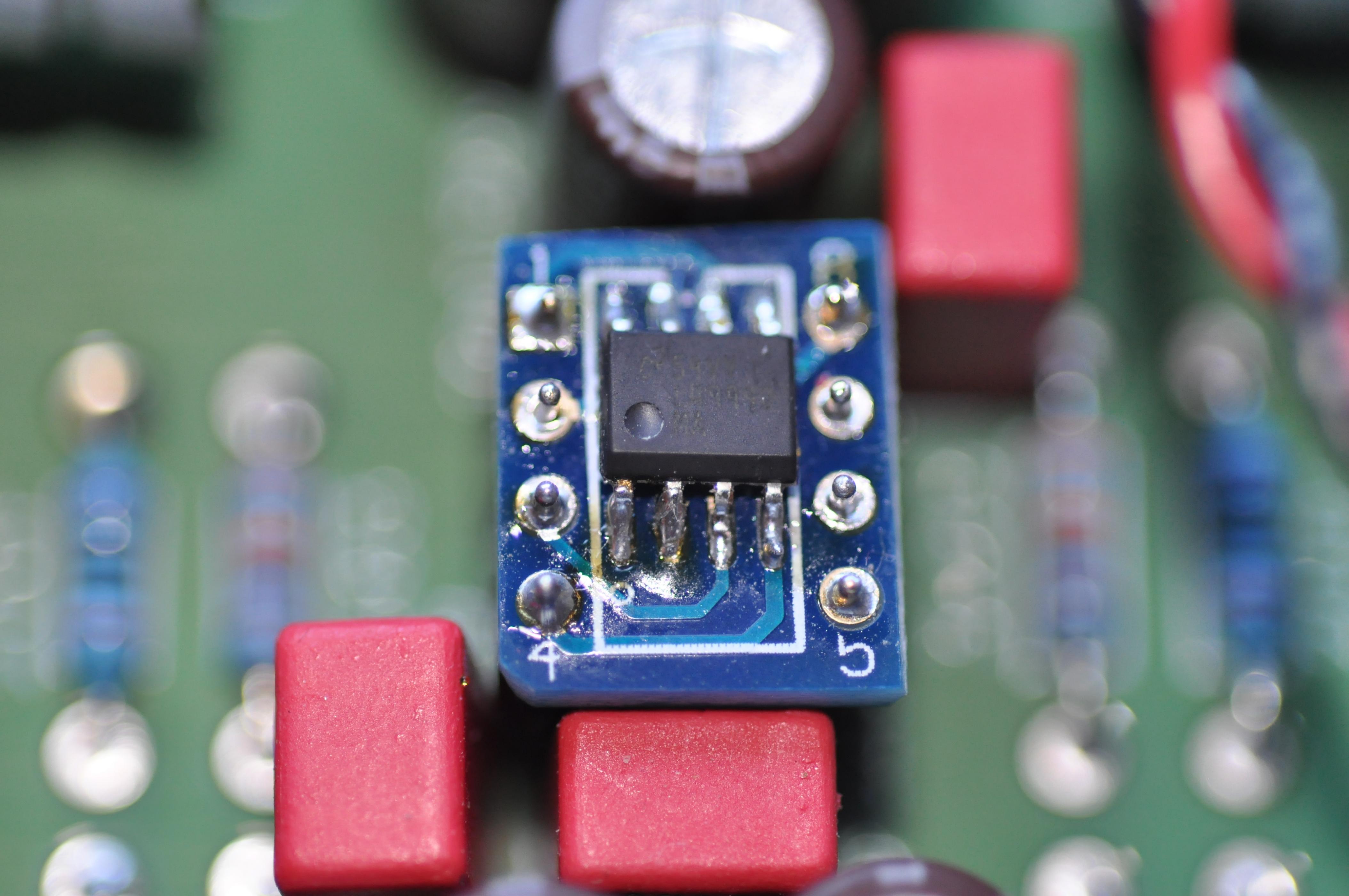

A warning to all - there are now fake LME49990MA on the market.
Purchased from an eBay seller as dual DIP adapter board.
First glance - the chip has NO PIN1 markings at all, not on the top or the side, nowhere.
Also noticed that the font for 999 is wrong, original has no curve at the bottom, the fake one is a bit out of focus but has a curved leg on 9. Don't own an original one to compare but the logo seems fatter than original too.
I was brave enough and gave it a measure too. The datasheet says quiescent current is 9mA typical Vcc = +-15V, this adapter has 2 of them and should measure 18mA. I measured 8mA.

"More efficient"? No, this is definitely fake. If any of the specs are not within datasheet limits, they are either counterfeit units (something else marked with the p/n) or factory rejects that 'escaped'. The fact that the marking is so poor -NS logo fat, characters not lined up neatly and no pin 1 indicator are telltale signs of counterfeit units.
NS tended to keep all their assembly and test in one factory, largely true after the TI acquisition. So one would expect the overall 'form/fit' of the marking to be consistent. Other companies like TI may use multiple factories or move production between more than one factory. In that case the marking styles may vary somewhat -- such as molded pin 1 dimple vs dot vs stripe across pin one end -- but still any marking will have neat, tidy and uniform arrangement.
The absence of any dip or recess indicating pin1 is a fairly strong indication that the top of the package has been sanded down to remove the original markings.
That's a dead ringer for fakery.

Just to update this one I got is original.
