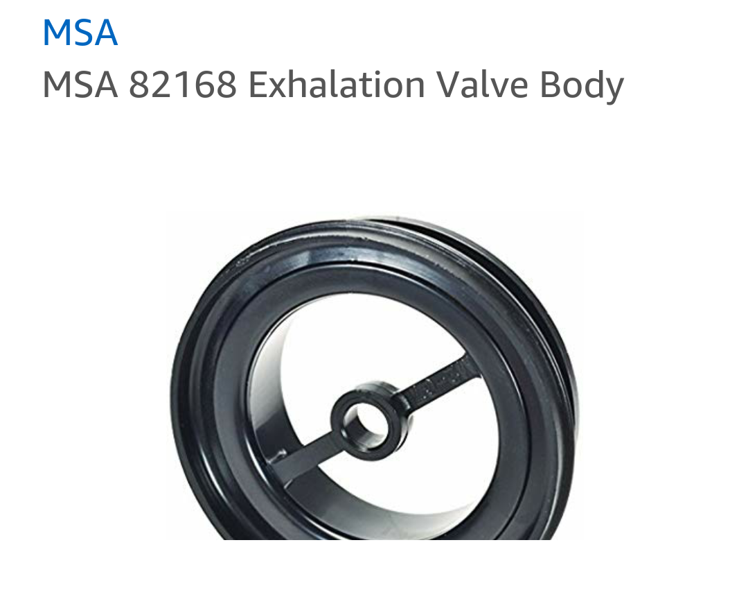

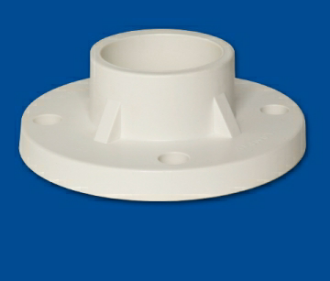

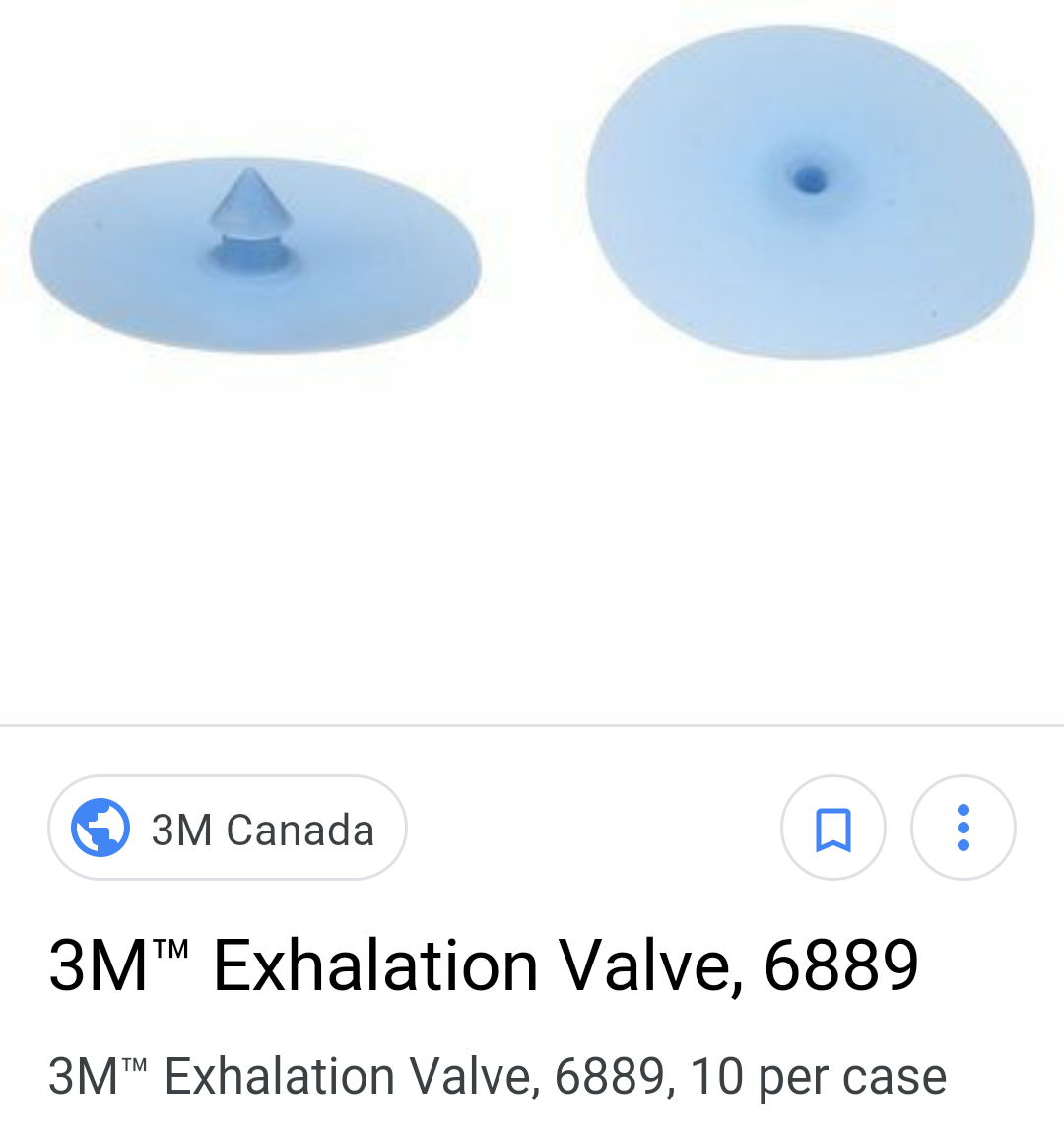

Ok since no one's interest was piqued when i mentioned forced passive magnet cooling, i will give a brief description.
You need (1) blank terminal cup 4" ×4", (1) exhalation valve body with flat valve, (1) pvc solvent weld flange, and a length of either pvc or flexible tubing to match the inner flange size and inlet of the exhalation valve body. Try to gey the exhalation valve body with the radial seat that has at least 4-6 arms (more even disc loading.
Attach flange to back of magnet centered over pole piece vent with small amount of high temp rtv silicone.
Drill terminal cup so exhalation valve body will fit snug and silicone it in, let all silicone dry 24 hrs. Mount terminal cup on enclosure at spot of your choice, i mount them on the back. Connect the pipe or tube between both.
I mount the exhalation valve body so the valve disc is on the outer side of the body so the air will be drawn thru the boxes port,into the magnet assembly thru the spider (or basket vent holes) and then it makes its way past the voice coil exiting thru the pole piece vent shaft.
Since the exhalation valve is basically a one way check valve,on every back stroke of the woofer cone it pumps the heated air thru the tube and out the back of the box venting the woofer.
Now theres several ways to do this including having the exhalation valve body reversed so fresh air is drawn from behind the box into it but thats up to you. Since the flat exhalation valve is silicone and very light it does not take much to move it and it opens easily and provides a good closing seal on the forward stroke of the woofer.
I have obtained sump pump check valves with the flat disc before ,so its easier to connect to the pipe/tube. Just make sure you dont use a swing type check as its too heavy for the air flow and won't work.
Keeps the coils refreshed nicely and is passive so no wiring.
I'll attach pics of the parts.
And oh yes , as andrew mentioned it will be minimally effective at fb so if you have a certain music genre you play,anylyze the low frequencies and tune the box 8hz lower than the predominant bass frequency so the magnet vent will be maximally effective.
And as well, its usually better to have a valve (1) size bigger than the magnet vent hole to lessen any noise, as a bigger valve body will let more air thru.
Experiment and try it.
