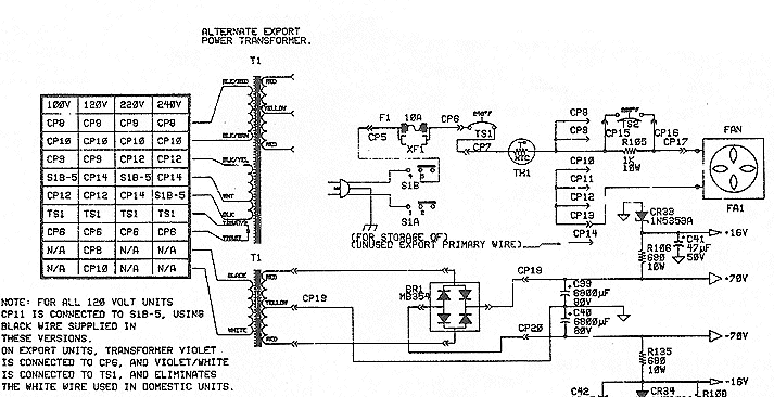

FWIW this is the AC fan used in Fender BXR300 Bass amplifiers.
Remember that contrary to Home Hi Fi amps, Musical Instruiment amps get *regularly* played full power,for hours on end, they NEED powerful reliable cooling.
They use an AC mains powered fan, a 10W series wirewound resistor is chosen so it noiselessly works when cold, just "moving air around", light duty, but a heatsink mounted Normally Open switch shorts the resistor above your chosen temperature, often around 70C (uncomfortable to finger touch threshold).
Not too clear copy, but circuit is SIMPLE anyway.
Am I correct in thinking that this circuit has three modes, one being Off when neither thermal switch is operated, then a low speed using the resistor when the first switch operates, followed by a higher speed when the second thermal switch shorts the resistor?

The circuit in post 13 has TS2 that shorts the 1k resistor series the fan when it is hot. That speeds the fan up.
TS1 is series both the fan and the transformer primary. It is normally closed and shows 246 deg. So when the application point (probably the heat sink) hits that temperature the power to both the transformer and fan shut off. The transformer drives the amp circuits.
Or use a changeover type themostat.
Most can be set for cut in temperature with knob and a setting screw,
When it cuts off, the bypass gets byepassed, giving mains to the fan, and when it cuts in, current goes through the step down device
