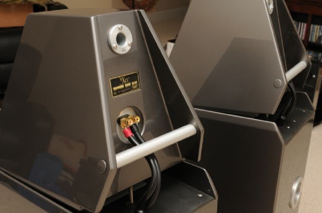

Are there any commercial, non pro, 3 way speakers that use a ported midrange ?
The Watt in Wilson's Watt Puppy is ported.
Hi Michael ... where did they hide the port on it? I can not find one in photos.

And who says you need to put the port on the front ?
Troels has done side and rear porting for mids.
