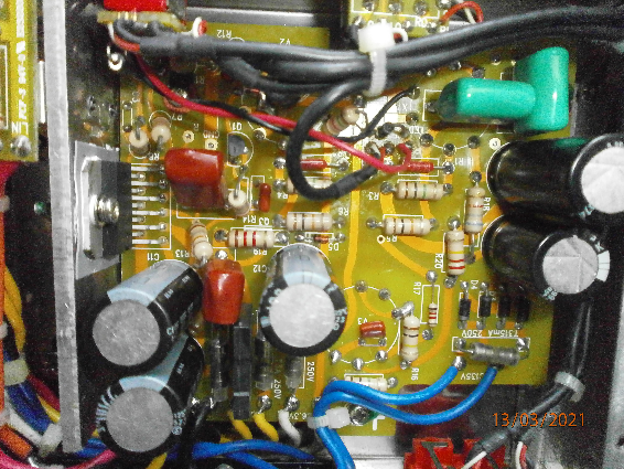

hello people...ive got this fatman itube mk1 13w per channel 😱 the problem is it sounds dull and distorted but when i touch my hand on the metal on the back of the phono lead and put my other hand anywhere on the metal casing it goes normal? strange but true, ive had it apart and looked for anything that could be shorting it out but it all looks good, theres no broken tracks or loose wires, any ideas? this is the first tube amp ive ever owned i got it cheap, when its on the metal at the top of the tubes has got small hole on it, any help or ideas would be greatly appreciated guys, cheers
Sounds like a bad earth,
Check the continuity between the phono socket and the chassis or to where it connects on the circuit board.
Has it got more than one input? is it the same on the other inputs?
If it is then check the selector switch connections.
NB make sure its dead before you touch anything. The amp contains high voltages.
Just a few things to try.🙂

RF oscillation?
Is this a genuine valve amp or a chip amp with a cathode follower in front of it?

Yes, just checked. It is not a valve amp. At best it is a hybrid but it could just be a valve preamp (not sure what circuit) in front of a solid-state amp - almost certainly a chip amp given the low price. You can't get 13W from a small twin triode and a magic eye!
The symptoms you describe are consistent with a grounding fault or RF oscillation. If the former it may be easy to fix; if the latter it gets a bit harder as proper fault-finding may be needed. Do you have a DMM and know how to use it?

Sure. An analog meter will work fine. Make sure unit is unplugged, caps are discharged, etc... Turn the function selector on the meter to ohms and test away for continuity.
well i took the amp aprt again only this time i took the power pack out, it loks like something has been spilt in there, not sure if that means its shorted out at some point?, suppose ile get the meter out and check a few things, moz

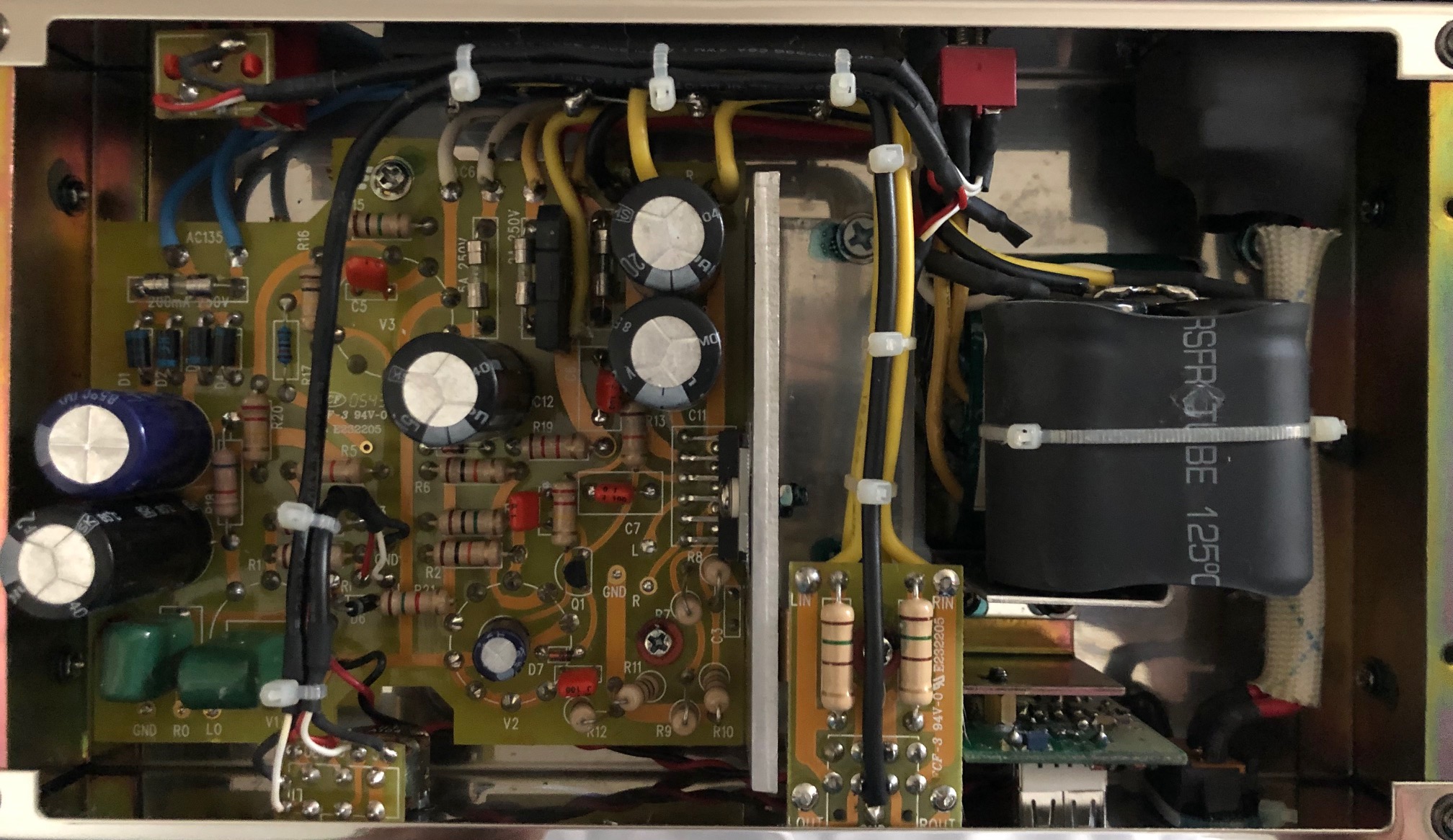

(A quick search showed several threads about the Fatman iTube including this one, so I'm posting here. It may also be of interest in the gainclone forum(s), since it's a tube-buffered gainclone.)
The Fatman iTube (OEM Dared, which also sold its own-branded version, the Dared MP-5) is a tube-buffered gainclone first introduced c.2005, to target the iPod market with a bookshelf tube setup. It became a huge success over the next ~15 years, selling over ~100k units worldwide to a market where it was often their first introduction to vacuum-tube audio on a budget.
http://www.enjoythemusic.com/magazin.../dared_mp5.htm
One of the Fatman versions landed up for auditioning a few days ago, and I must say that I was impressed with its form-factor, pricing, build quality, finish and durability. However, there were some minor drawbacks in its audio quality - very bass-shy (like a lot of tube gear) and with a fair amount of glare/brightness in the upper-mids (not uncommon in chipamps/gainclones). In other words, it had some of the faults of both vacuum-tubes and chipamps.
I tried to address the glare issue first, since I don't really need a thumping bass response (I don't listen much to heavy-metal, disco, hip-hop and similar genres anyway). I generally prefer neutrality, with full-bodied mids for vocals and so on, and the MP-5 seemed to be a great candidate for upgrades.
Opened it up, and noticed that almost all resistors were generic 0.5W CFR, and all electrolytics were generic Chinese 105c TL brand. I swapped out the electrolytics first:

Here's a pic of the circuit board after the upgrades:

I didn't find the schematic online. Attached some actual pics of my unit.
