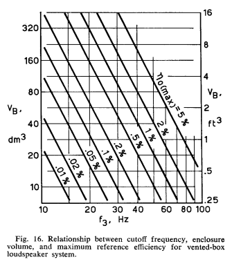

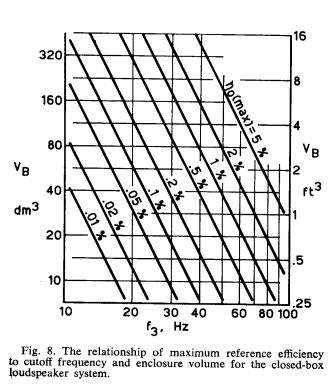

Finally slowed down at work and I could run some enclosure sims. The Faital 12fe300 does dig deep for a pro sound woofer, but the box is rather large. I know I said no box size restraints but at a certain point it seems a 15" would make more sense. Is 93db sensitivity at 50hz in 3 cu ft possible for a 12"?

Per the vented chart you can get ~3% eff. max = ~112 dB + 10log(0.03) = ~97 dB, sealed ~2% eff. max = ~95 dBIs 93db sensitivity at 50hz in 3 cu ft possible for a 12"?
