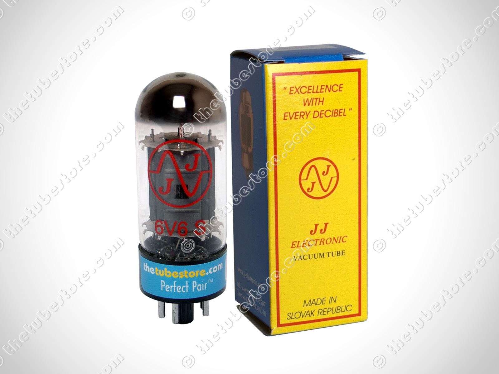

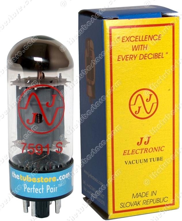

When I looked up old Tung Sol data sheets, the original North American 6V6 is rated at 12 watts maximum plate dissipation, while the 7591 is rated at 19 watts. Presumably the 7591 had a bigger plate structure....the JJ 6V6s tend to be more robust inside.
But, as you can see in the two attached photos, the JJ "6V6S" seems to have identical electrode shapes and sizes as the JJ "7591". Presumably both are re-pinned versions of some former Soviet-era tube, that originally carried an entirely different Russian/Soviet tube designation.
No wonder the JJ "6V6S" is more robust than a real 6V6 - its a 19-watt (or more) tube, masquerading as a 12-watt one.
I have a reissue '65 Princeton Reverb with 440 volts B+ (!!). I bought it second-hand, with JJ 6V6S output tubes. They can take the abusive B+ voltage, but seem to sound much blander (lower THD) than the other-brand 6V6 tubes in my other Fender amp, a Super Champ XD.
