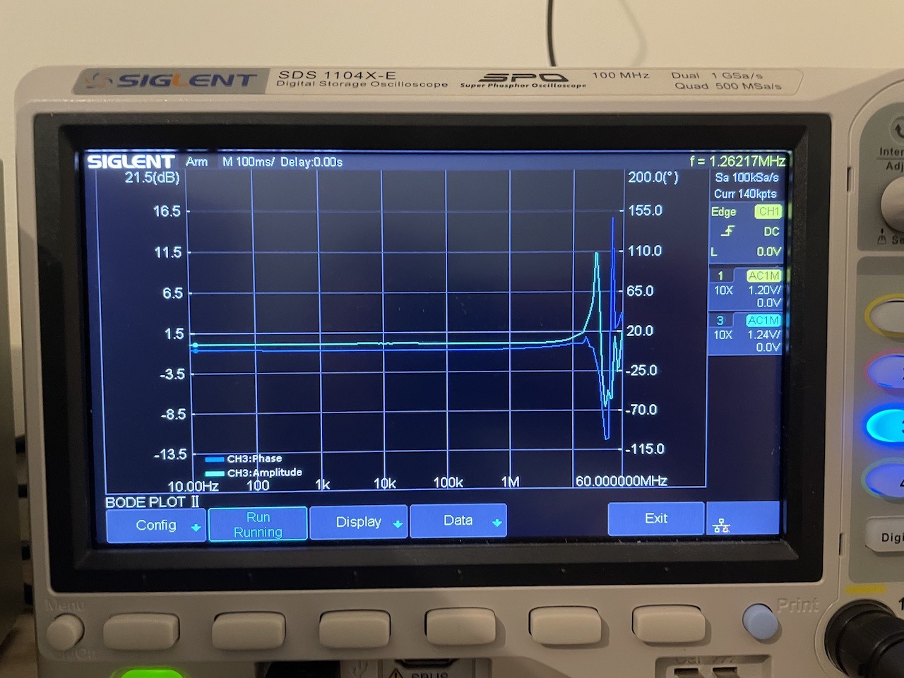

I will retry the experiment sometime later this week and post it up. This rolloff is assuming there’s no cable issue.Please post that measurement here.
This was a frequency response measurement of a high pass filter?
These are non-inductive parts. Which exact part number?
I’ll dig that all out. IIRC it was a 600V mouser US part: https://www.mouser.co.uk/ProductDet...u0LICSN1kag==&countrycode=GB¤cycode=GBPThis was a frequency response measurement of a high pass filter?
No this was a simple bode plot using a 10Hz-60MHz at 6Vac sine - the signal source cable was a scope cable but i have some 50ohm bnc cables currently sat “delayed” with UPS.

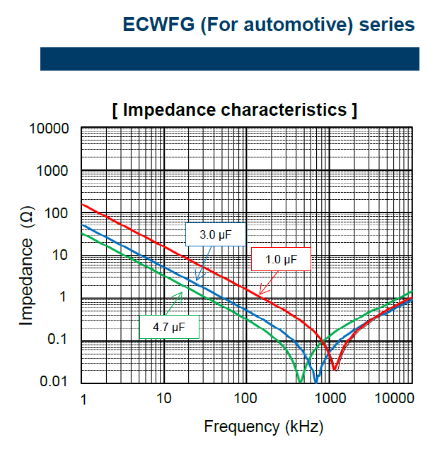

Place the cap on a bode plot. For example panasonic ECW’s curve drops like a stone after about 1khz. Good for power and not for full range audio.
Panasonic's film capacitor catalog includes this graph for their ECWFG product. It's a Bode plot of impedance vs frequency. Looks like a textbook excellent capacitor with very little series resistance, all the way up to the self resonant frequency where lead inductance ("ESL") begins to dominate. No funny business at 2 kHz whatsoever.

Ok, so now the new RF cables have arrived, I have a a few connectors try. I also found the banana plug cable I'd been using for grounding had a fuse connector inside but no fuse (it's a green cable.. it just so happens to have an inbuilt fuse holder).
Anyway - the cap seems to be working normally whereas before repeated attempts showed a bend down after 1Khz to the point it would act likes LPF so I'm guessing something else was configured wrong - my fault:
Perhaps the moral of this story is - if it's unexpected check the experiment setup, only then when all options have been exhausted, then call it a result.
