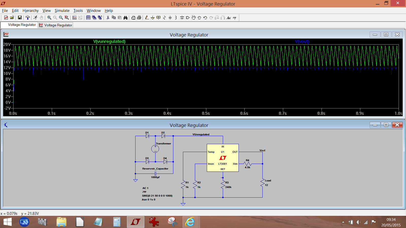

I plan on building a couple of Power Regulators using the trusty old 78XX Voltage Regulator. The voltages for each regulator will be 5 and 12V Output. The amperage required for each project will be a fraction of 1 Amp. The power supply will be a linear power regulator of 9 and 15 Volts (for the 5 and 12 Volt Regulators respectfully).
For filtering caps, placed after the diode rectification, how much filtering capacitance will I need for a 5 Volt DC Regulator Output based on a 9 Volt Secondary AC Output, and for a 12 Volt DC Regulator Output based on a 15 Volt Secondary AC Output to eliminate ripple and supply voltage to the Regulator Input? I understand that too little capacitance will not smooth out the DC voltage during the AC Cycle. I read on this forum that too much capacitance can also be undesired as well. I am not totally rehearsed as why too much capacitance can have an ill effect - perhaps on the diodes or the transformer itself? However, from the Youtube videos I have seen regarding voltage regulators, not many worry about this.
Should I also add capacitors between the voltage regulator output to the load input to keep voltage smooth?
My only tools are a DMM and an LCR Meter, so I don't have an oscilloscope to measure any type of ripple, or noise coming from a diode.
If there is a formula I can use to pick the right amount of capacitance for my voltage needs, what would it be?

The most effective way to reduce the ripple pre-reg is to use CRC or CRCRC I think you will find that with a CRC you can get much better ripple reduction with less capacitance than with a single C. eg I would say 1000uF 3r3 1000uF would be better than a single 4700uF or even a 10,000uF.

Large first capacitors decrease the conduction angle forcing high current flow for short periods within the cycle. The current decay waveform may promote transformer ringing and put stress on other components.
1mF per ampere of load is about the minimum.....................If there is a formula I can use to pick the right amount of capacitance for my voltage needs, what would it be?.....................
Many will use 2mF/A
really low ripple is seen (on a scope) when 5mF/A is used.
Pre-amps may use as high as 10mF/A

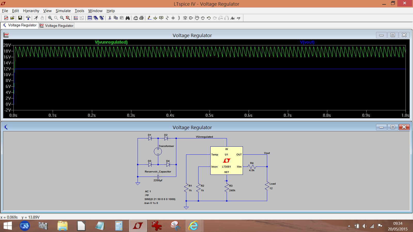

This shows it all graphically. The circuitry to the left is the transformer, the bridge and the reservoir cap. To the right (the yellow box) is a 12 volt regulator. Just imagine that is the 7812. The load resistor set at 12 ohms is pulling one amp. The transformer is set to be a 15 v rms type.
This shows the ripple for a cap value of 1000uf (note the regulator output is being affected by the ripple falling below the regulators minimum input voltage).
Next we have a 2200uf cap. Now the regulator is fine because the input is always higher than the regulators minimum voltage requirement.
I've attached the sim file so you can play around and see what happens (click my signature line to see how to use it).

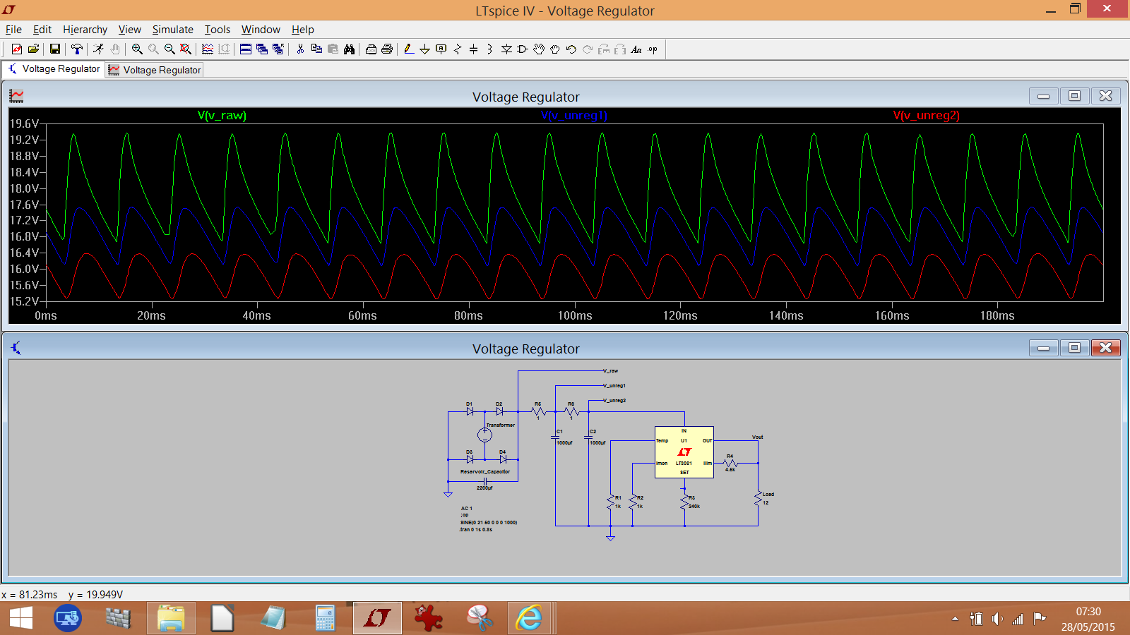

I'm not so sure there is any specific formula for all this. You have to decide what the maximum allowable volt drop would be across the combined resistor network at maximum regulator output (so the reg doesn't drop out and so the resistors aren't dissipating to much unwanted heat) and also what your maximum wanted or allowable ripple voltage would be.
For 78xx regs with a max current of 1amp you could generalise and say a 1 ohm series R would only 'lose' 1 volt.
Here is our simulation again, this time with 2 ohms series resistance. Look at the ripple at each point. You have to decide the ripple values that are acceptable to your design brief and then design the filter to give those values.

Notice TWO effects.
1. the peak to peak value of the ripple decreases as one progresses through the RCRC
2. the curves become more rounded due to attenuation of the HF content of the ripple. The sawtooth with sharp corners has a very high proportion of HF in the basic 100Hz ripple.
The sawtooth with rounded corners has less HF content in proportion to the now smaller 100Hz ripple.
Now to the capacitors.
I would use 2 off 470uF for C1 and 2 off 1mF for C2.
The extra ripple current capability of the 2*470uF will help with keeping them cooler. It's the first C of a rCRC or rCLC PSU that suffers the highest ripple current.
The last C is split into 2 to give a lower output impedance than a single cheap/normal 2mF electrolytic. It's this last C that meets the majority of the transient demand of the load. This gets towards your
