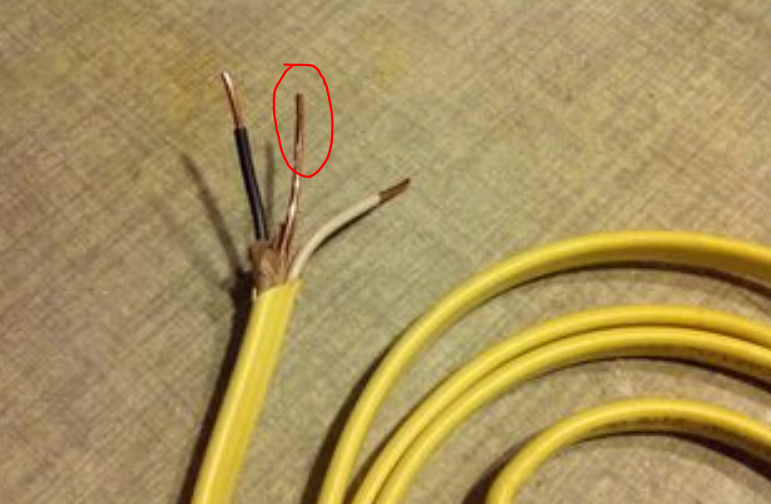

You could wire the specific for-audio power outlet(s) back to the power meter box via separate feeds (to individual C/Bs); use individual ground wire (NOT daisy chained). Just specify fairly thick multi-strand (litz) ground wire (NOT solid core). I suggest having 2 outlets wired in such a way - one will be for the noisy devices powered by the SMPSs (like TV/PVR/noisy SMPS power packs...), and the other only for the true analog audio equipment (analog pre-amps/amps). This will make a huge difference to the overall sound quality reproduction. Electricians usually use cheap stuff, like solid core neutral and phase (which is okay), with another solid core for ground (NOT okay... does not do much at high frequencies... can't couple that rubbish to ground (well, to neutral at the power distribution box).... add a separate thick multi-strand wire. This will still be fully compliant (DC grounding) with the wiring standards. Here's the wire I'm talking about - see that ground lead... that's the one to avoid:

This is something that I had wanted to do when I was setting up my shop/office. I ended up not doing it as I was unsure where I was going to place things. Now that I have a goo idea where everything will be I could have the electrician make one run configured like this.You could wire the specific for-audio power outlet(s) back to the power meter box via separate feeds (to individual C/Bs); use individual ground wire (NOT daisy chained). Just specify fairly thick multi-strand (litz) ground wire (NOT solid core). I suggest having 2 outlets wired in such a way - one will be for the noisy devices powered by the SMPSs (like TV/PVR/noisy SMPS power packs...), and the other only for the true analog audio equipment (analog pre-amps/amps). This will make a huge difference to the overall sound quality reproduction. Electricians usually use cheap stuff, like solid core neutral and phase (which is okay), with another solid core for ground (NOT okay... does not do much at high frequencies... can't couple that rubbish to ground (well, to neutral at the power distribution box).... add a separate thick multi-strand wire. This will still be fully compliant (DC grounding) with the wiring standards.
So the ground wire would be 12 AWG stranded, but I run it outside of the 12/2 jacket from end to end? Is that right?
