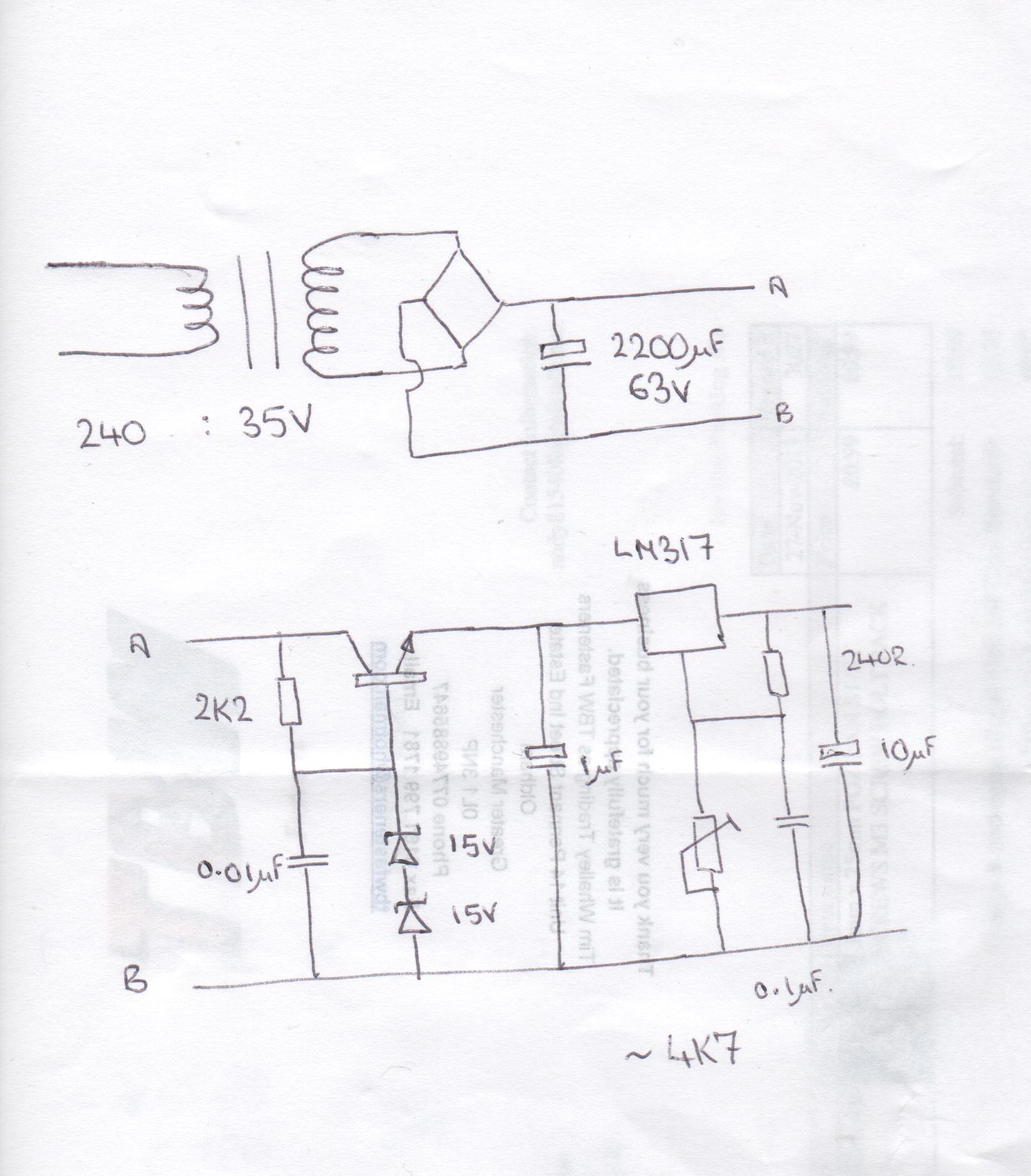

At this power why not simply buy a 240V / 35V transformer.
Pre-regulate the rectified mains with a simple Zener & Transistor to bring the voltage down to 25V DC.
Then feed the 25V to your LM317.
At 240V the regulators will be dissipating 4W at 100mA.
At 100V the transformer will still be kicking out 15VAC which will still give the regulators Headroom to operate.
This method becomes very inefficient as the power goes up but is still valid.

@KatieandDad, that is a very interesting suggestion and I truly appreciate the schematic you drew up. I am going to explore this. I'm a little worried that the power dissipated given the current draw might be a little too high for practical heat sink sizes, but I could be wrong.
