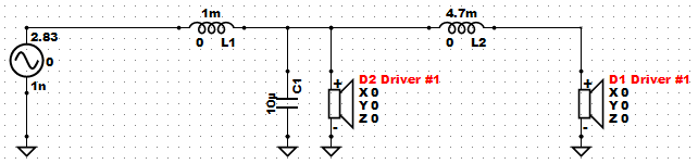

One way would be to use VituixCAD.And how do we calculate the crossover network for them assuming a second-order filter, L2 and C3, is used?
Below is a model of the above circuit. I've gone and chosen some representative values. The drivers are each a pure 8-ohm resistance, and they have a flat frequency response in the 5Hz to 40kHz limited simulation bandwidth supported by VituixCAD.

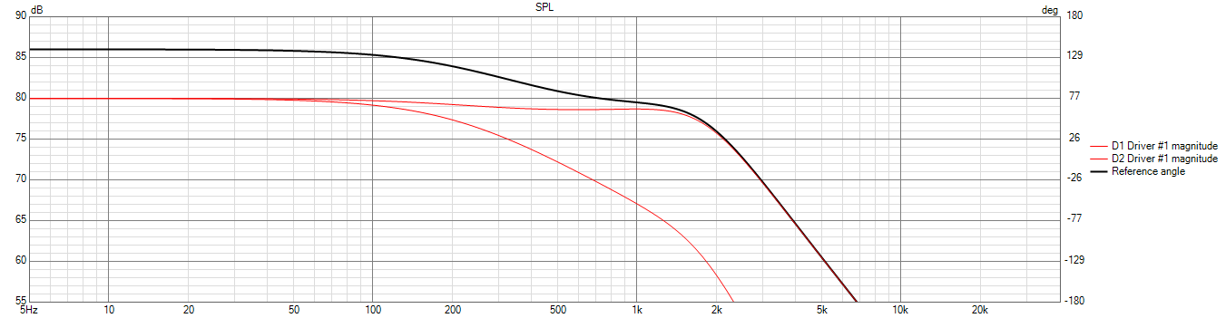

The resulting summed response (black line) is shown in the frequency response plot below. The filtered responses of drivers D1 and D2 are also presented (I was unable to change their individual colors for some unknown reason; any assistance would be welcome).

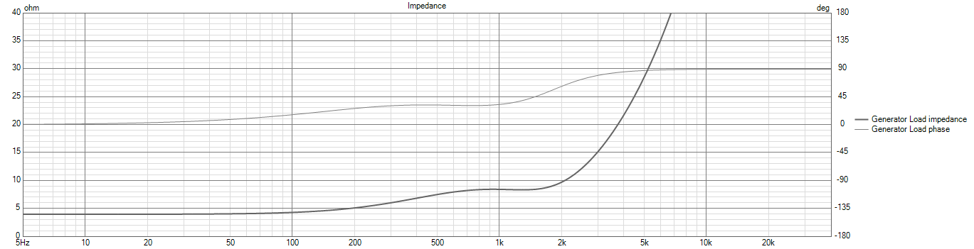

The resulting impedance curve is shown below. Notice how we have a 4-ohm load below about 100 Hz, as the two 8-ohm drivers are connected in parallel.

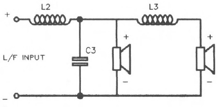

Assuming you're not on OSX (in which case an emulator will be needed), how about simulating it for yourself with one of the several free software programmes out there e.g VituixCAD (as above) XSim, PCD, WinPCD? That way, you can try all this and many more things for yourself.Typically, two 8-Ohm drivers connected in parallel will give 4 Ohms of impedance (and resistance) on the speaker terminal.
If the paralleling driver is inserted by an inductor, L3, how will the impedance (and resistance) be seen/measured at the terminal?
Colors are linked to the drivers, so if you want different colors you have to add another driver (D2) with the same frd/zma files of D1. If you simply copy the driver in the crossover tab - like you did - you will have D1 twice.I was unable to change their individual colors for some unknown reason

The impedance across the terminals of the circuit in post #1, can be made to appear like a resistor equal to R/2
(with R = the impedance of both drivers), by adding a series RC across the input terminals of the circuit.
The resistor of the series RC is equal to R, and the C of the series RC network is equal to L3/R^2.
Then use the second order filter circuit in post #3 with a resistor equal to R/2 in place of the circuit in post #1 with the RC network. So you have L2, C3, and R/2 for the circuit, and the standard formula (or calculator) can be used.

The two circuits in the diagram are the same in performance (signal voltage across C3).

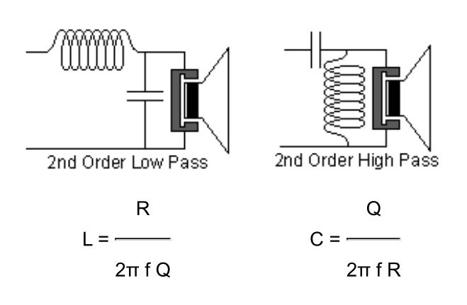

An example of what I was looking for is something about this.
I think it would be relatively useful for any DIYers who are going to build a 2.5 ways crossover, like me.
