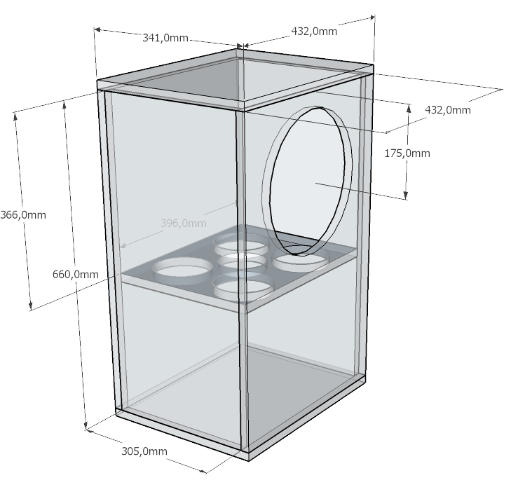

Just build a sealed box that matches the speaker datasheet box volume.

78 litres per 12 inch driver.

For Steve Creswell's 78L box, here is a drawing i did from the dimensions he gave. The brace holes dont need to be circles, whatever is easiest to make. Drawn for 18mm ply (or MDF i guess).
It should be quite simple to construct, you could probably get the panels cut by a local carpenter or possibly home depot. The driver cutout is the most complicated part of this build, you need either a router with a circle jig or a jigsaw and a steady hand.
Thank you, evry one I will read this ! 🙂 Oh really thank you for the plan/schema !
