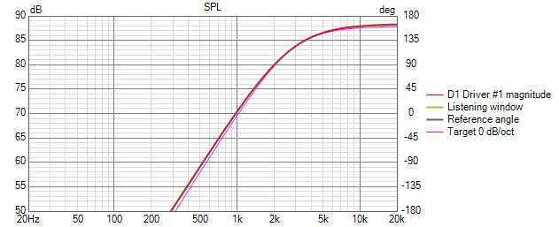

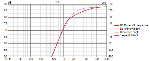

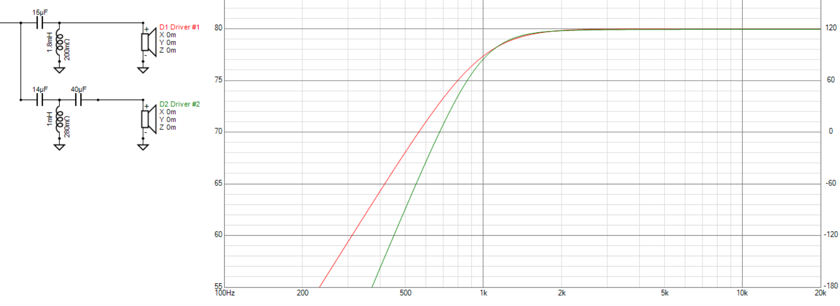

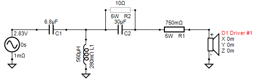

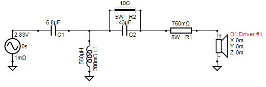

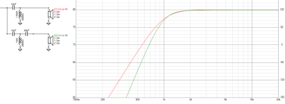

Sesbe is correct, that is a resistor, not a capacitor. If you trace out the schematic with each switch position you will discover there are just three levels of attenuation of the tweeter level. The adjustments will not change the slope of the XO, just the level and a modest adjustment of the crossover frequency. If you want to change the slope of the XO by changing just on component you will need to do some rewiring not just replace the resistor with a capacitor. I did two simulations for you, VituixCAD doesn't have a switch so I just used a resistor and open and short it. I don't think this will work very well, switching the cap in and out does change the slope, but also switches the XO frequency from 3200 hz to 2500 hz which would make a mess with the midrange. Also the 2 mH shunt inductor on the the tweeter in the schematic could be a mistake because it must be much a lower value.
Perhaps presscot intends to place the capacitor there to change to third order. In that case the indictor would have to move to a position between the capacitors.
