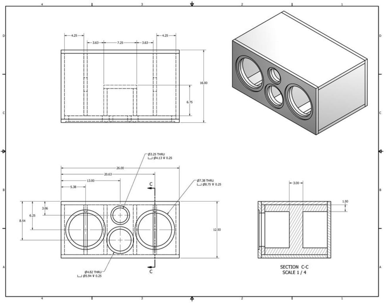

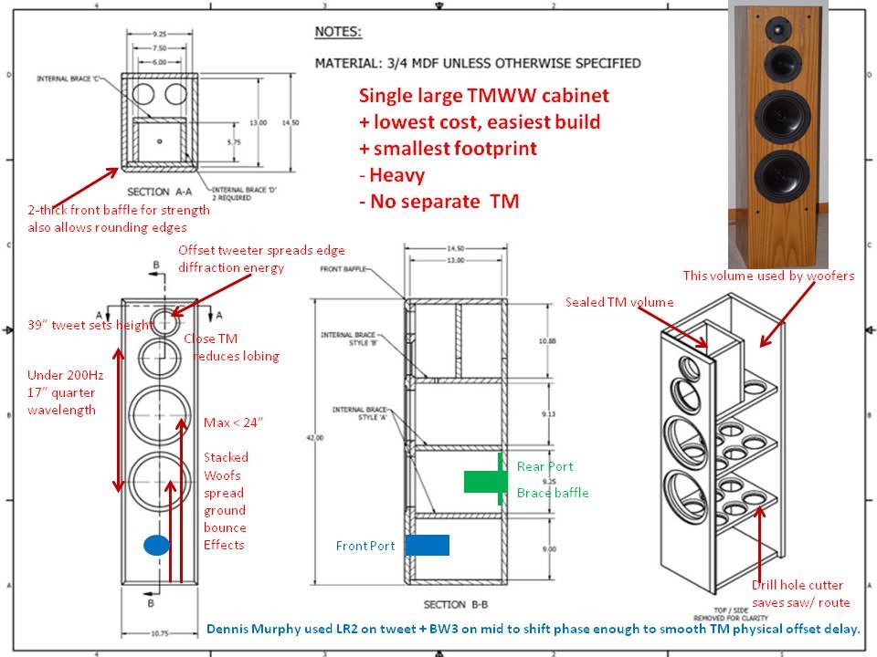

I have attached my CAD drawings, which were made to show my brother how they will aesthetically look when they finished. For reference for you all as well.
Anyways, I would greatly appreciate any support and help in where to start in the mathematical side of design.

OK??...Firstly, is this to be used solely for watching movies & the likes?...or is it for music, of all sorts also? There is much overlap between the two.
Second, the severe lack of footprint area is of concern. Some 20 years or so ago, I had built something almost identical (Dual 6 1/2 inch, woofer, single tweeter DeAppolito configuration)...and it was OK, within its severe limitations.
But the pair were hard pressed at high volumes, & always seemed pushed to their limitations. This current fad of the tiny floorspace WAF tower configurations should be taken with a grain of salt...if your truly serious about sound reproduction, cast that 'slim-tower' out the window...make the room for a serious pair or don't.
Third, are we going to go two-way, three-way...four-way? Do you want to try to be "high efficiency", or are we going to be able to throw large amounts of power at it?
Remember, high power levels (200+W) equals relative higher costs & complexity(separate components). On the other hand, high efficiency brings lower costs & more flexibility.

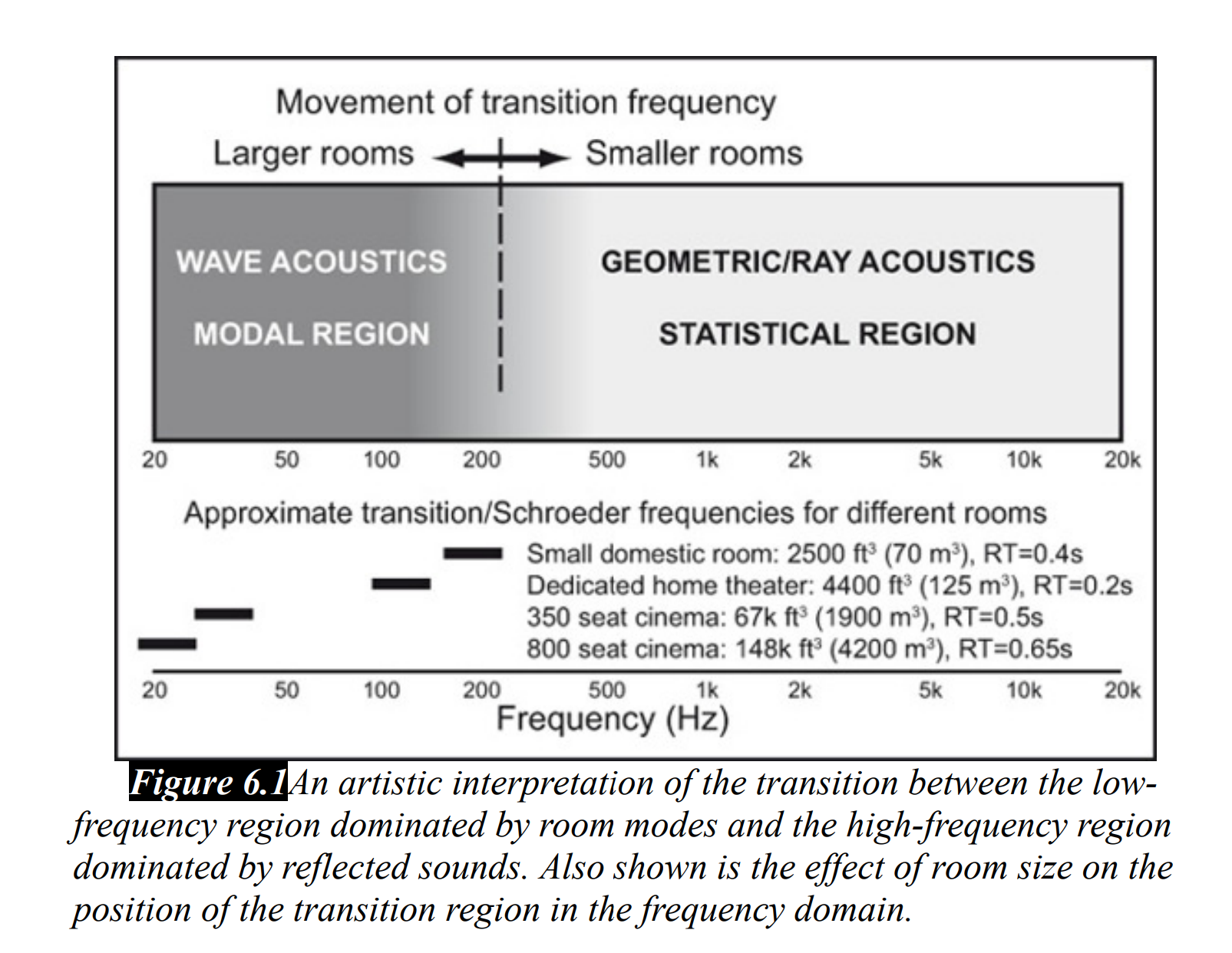

You probably already know about the small room transition frequency but I posted an image because it's important. And because it will save you from building huge front, side, and rear speakers.

I designed them slim to meet the desires of my brothers basic design request. I have also seen speaker manufacturers make these slim style speakers and have heard them in a system. Working very well, I was shocked. For example the Klipsch tower speakers.
These speakers are going to be for everything, movies and entertainment, as well as all types of music.
I am going to go with a two-way design and I do think my brother will be pushing these speakers too hard.

In terms of your cabinet designs, the CC looks the most problematic. I think you are going to need more height to fit appropriate drivers, if those are 2 mids they are better off closer together and I don't think you will need 4 of the woofers; 2 will probably suffice. But that all depends on design criteria and then driver choices.
MTM could be a good choice for the L and R but without a sub and for other reasons stated above, I think I'd be going 3-way. But again, depends on all the design criteria you decide upon.

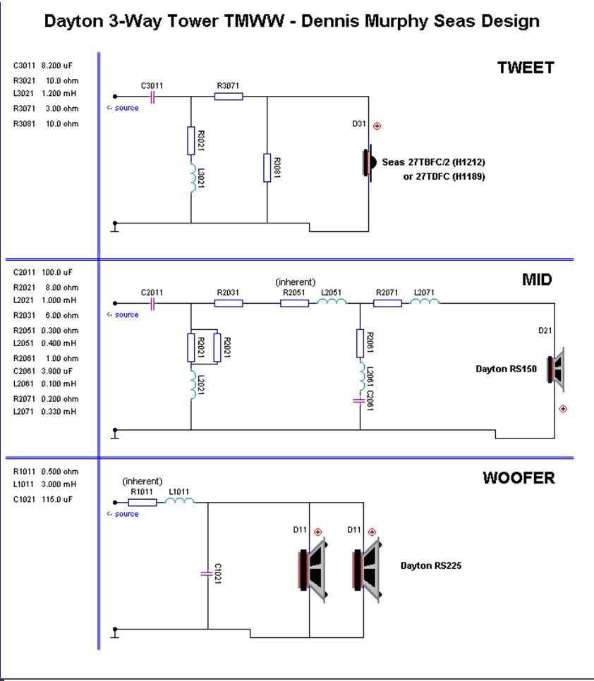

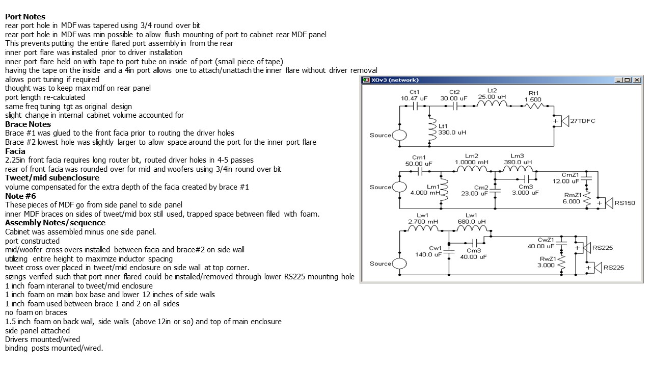

I would favor spending today's budget and the wood-work effort on a full range(30-20kHz) 3-way stereo pair of TMWW front speakers. 1"dome + sealed 6" midrange + two ported 8" woofers = a popular balanced topology. Tall 10" wide cabinet to support the volume required by two ported 8" woofers. Commit to great sound, or just go to CraigsList for good used HT speakers. Matching center + rear speakers can be built later.
Dennis Murphy in the htforum documents a TMWW using low cost Dayton drivers. The center channel W-T&M-W used a modest sealed volume vertical T-M stack with one 8" woofer on each side. A ported vertical T-M stack is more common.

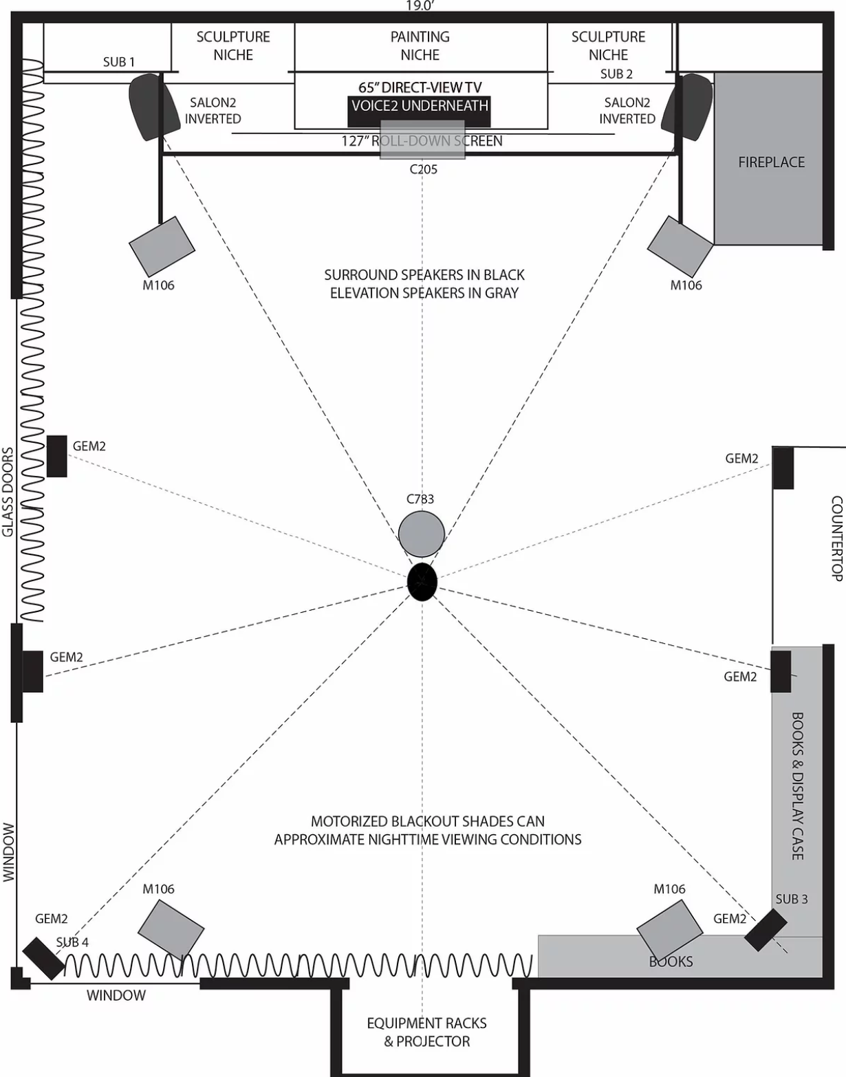

Great HT needs impact, plus crisp details to identify direction and height. Several positive reviews recommend the medium cost aluminun cone drivers from SB_Acoustics. A step above the Dayton drivers. I would favor these drivers.
=1" dome SB26ADC-C000-4
=silver cone SB17NAC35-4 or black cone SB17NBAC35-4 midbass
=silver cone SB23NAC45-8 or black cone SB23NBAC45-8 woofer-pair
The woodshop capability often sets the design direction.
1) simple cuts with about 0.5" radius on front baffle edges
2) stepped front baffle for T-M time alignment, and 0.5" radius on front baffle
3) Avalon style truncated pyramid front baffle
There are good passive crossovers available, but a DSP crossover could be part of your career in the audio industry.

First of all, thank you all again for such great advice and guidance. Since graduation and now covid, I have never been on an online forum for advice. So, this has been encouraging with so many audio fanatics and engineers willing to lend help. I have definitely been convinced to go with an established speaker design, which is honestly helpful. Realizing that my experience level is not where it should be for a too ambitious design at this stage in my life is humbling. I will be saving that for later, thank you wrankin.
Also, I do want to say that my shop capability is not limited in any fashion. I have been a woodworker since I was young. My grandfather had a great shop in his garage I did projects in when I was young; I have worked construction in remodeling for my Uncle; and have been doing various woodworking project for friends, family, and consumers for a long time. Even though it might not seem like a long time for some since I am only in my 20s haha. Though there is always more to learn!!

Yes! I have been reading that article, chipping away at it. While it is quite lengthy, it is very good and pretty helpful. Thank you for the reference!!

For the rest of us rubes, as you mention HT receivers have a built in measuring and eq system that tries to correct for all the differences I just mentioned above anyways. So yes, if you've got a clean design slate to start off with, then sure try to match the front soundstage as closely as possible. But you are starting with a bunch of different drivers that you already bought and so don't sweat the small stuff - just do the best job you can to match FR's and then let the receiver correct for any discrepancies that might exist.
Re box tuning: it's all about each driver's TS parameters, although you do have some flexibility within those limitations. You've got the LDC. Read or re-read chapters 1 and 2 on closed and vented box alignments. Or read and re-read post #5 in the 'Building Speakers from Scratch' thread and then play with Unibox until the light bulb goes off. Input all the drivers you have chosen into the program and hopefully the numbers I used in my last post should start to make sense.
Re BSC (baffle step compensation): I've given you 3 links that deal with the topic. I don't know what else to say beyond you have to put in the time and do the reading to get it. And again play with one of the simulators until it makes sense and then play with it some more. Given your situation, I would design for the full 6dB of BSC for all your speakers and again, let the receiver do the corrections if and when they are necessary.
Just a correction: HT receivers don't tune the room, they simply eq the speakers to a certain target FR.

As you read more about baffle diffraction hopefully you should figure out that even if you put all the same drivers and xo's in the L&R speakers as the CC, the front baffles are going to have totally different dimensions (usually) and so the FR won't actually be the same. To get decent voice matching, the CC xo's have to actually be a little different than the L&R. Doesn't hurt though if the xo point(s) are the same.
And lastly, you are leaving out the room. How each speaker interacts with its closest boundaries and objects will also change the perceived FR at the listening position. In this respect, it's almost not worth worrying about HT voice matching unless you use the exact same speaker (drivers, xo's and dimensions) in every position in the room and the room is a properly dedicated HT room that has been correctly treated acoustically.

Could you post a link of the available passive crossovers for this build?
There is a long thread on htguide.com for Denny Murphy Dayton TMWW. Thread includes amplifier suggestions. You will need to join the forum to view this info.
HTGuide Forum
- First-Timer Home Theater Speaker Build
