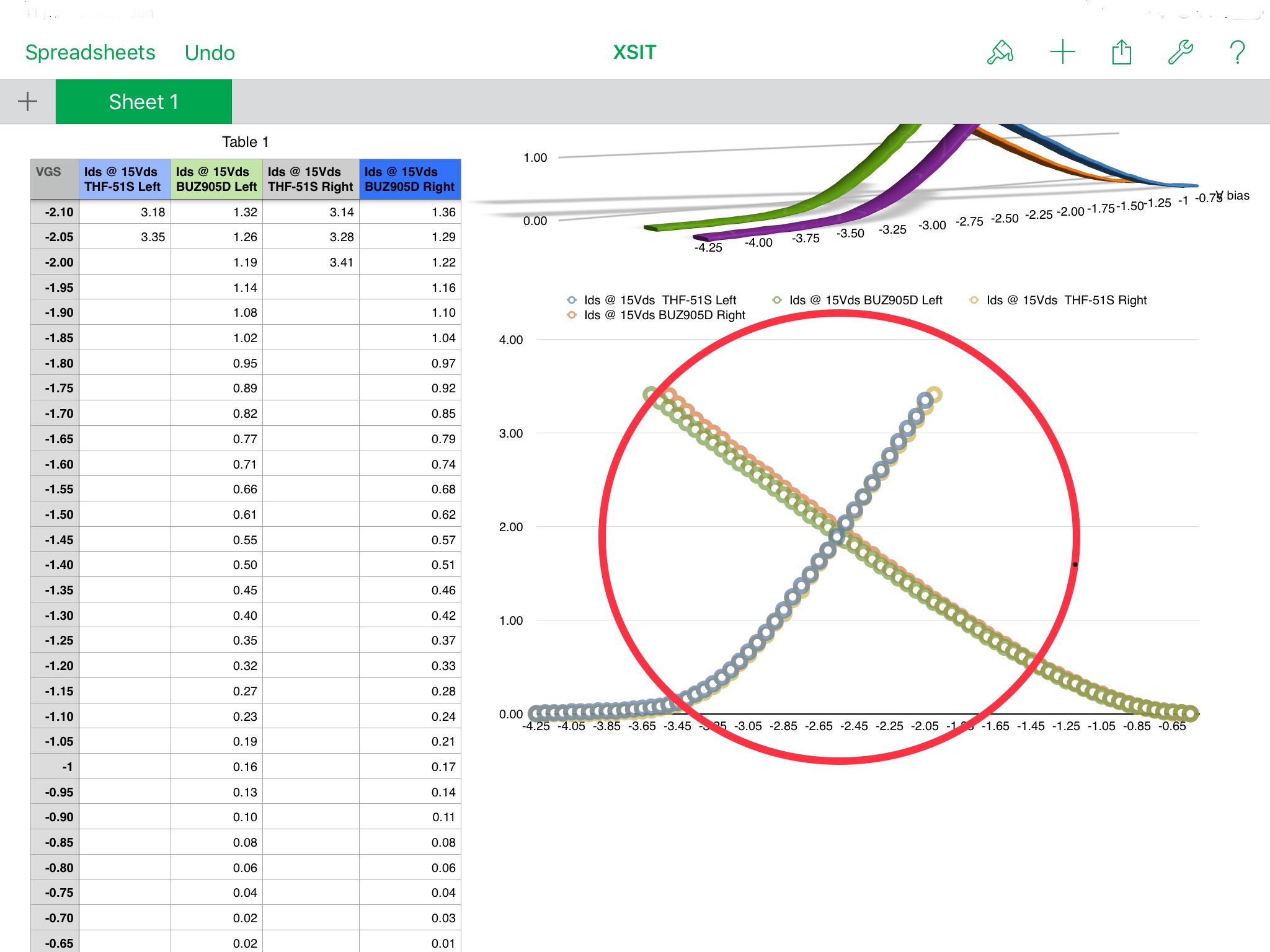

why it was desided to give the amp so little gain?
The lower the output power, the less gain is required for full output from a typical source.
The rated 18W is 12Vrms into 8R, so the 12dB gain (about 4x) gives full output for 3Vrms input.
All the voltage gain in the amplifier is provided by an audio line transformer connected
as a 1:4 step-up (4x = +12dB). That's all the voltage gain available without adding more
active circuitry, which would have been in conflict with the design goals for the amplifier.
XSIT
Does any of you know why it was desided to give the amp so little gain? Cheers!
Dear Guérilla,
I don’t own an SIT-3, it would be great if we may have an answer from Mr Pass.
I guess that’s all we have had, due to his intellectual property and company’s policy of how much information that can be revealed.
Fortunately from his kindness, we are able to have a circuit diagram of the DEFISIT and photos from many reviewers.
Few of us having successfully built it and enjoying the heavenly sonic signature of this unique topology.

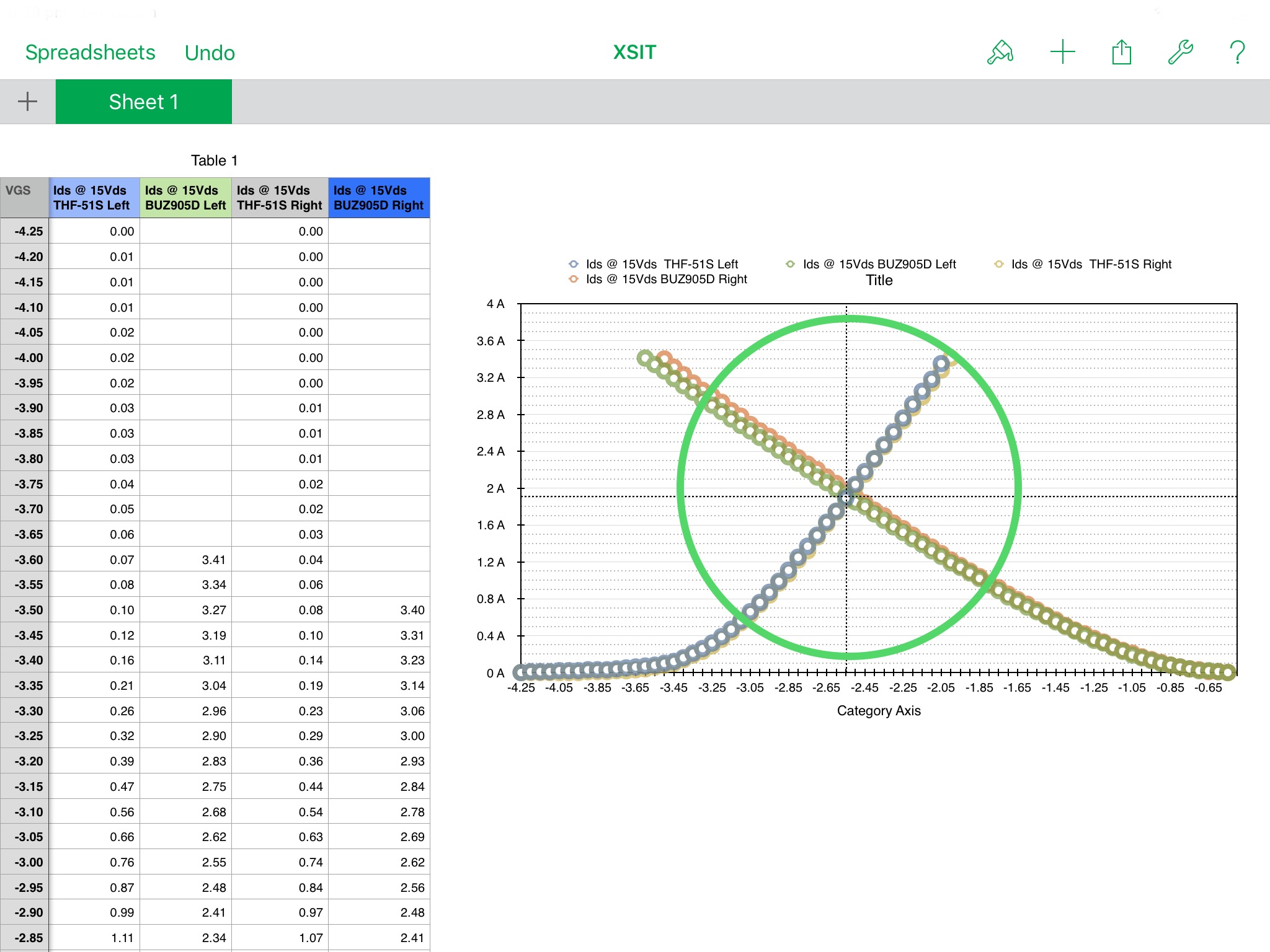

Based on my “cloning” I may have an answer that would satisfy your question, but it is related only to the THF-51S.
The little gain is due to the pinch off voltages of the SIT’s gate and the P channel mosfet complementary. Once the gate voltage reach the pinch off threshold, the amp ceases functioning due to Ids is dropping to zero.
The little gain becomes more and more tiny due to non linear response near the pinch off area, in my case another half a volt from pinch off to an acceptable distortion level.
In conclusion, my SIT-3’s clone can only produced an excellent linearity within 1volt of gate swinging from a selected bias voltage.
Hope that would help, and please bear in mind, mine is not an SIT-3.
Cheers.

As pointed out earlier, the gain figure came from the transformer, and I
didn't feel like using an active voltage gain stage.
3 volt rms into the high impedance input will clip the amp at 18 watts into 8.
Of course the output stage is simply a follower - you can drive it with some other
circuit without problems.
