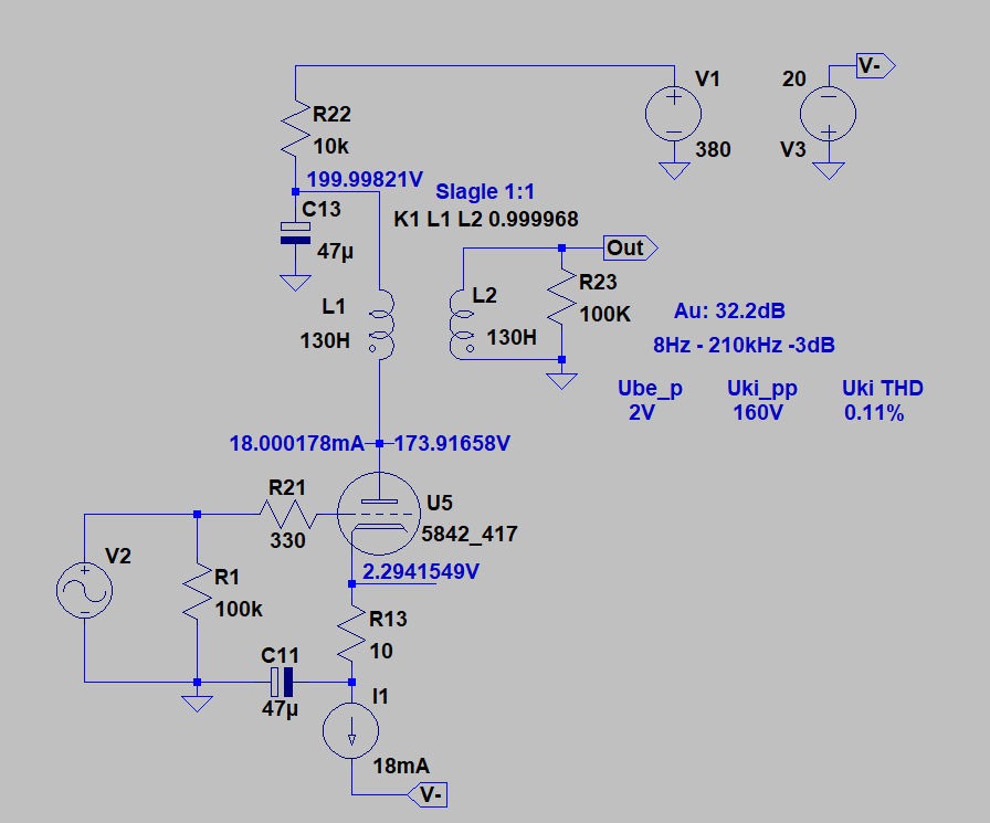

If I was to do this I would use a 10 ohm or so resistor for the cathode resistor and either feed that about 200 mA through a larger resistor or CCS circuit. The idea is to create a 2 volts fixed bias VOLTAGE on the cathode with only resistive or high impedance (the CCS) connections in parallel. Yes, this is a serious waste of power but it can work.

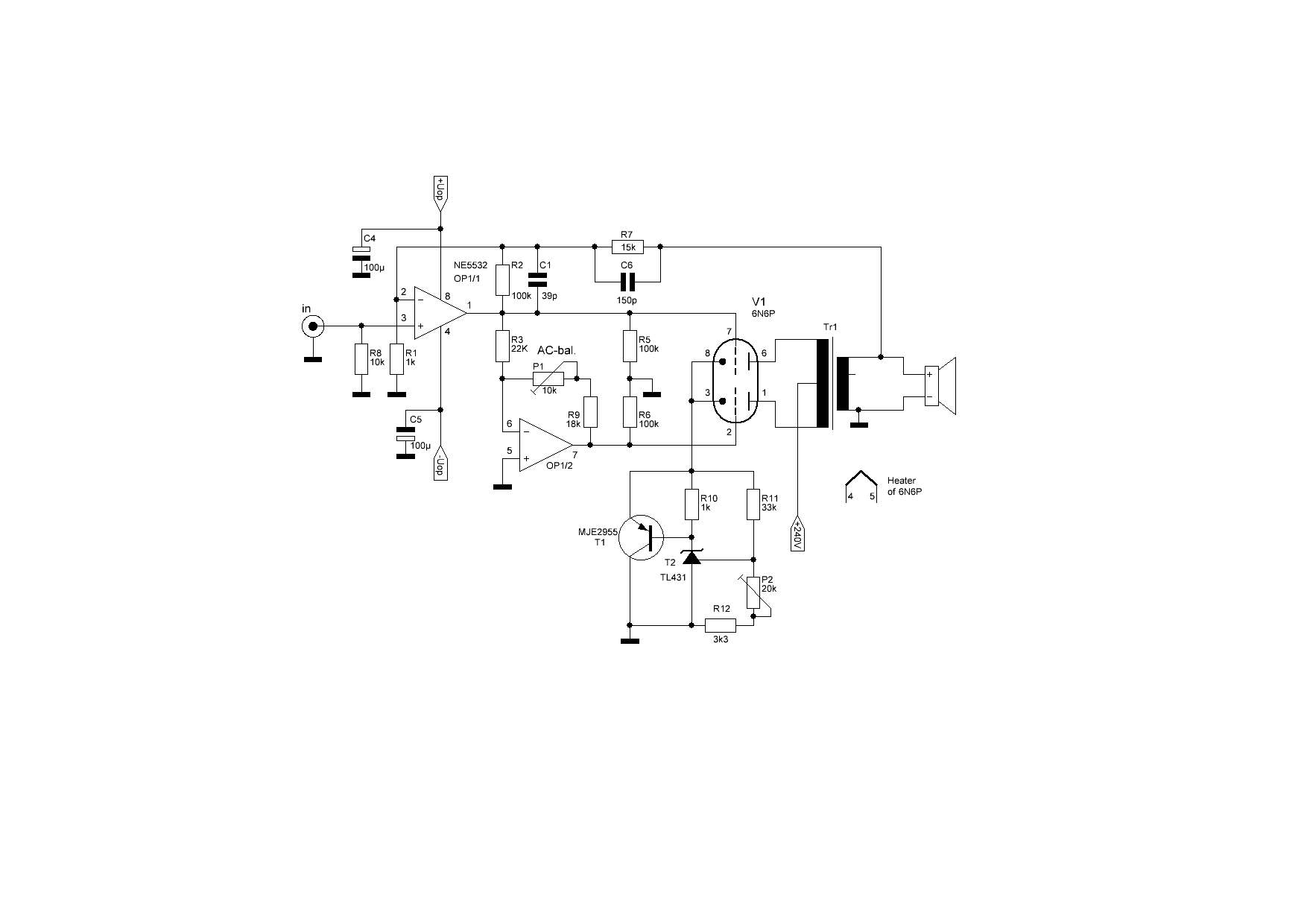

I once tested the fixed (but adjustable) cathode bias with attached arrangement. There the TL431 is adjustable and drives MJE2955.
I've tried a very similar circuit, and it works great to bias the power section in a 6360/GU-17 PPP amp I've built. To work in this case it must be connected to the negative rail, since there is no headroom if the TL431 is connected to ground. Vref alone for TL431 is 2.5V.

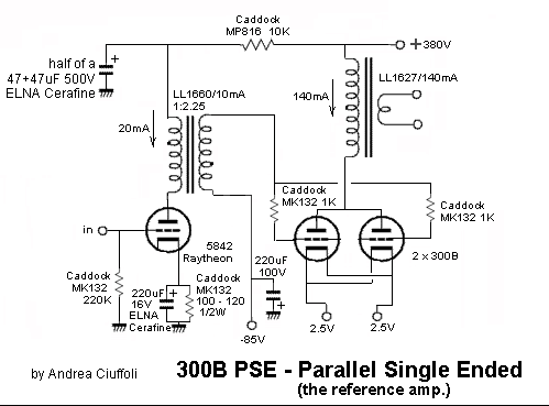

The 5842 has about 300mA of heater current, IIRC. So you can feed the heater with a quiet 300mA current source, and include 6.2 ohm resistor in the cathode.To achieve that, my idea is:
Reduce the value of the cathode resistor to 10 Ohm (Instead of 100 Ohm).
I have used this method on driver valves and it works and sounds very well. Certainly better than LEDs.
I believe that these methods (LEDs vs. heater current vs. cap bypass) were audience tested at one of the ETF triode festivals, to the advantage of the heater current bias. Maybe someone who was there can confirm.

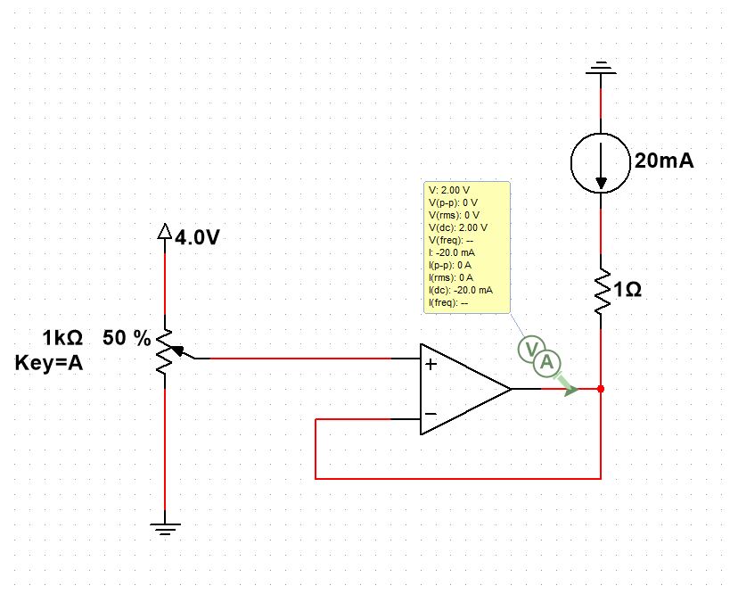

A general LDO can't handle a +2V output while sinking current. They're designed to provide source current.
So if you want to use an external source providing voltage directly to cathode, this is what you need.
An OPAMP with Class AB output stage can provide +2Volts with -20mA output current. Some Series Voltage References can also provide sinking current capabilities.
And by the way, a fixed -2V bias could result in different cathode current across tubes, so the adjustment section is necessary, especially for high Gm tubes. Unless you've tested your tubes previously. The 1 ohms resistor is placed to examine the current.
A 10 ohms resistor provides a large bias current can work. But I think an OPAMP can provide symmetrical response to both positive and negative transients, or CCS with a low value resistor which provide constant impedance across frequency, will be better than a biased low noise LDO.
