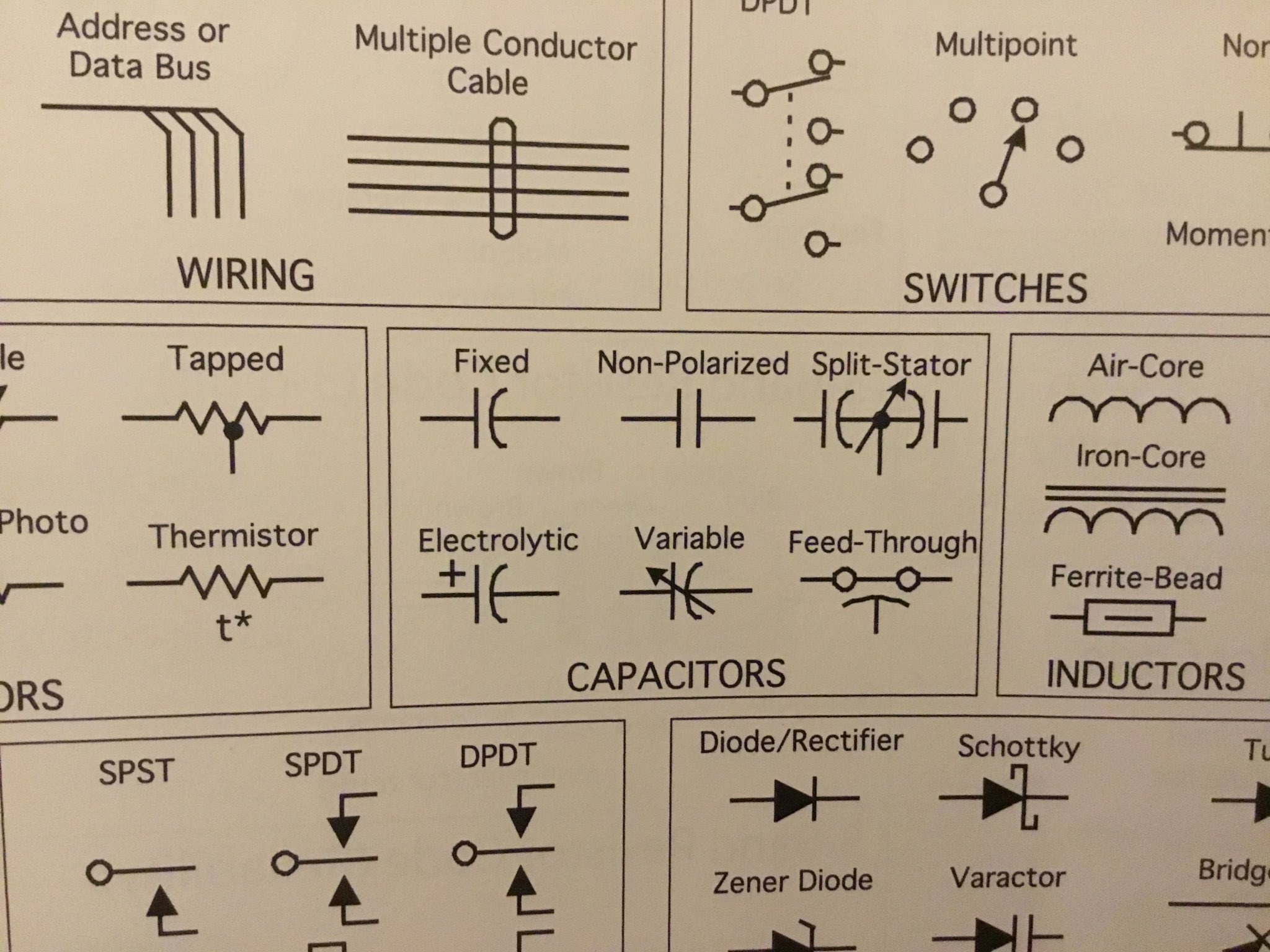

What is the difference between fixed and non-polarized capacitors? I’m slowly learning things and can’t find it, other than how it’s represented on a schematic.

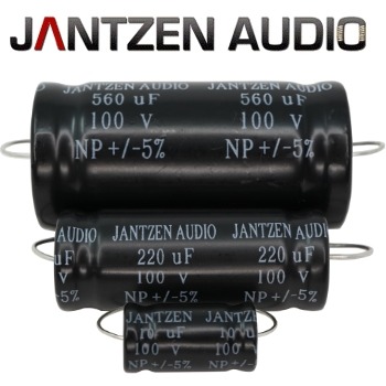

Some electrolytics are nonpolarized, because they contain two polarized capacitors connected
in series, but in opposite directions. Then the applied DC voltage polarity does not matter,
since one of the capacitors is always blocking the applied DC voltage. Sometimes the symbol
and package will have a (+) at both ends, or be marked NP for nonpolar, to emphasize that
either polarity of applied voltage is ok.

Yes, film, nonpolar,or even bipolar can use a symbol like -ll-
Polar will usually be -l(- with a (+) on the left terminal.
Perhaps fixed in that book refers to a fixed polarity (not bipolar)
of electrolytic capacitor, but that is not a common usage.
Terminology and symbols in electronics can indeed vary somewhat
with the individual and country. Usually the BOM list for the circuit will clarify this.

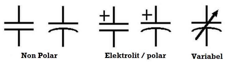

The | ( symbol is an alternative symbol for a capacitor. As Rayma says, the polarity would be indicated thus, +| (
Note that the EU ('new') style and US ('old') style of capacitor symbols differ:
https://passive-components.eu/capac...cuit,th symbol for capacitor is used in japan.

I would love to see a picture of the full page talking "fixed" and "variable" and what is said about them.
The OP description is confused and confusing.
By definition, (or he wouldn´t be asking here), so instead of guessing what he "thinks" they say, I´d much prefer to read original writer´s words.
Don´t think it´s a copyright infringement posting just one page, and for didactic/educational purpose.
Just got a book copy.
To say it lightly, that is a very poorly researched page.
Authors are not "electronics" guys but "Operations Manager - Cybernetics - Software Engineering" , authors on Arduino and Rabsperry programming and such.
I bet they wanted to fill up some pages and copypasted some stuff from OLD books, think 40´s or so (RDH4?), so they refer to componnts the old way and mention some which have not been used since the 30´s, when Radio was king and everyting else Eletronics just a side note.

You can 'look inside' this modern and highly technical book on Amazon.
JMF has hit the nail on the head. 👍
The chart of electronic symbols does not match the style of the book, but appears to have been copied from a much older publication.
Perhaps this apparent sloppiness will be rectified in the 5th edition!
