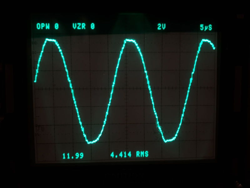

Unfortunately that is all the "effect" but I still haven't been able to eliminate the "cause": oscillation when these amplifiers are connected to an inductive load.
I also tried to be a bit more diligent with grounds: keeping the input and the load isolated (no ground loops) but still the amplifiers want to oscillate. I captured this in the moment before I killed the power and it looks like it is full power, 970 W @ 48kHz:
![Oscillation.jpg](/community/proxy.php?image=http%3A%2F%2Fwww.siddall.name%2Fjeff%2Fcustom_bass_amplifier%2FOscillation.jpg&hash=9612df53f24eeda5aceedcaa43435ee7)
This was captured with the inputs grounded.
I am thinking perhaps increasing C2 to lower the frequency of that low-pass circuit but that seems like a bandaid to what is another issue.
Any other ideas what to try next?
A sustained oscillation requires feedback. There are two types of feedback paths to investigate.
One is direct path through IRS2092 self-oscillation network, like wrong parts. I recommend measuring these parts and posting a schematic. Improper part choice can lead the circuit to oscillate wrongly with anything but a resistive load at HF. The RC damper provides the resistive load at HF. The 100nF on the output damper RC seems a too low value, more usual value is 470nF, as much as LC output capacitor. A usual problem with ceramics is runout of capacitance as voltage approaches maximum, it must be a X7R 50V type at least, capacitance at ~50V can be measured with the help of a power supply, but requires extreme care to not damage capacitance meter, pre-charging the capacitor with a resistor then connecting the meter.
Another is indirect path, as ground loops. 50Khz is too low to be very effectively filtered by a simple input LPF network with low attenuation at 20Khz, -3dB @ 50Khz at best. However, 50Khz happens to be the usual resonant frequency of the LC filter. But there should not be 50Khz current flowing through ground terminals.

I was thinking the same thing about feedback, so last night I started going through the reference design schematic and mapping the component labels, concentrating on the feedback loop. I replaced the actual component numbers in green but when I got to R13 (R7 in the reference design) I found what could be causing my issues:
R13 should have been about 3.1K but was 100 ohm! Since everything else I found lined up with the reference design I would think that was a manufacturing error.
Anyway, I found some 1/4 W axial 3.1K resistors and will try soldering in a couple of those and see what happens.
Regarding the Zobel capacitance, the IR design does use 100 nF so I am guessing they just copied that.

I successfully replaced the incorrect 100 ohm resistor R13 with a 3.1K ohm (mine actually measured 2.95K) 1/4 W axial resistor and everything is working great. The amplifiers no longer oscillate whether connected to a resistive load, inductive load (real speaker) or no load at all.
