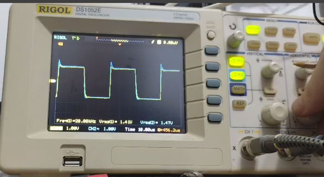

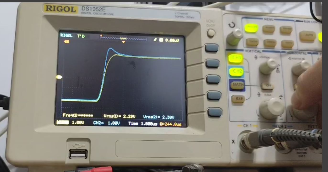

While troubleshooting, I noticed something on the oscilloscope that I had previously overlooked—a high-frequency ringing in the signal. At first, I didn’t think much of it, but it kept nagging at me, so I decided to address it.

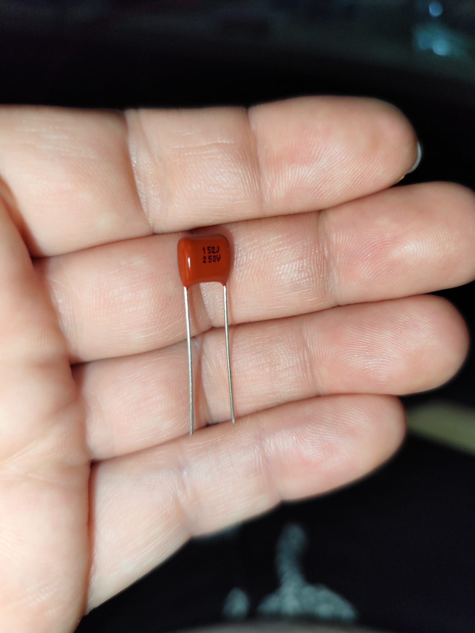

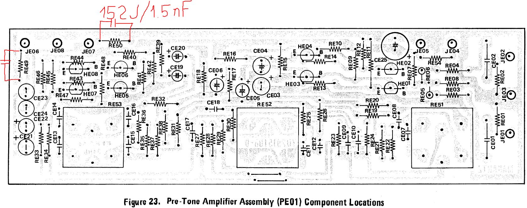

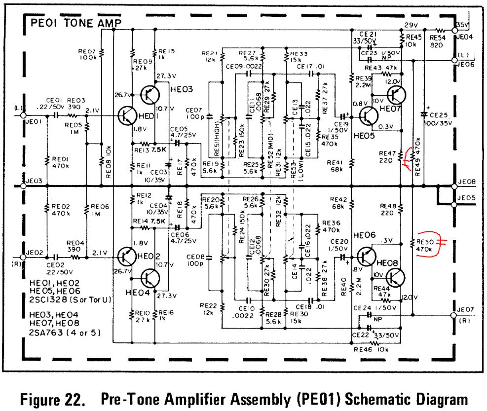

The fix involves adding a pair of 152J (1.5nF) capacitors across the feedback resistors (see the attached picture for the exact placement). This small tweak completely eliminated the high-frequency ringing and brought a new level of clarity and coherence to the mid-high and high-frequency range.

The modification is very simple to perform. Just place the amplifier on its side, remove the bottom plate, and you'll have access to the tone control board to add the capacitors.
